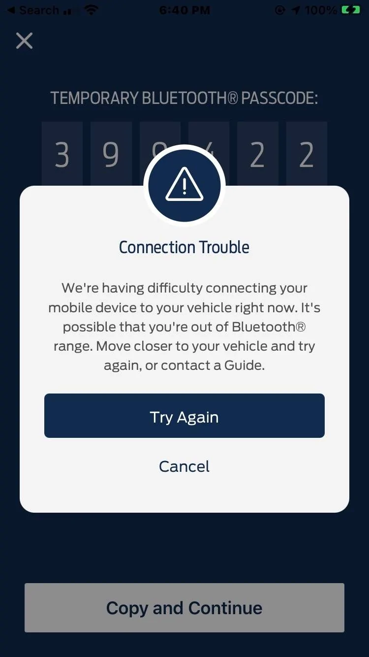

The issue was that it would go through the initial setup, and download a key. However, when it would get to that very LAST step it would always fail. I would get a message like this:
