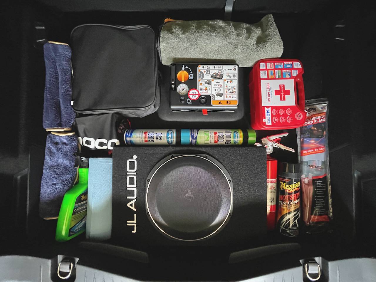

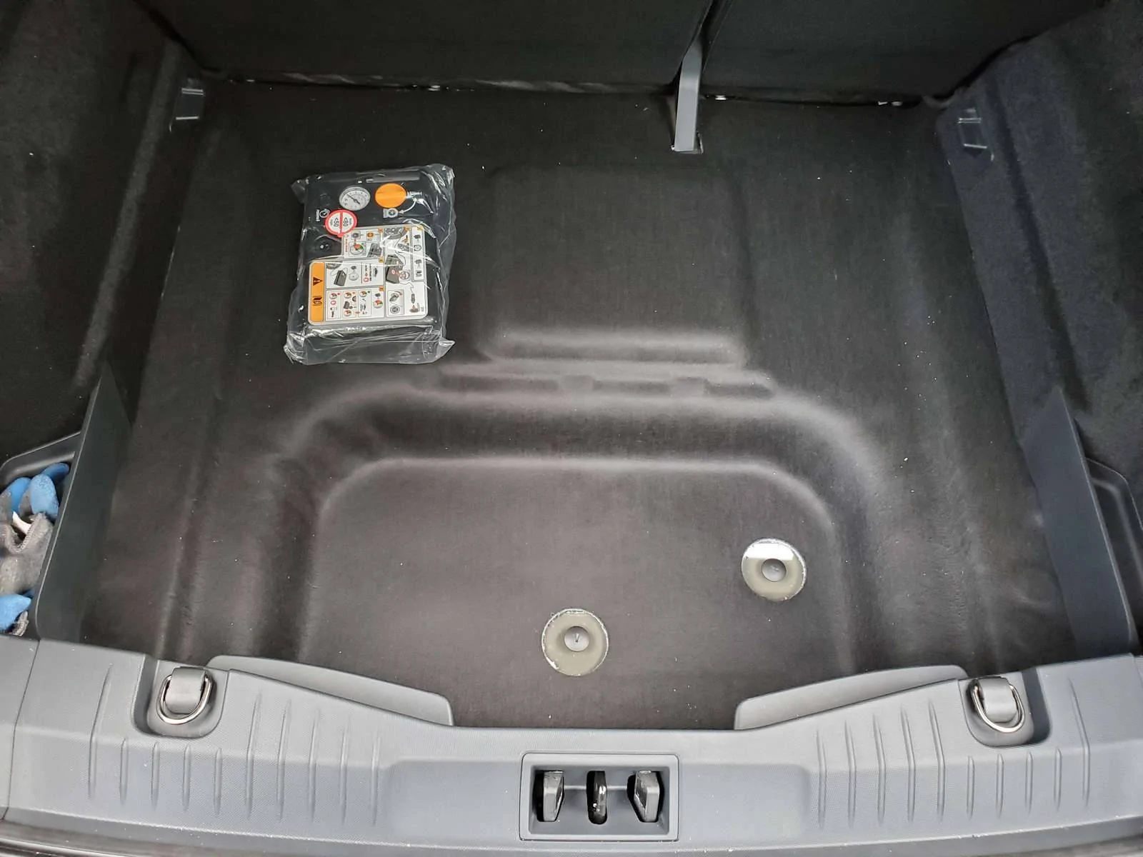

I normally take photos while I am deadening a car but actually took very few of the Mach-E. Kind of done taking photos as I work now. In the first photo below is the cargo area. After removing the hard carpet liner, it was all bare metal. I applied Dynamat on most of the metal areas then on top of it, the Dynaliner foam. I usually apply slightly larger pieces of the foam so that is why you don't really see the Dynamat material because it is underneath. I would normally do this on the floor and roof of the car but it is not necessary on the Mach-E (unless you don't have a glass roof). Did the same thing in the rear quarter panels and all four doors. The second photo shows the full hard plastic window regulator that does a decent job of sealing out noise from the outer door skin. I still took it off and lined the entire inner side of the outer door skin.
