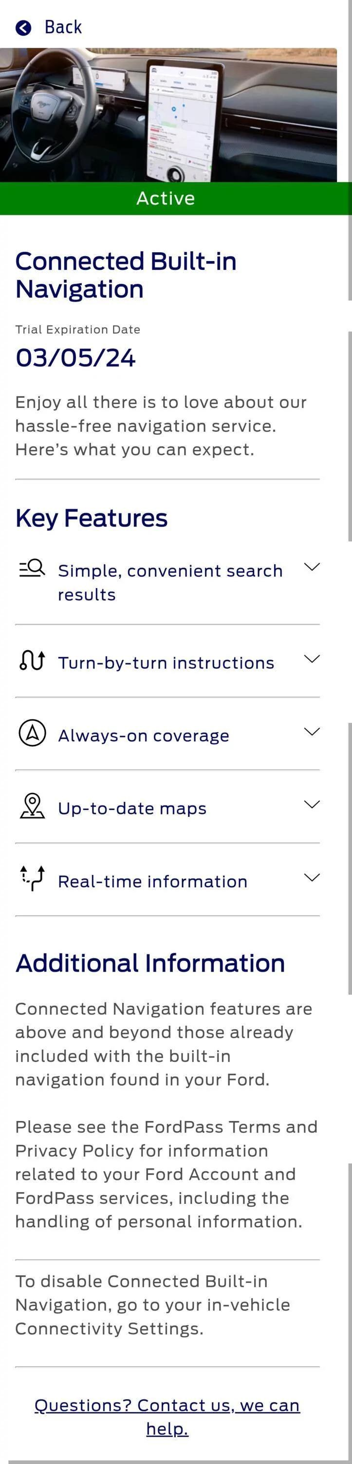

When I request weather the Weather popup appears but the content area is a spinner for 10 seconds and then it says Forecast Unavailable. As for traffic, it just never shows any traffic on any roads so the route planning doesn't consider traffic conditions, either.
Obviously I can use Android Auto instead but this is frustrating and makes me wonder if other things may be borked that I'm not yet noticing.
Any suggestions?
I tried resetting certain things such as FordPass Connect, Connected Navigation, and so on. I haven't tried a full master reset since this may impact my subscriptions.
