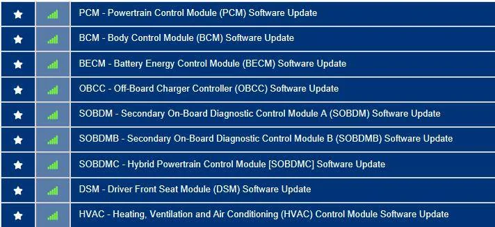

Strange to have gotten the 22S41 recall as an OTA but still have a SOBDM update still showing up in the list:
Mike,FDRS shows the build date as the 25th of May '22.
You still have recall-related modules that have updates available (PCM, BECM, SOBDMB, SOBDMC).
The OBCC update is related to DCFC errors some are having.
The DSM concerns driver's seat and mirror settings not adjusting to the profile setting for the key fob being used.
The HVAC update is for not enough heat in freezing temps or other HVAC concerns with settings not being retained.

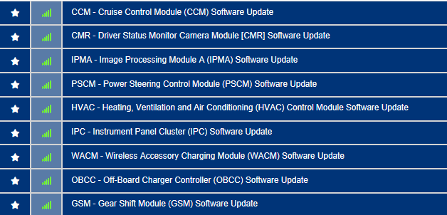

Your 22S41 procedure was performed yesterday morning and they were finished by 0930.
Here's the list of available updates:
They said they called ford, and ford said if there are no problems then don't update it ,because they wouldn't pay for it(technically build date is not part of the recall). So I guess I will be getting the equipment and updating it myself.Sure....but it's a bit confusing as to why they wouldn't do the recall related updates. I'm sure there must be more to this story.
This list would not even take them 30 minutes. I just did a check of another car and from start to finish and it was 26 minutes total and that car had the SOBDM as well.
