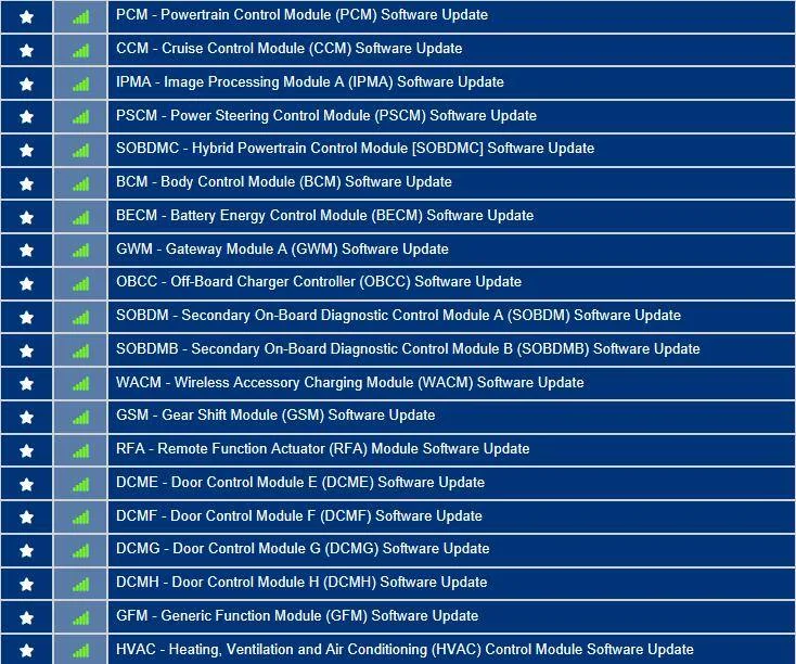

Here's the list of available updates, and no it doesn't look like any programming has gone on yet:
Every day they don't program...more stuff gets released. I did another GWM module update just this morning.

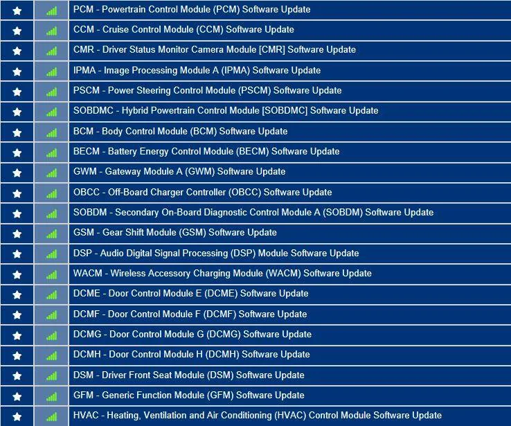

This is what they came up with when I picked it up. May you check if they cleared or updated anything else.
Nope. Everything is still there, including all the door modules...all that CSP 21P22 stuff.
No programming of any sort took place.

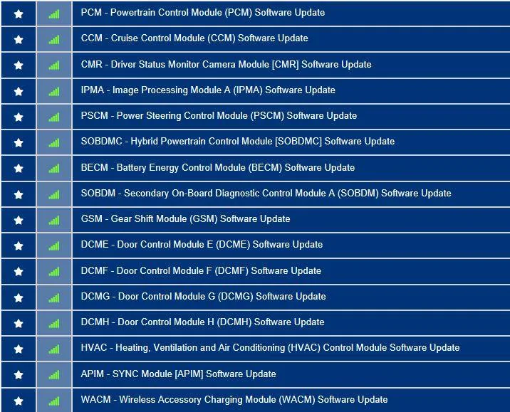

13 Jun '21 build date, Job 1 car.
It looks like they did the 22S41 recall and the CSP 21P22 on the 8th of Sep.
Most of those same modules have received another update though..... so you're kindof back where you started:
You do have an APIM (Sync module) update in the list and your tech may need to update that one if you're not getting OTAs. They should be able to check their "OTA Dashboard" for your car and tell you what the story is. They can see all your trouble codes in 'real time'. Your car is talking to the cloud everytime you drive it.

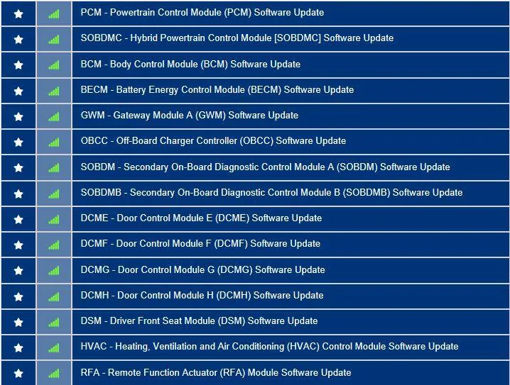

27 Jan '22 build date
Here's the list of available updates:
The 22S41 recall-related modules are the PCM, BECM, SOBDM, SOBDMB and SOBDMC. Once the tech selects the PCM they will all chain in sequence automatically.
They might do the OBCC at the same time since I think that's in the instructions to do that if it's available, but you'd have to ask them.
The HVAC update is for folks who are not getting enough heat, or their windscreen fogs up a bit sometimes when driving.
The RFA is updated if you have a concern about your phone bluetooth losing it's connection with the car sometimes, or if PAAK is not connecting or drops connections.
The DSM is updated if your driver's seat and mirrors sometimes do not adjust correctly for the key fob (or PAAK) profile you are using. Example, wife drives car with her fob, but the seat and mirrors adjust to settings for your fob instead.
The door modules just showed up for all of us this morning (all '21 and '22 cars). No idea what those updates are intended to correct.

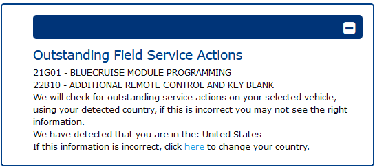

12 Nov '20 build date, early Job 1 car
CSP 21P22 was done on 27 June '22.
You are eligible to get BlueCruise programmed by your dealer service dept if it's not already working, and also the extra key fob if you don't already have two of them.
Here's the list of available updates for your car:
