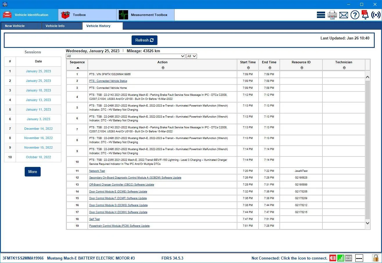

Here's the list of available updates:@Mike G any chance you can check mine. I got 4.1.2 and the no change on the screen. 3FMTK3R75NMA19684
On the F-150 VIN lookup forum (I'm there as well) there have been a rash of members who are asking about what is supposed to be an APIM update for F-150 that allows fullscreen Carplay. So there's a member who works for a dealership and he giving them the OTA status (which I can't see) and I'm providing the FDRS software updates. So on some of these the forum member is getting notification in FP that they've gotten a PowerUp but aren't seeing any changes. So the OTA lookup shows that the download started but didn't download all the files, and when I look up the updates...there's the APIM still in the list.
I think that's your situation...it's happening a bunch over on the F-150 site. Here's an example.
I don't think that APIM update completely downloaded.
