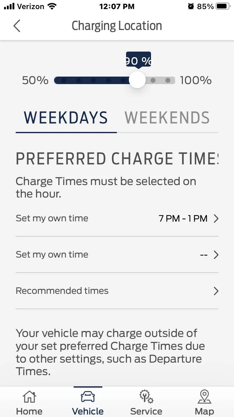

Hi All,
I have preferred charge times set on the FordPass app in order to take advantage of rebates from my utility provider. However, the FordPass app ignores these settings — "vehicle may charge outside of your preferred times due to other settings such as departure times..." Does anyone know how to prevent the app from ignoring set times? I don't use departure times and have "Use preferred charge settings" enabled. thanks!

The only other issue I have read is when you plug in and the car believes it can not reach your programmed charge level within the preferred charge window, in that case it will charge outside the preferred window. Normally a potential L1 charging issue or a narrow L2 window.

This seems to happen because of the speed of your charger. If the vehicle determines that your state of charge is low enough that your charge rate in the parked location cannot attain your target by the end of your charge window, then it will start early and go late. For me this was an issue for a short time after I first got the car and used the level 1 portable charger that came with it. Once I had the level 2 installed it was no longer an issue.
