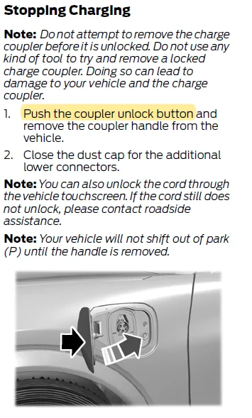

This is from the DC Charging section of the owners manual:

Actually I think the manual specifies to press that button BEFORE removing the plug. Page 162 specifically says to press the button when stopping ac charging

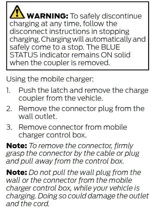

It has similar wording to the above for stopping AC charging, it's page 162

Actually No.
Step 1 above is talking about the release latch on the J1772 connector. That little thumb lever. NOT the button in the center of the charge ring. The illuminated button is only needed for DC Fast Charging.....and even then it's only necessary if the car doesn't unlock that pin automatically once your charging session has stopped.
Two different buttons.

No, that’s referring to the latch, not the button. The latch is the thumb release on top of the plug.
