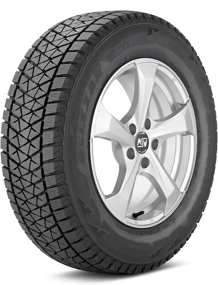

Something like a 235/55/R19 would probably fit on stock 19" rims, and likely clear the wheel wells (no promises), add 0.4" of ride height (takes you to 6.1"), and includes some properly load rated options like the Blizzak DM-V2 (https://www.tirerack.com/tires/tire...R9DMV2XL&vehicleSearch=false&fromCompare1=yes).

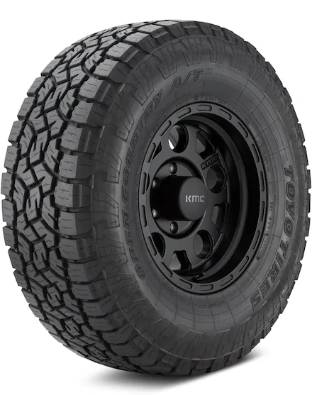

Going one step further... 235/65/R18 would require changing wheels, but gets you 0.62", and opens up some sweet tires like this Toyo Open Country (correct load rating!):
https://www.tirerack.com/tires/tires.jsp?tireMake=Toyo&tireModel=Open+Country+A/T+III&partnum=365TR8OCAT3XL&vehicleSearch=false&fromCompare1=yes
This would almost certainly require minor modifications to the car - fender wall clearance is likely to be an issue, and possibly fender lip. A suspension lift would help clear it, but wouldn't guarantee that you'd never touch, because under full compression your axle is right back where it would have been on stock full compression. But fun to think about!
