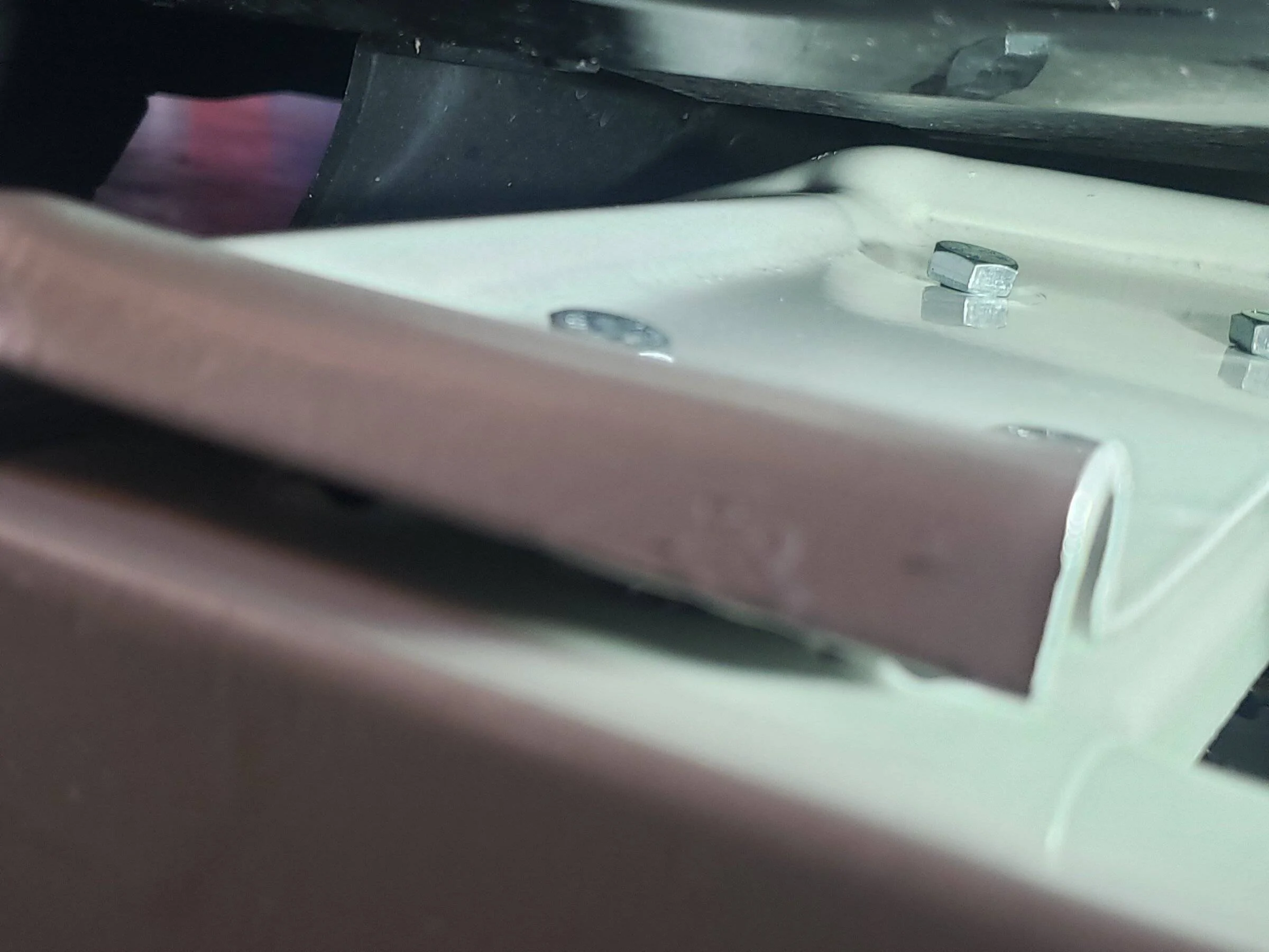

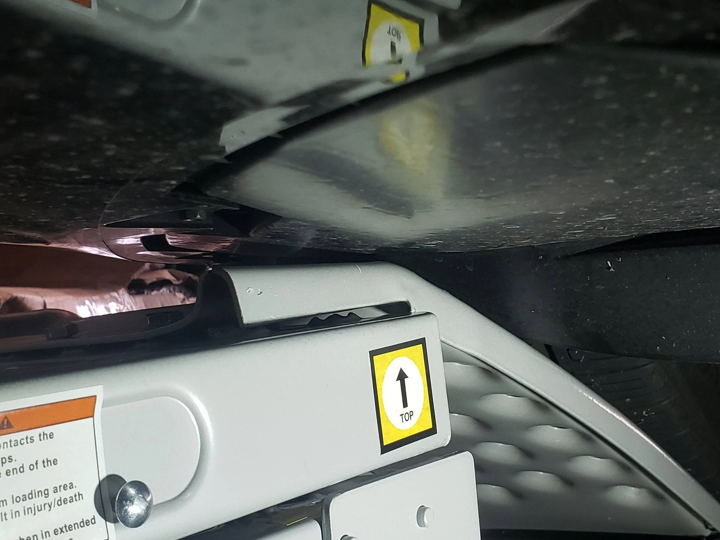

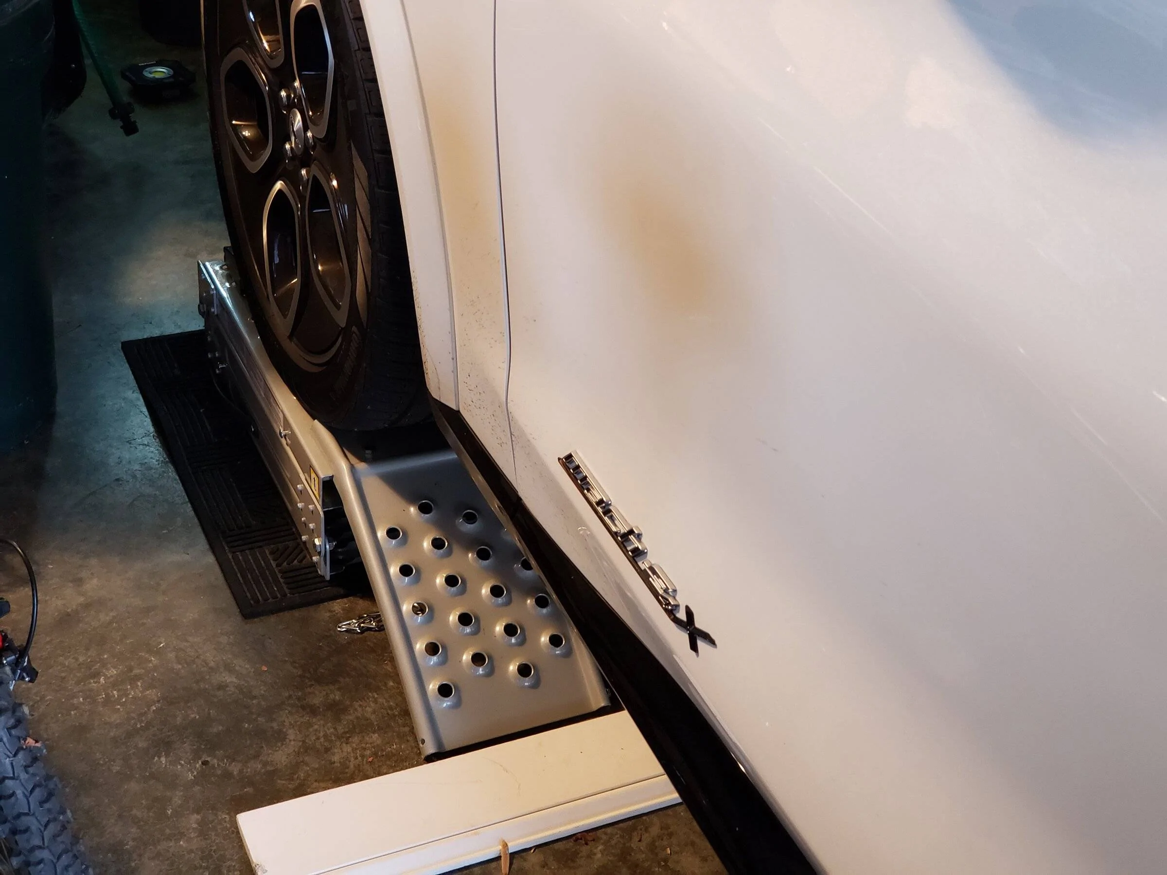

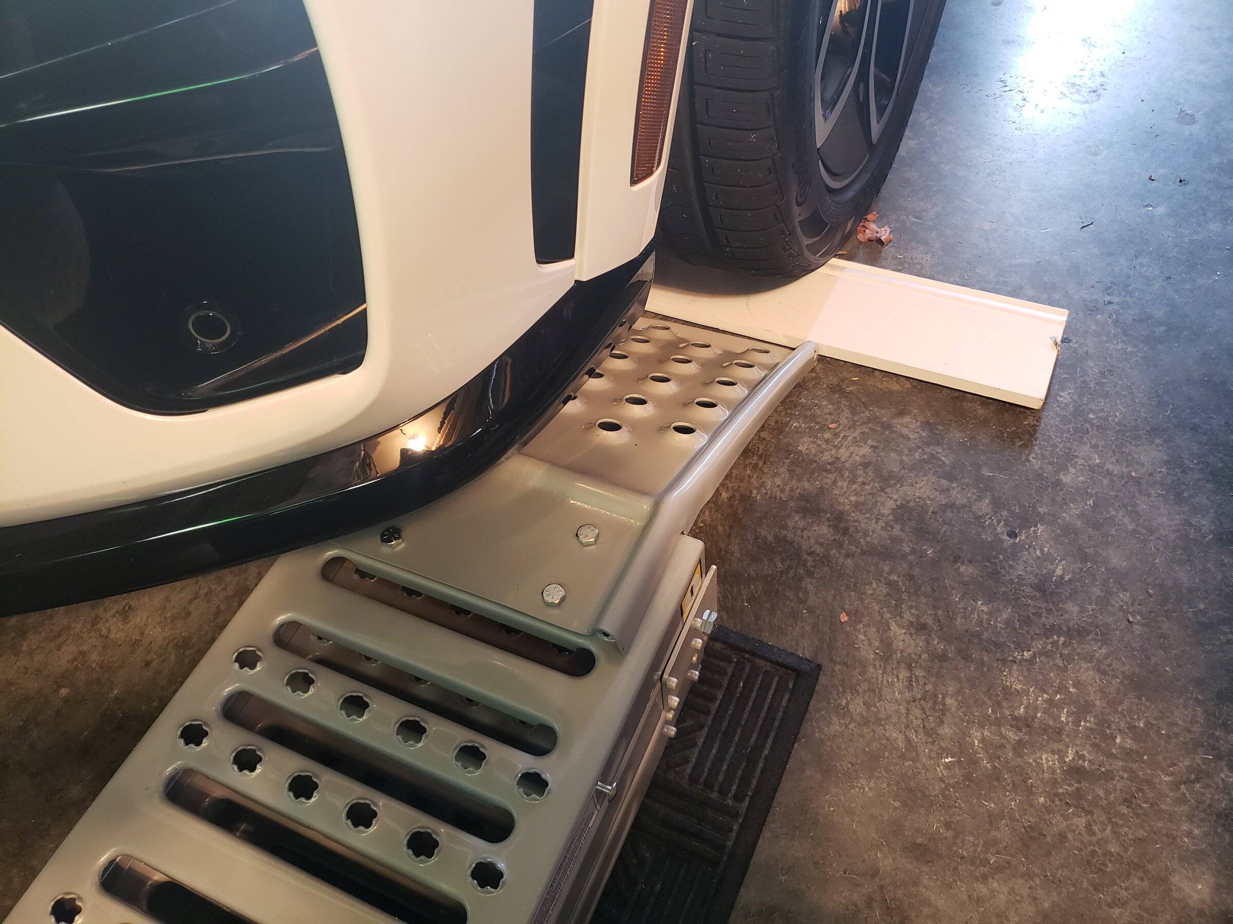

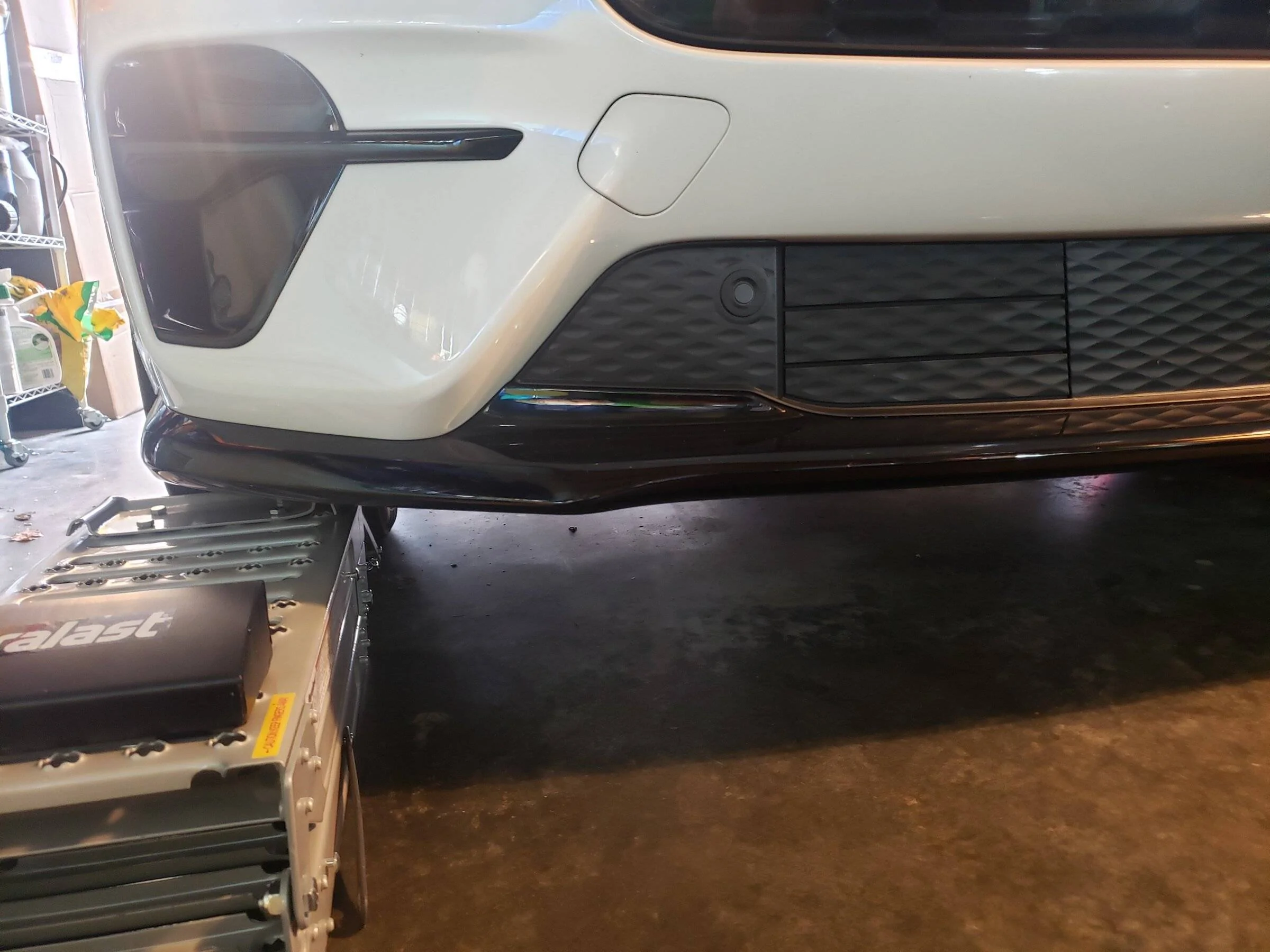

I put the ramps at the tires and could tell the clearance is very, very small. Too small for my comfort. Also I wanted to put the ramps on rubber mats to keep them from sliding, which basically eliminates all of the clearance. So I used a piece of baseboard moulding that is around 1/2" thick to improve the clearance.
I went on and off the ramps without scaping. I really like the length of the flat surface because I am very worried about overshooting the end of the ramps. Luckily that didn't happen and I was able to change the oil and filter easily!
