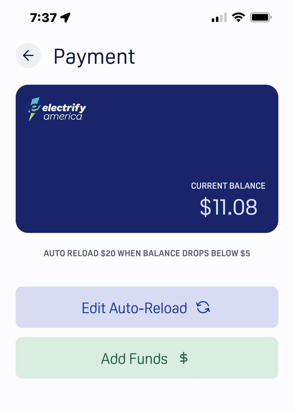

Agreed - last weekend, EA had updated their software (finally) and I could not plug and charge anymore at 2 different EA stations.
When I called customer service, they said that plug & charge does not work for any brand other than VW.
They told me to open the EA app, select the charger, swipe to initiate charge, then plug in.
I got charged from my EA digital wallet app.
I had thought you'd asked on this forum about this.
If you want to use the Ford BlueOval charging network, then you shouldn't be using the EA app. If you used the EA app, you should not be surprised to being charged by EA.
As to Plug and Charge not working for any brand other than VW, that is erroneous information provided by a poorly trained representative.
