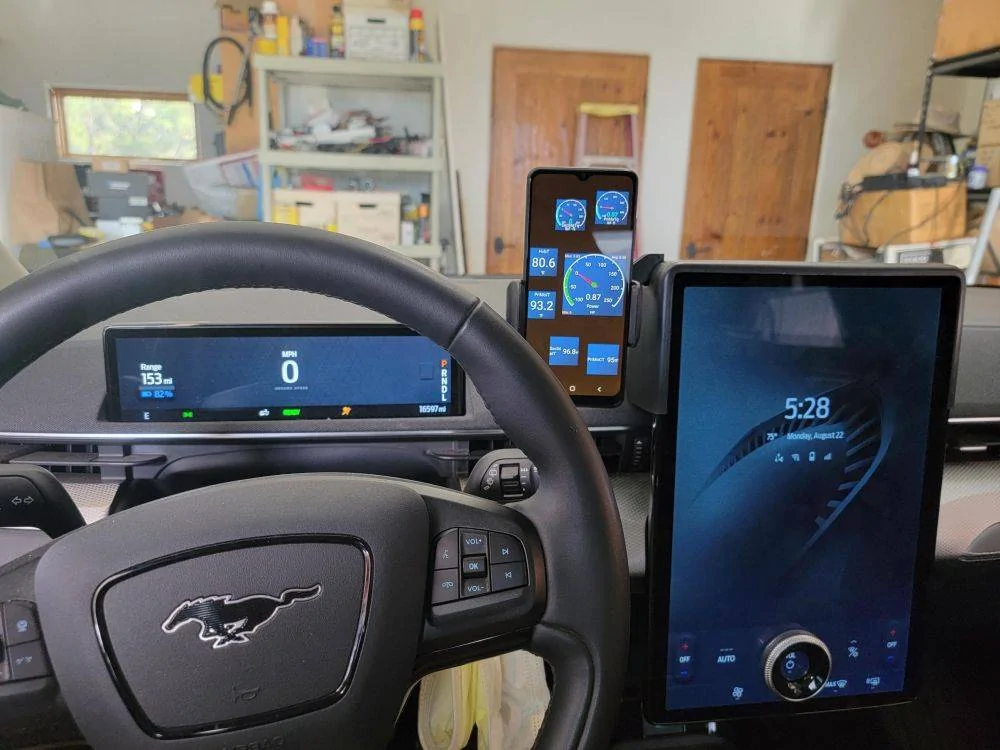

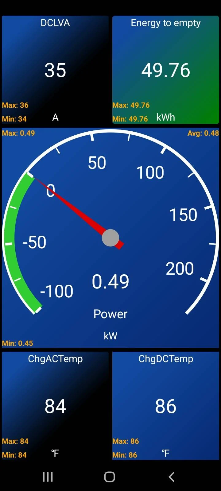

There Is no option for that on MME yet. But you can archive that using the Car Scanner app and a ELM327 (viewer) BT adapter. I would not recommend for day by day use, but good to have an idea of power consumption and regeneration.
