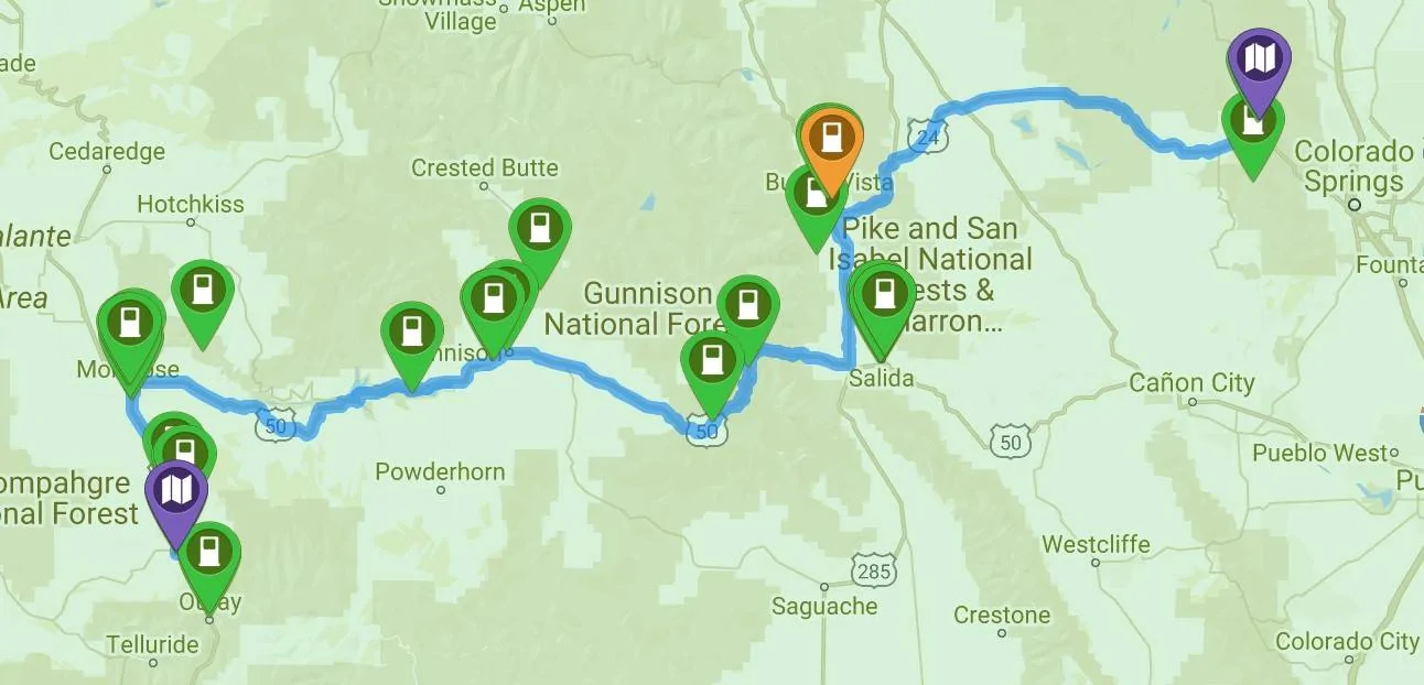

Yeah plugshare has that 50kW charger as well:
In addition to a bunch of Level-2's. Especially close to Ridgeway.
Those give you some backup: If you're approaching Ridgeway and find you're 30 or so miles short an hour or more on a Level-2 might get you the kick needed to get there.
I would suspect going the other way is more downhill given that Colorado Springs is down out of the mountains. That may make it easier.

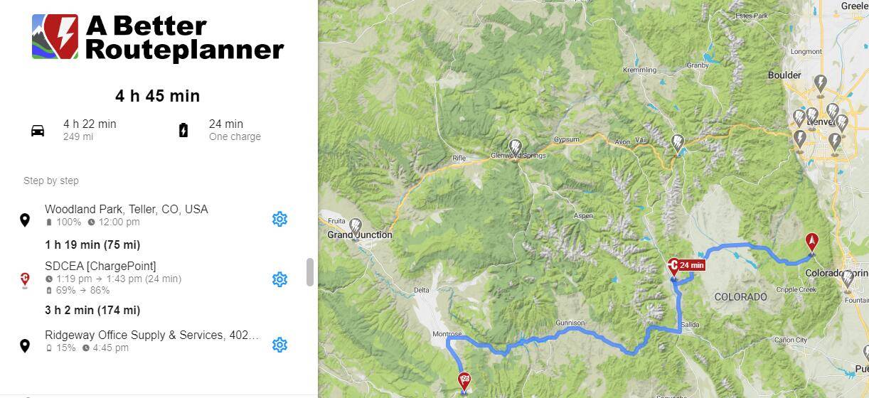

Hey look at that Plugshare says 4 hours and 28 minutes (without adding charge time) and the above route in a Better Route Planner is showing 4:45 with a 24 minute charge there (seems like ABRP also has that Level 3).

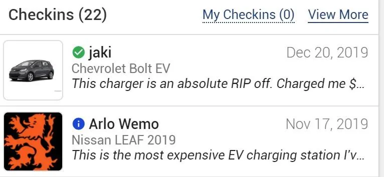

But Plugshare also mentions this:
LOL! I guess when there is no competition....
