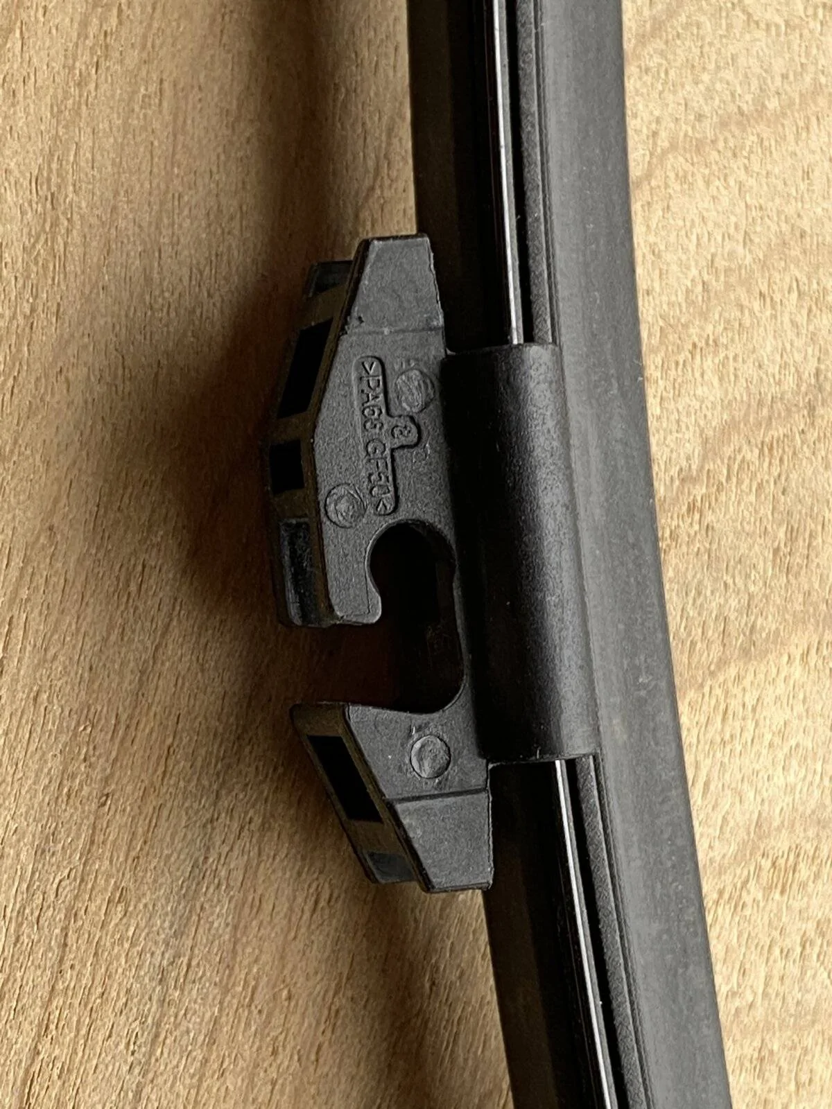

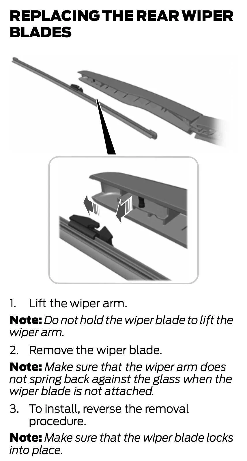

I would like a longer blade too, to clear more of the top part of the window, as the OP notes.
Pull gently outward away from the center mounting post until the "click" (parallel to window), then pull down away from the arm. So, slide to click, then drop away, which might be a second click.
When I just put it back, I kind of got two snaps, first when I pushed it back up over the post (use a flashlight), and second, when I pushed it back towards the post to re-install.
Some Explorer rear blades were just the one down (away) slot click (without the MME first slide parallel to the window to the first click) which may be why some are breaking. Just pushing down, away, like the old Explorer snap lock, would break the plastic over the MME wiper slot and/or the pin and plastic of the arm.
