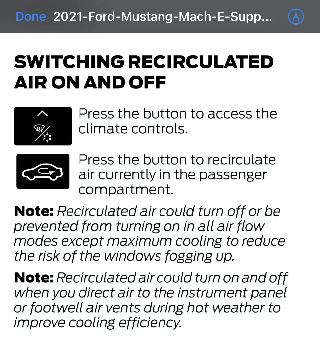

If you read the manual it explicitly says that recirculating will not be turned off in Max AC
prdude
Feb 15, 2021
178
122
pleasant ridge, MI
Space White w/Gray MME Prem ER RWD, 01 Miata
engineer
the MME's software is definitely going to use recirc as much as possible, since it reduces a/c load and thus power consumption by the a/c compressor
