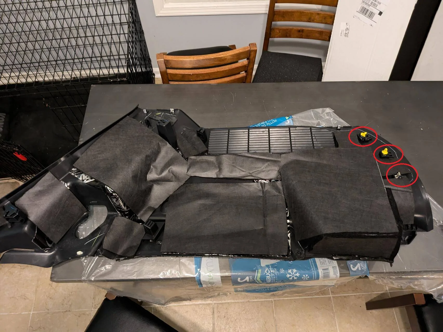

  4. Ford Mustang Mach-E Removing trunk passenger side panel 1741448844858-zt
  5. You can probably get to it now, but if not you would need to remove the upper portion of the rear seat. There is a cover near the seatbelt, take this cover off and then lift up on the seat. Be careful not to lose the foam washer thing.
  6. Ford Mustang Mach-E Removing trunk passenger side panel 1741448935308-eq
  7. Gently pry around the other side of this panel to unpop the clips holding it in place.
