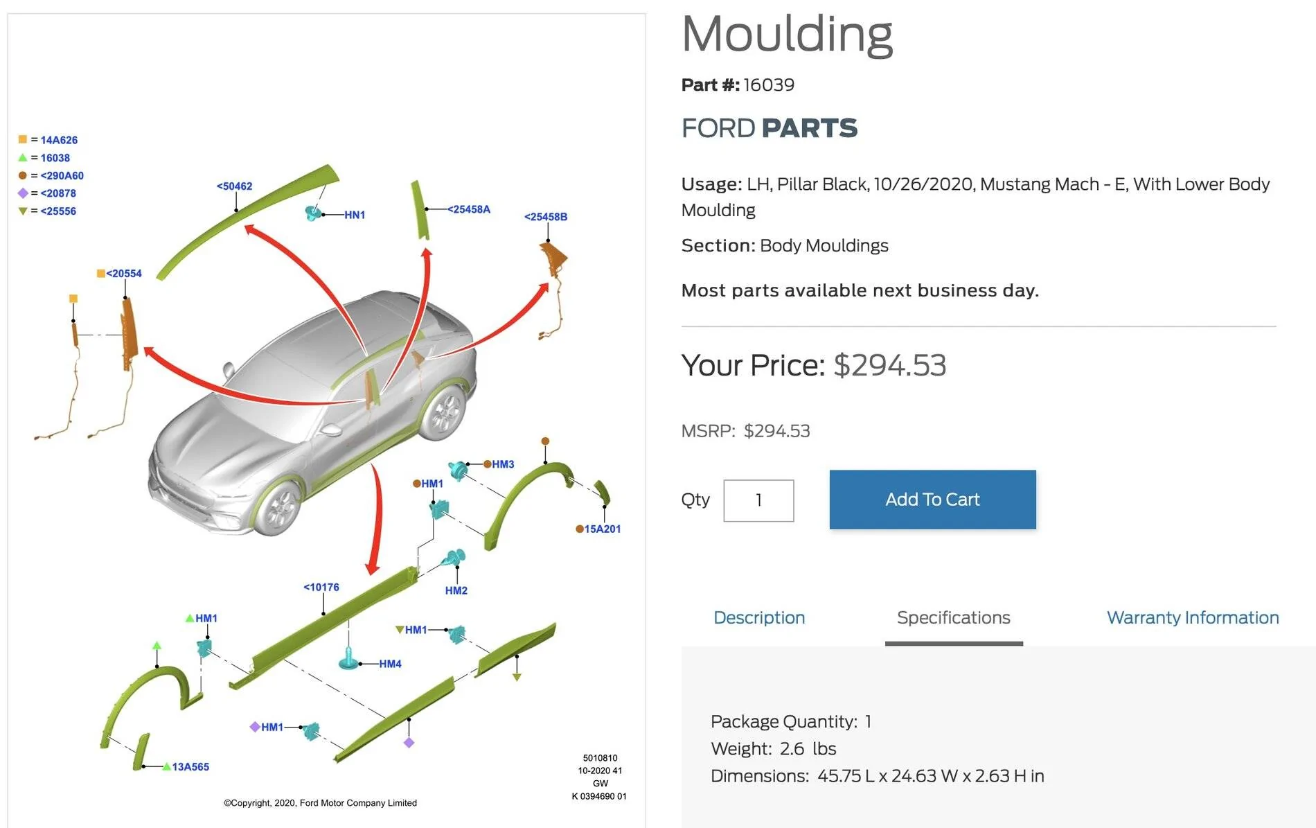

I really want to do mine, but I shudder to think of the cost. I’m really not a fan myself. Honestly might just be easier to buy the replacement parts in the original silver and all, I assume they’re plastic and replaceable

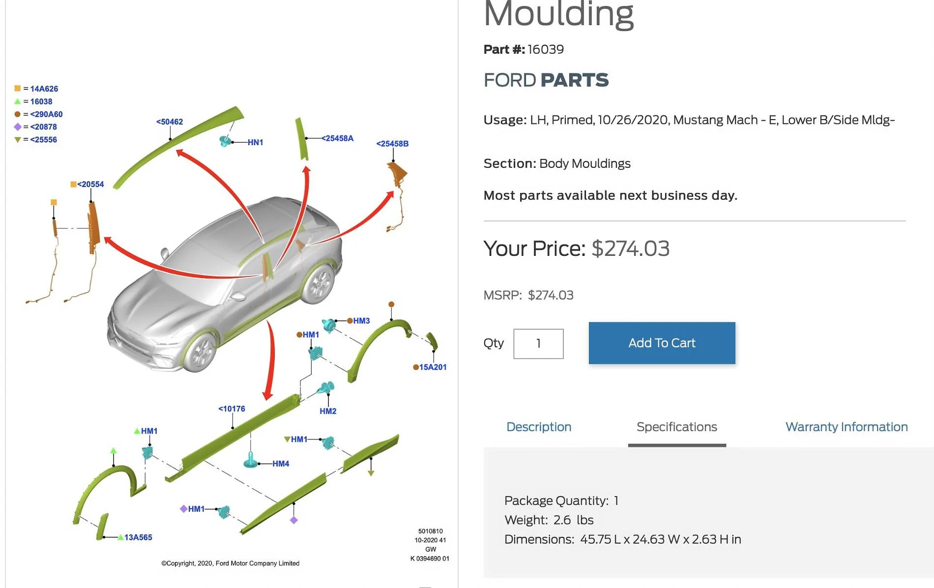

Those fender moldings are not available painted any body colors. You can order them from Ford only in black or primed ready to be painted. Painting the gloss black ones on the car is a much cheaper way to go as those moldings are very expensive then you have to have them painted.
Are you sure? What happens when a first edition or a GT needs a replacement? Those are all body color
I am sure they have to be painted. I have a F150 King Ranch with tan wheel lip moldings, it came primed when I had to replace one. Same with my Escape which had silver moldings. Both vehicles where body colored moldings. If Ford had to stock every molding in every color can you imagine the inventory they would need?

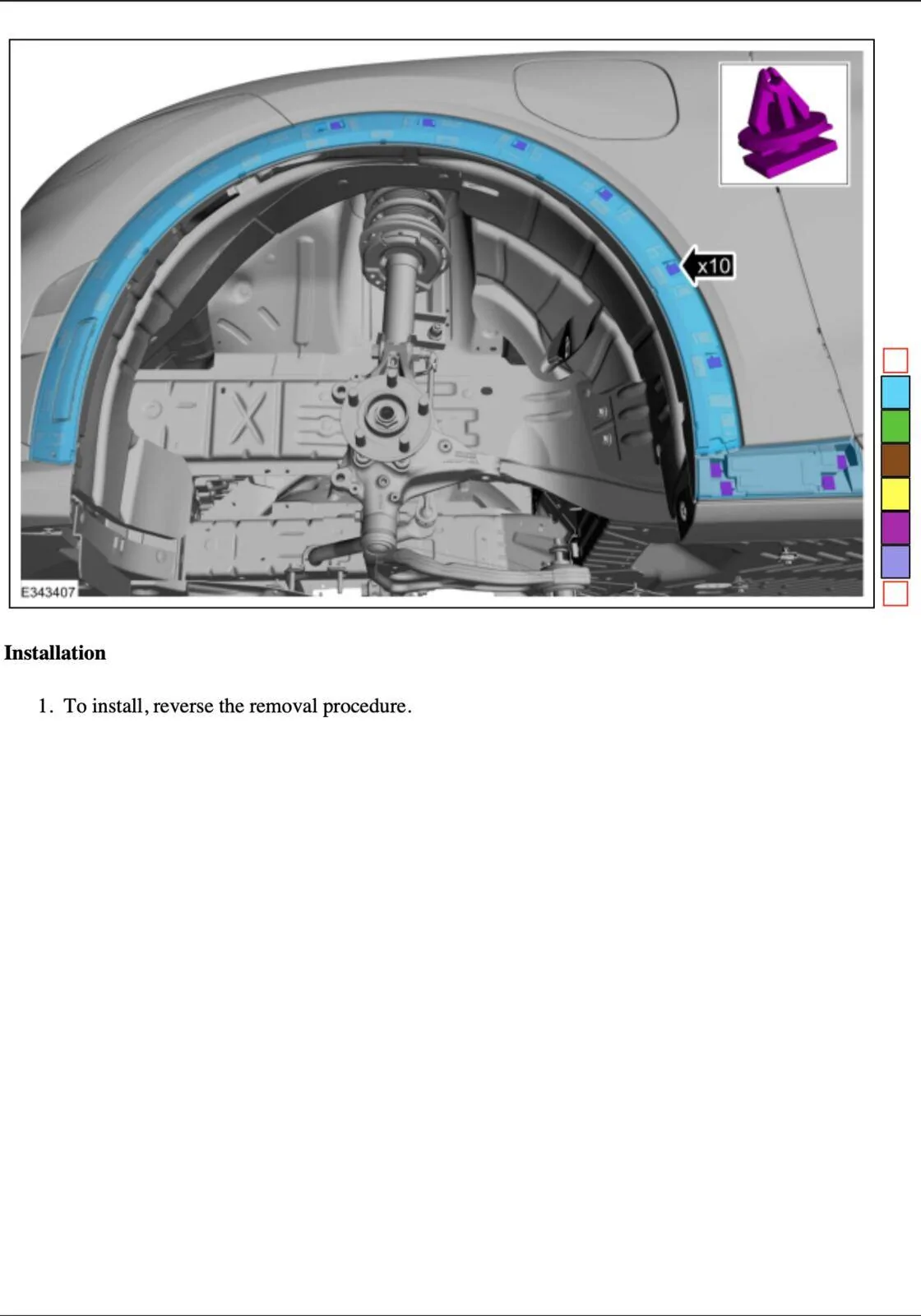

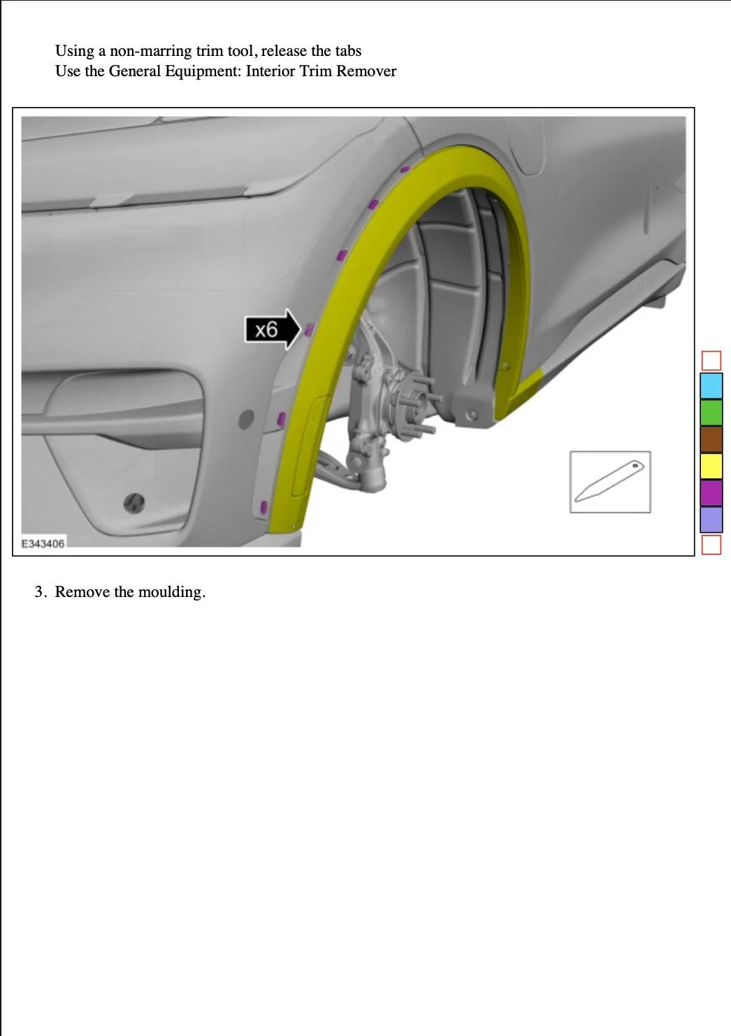

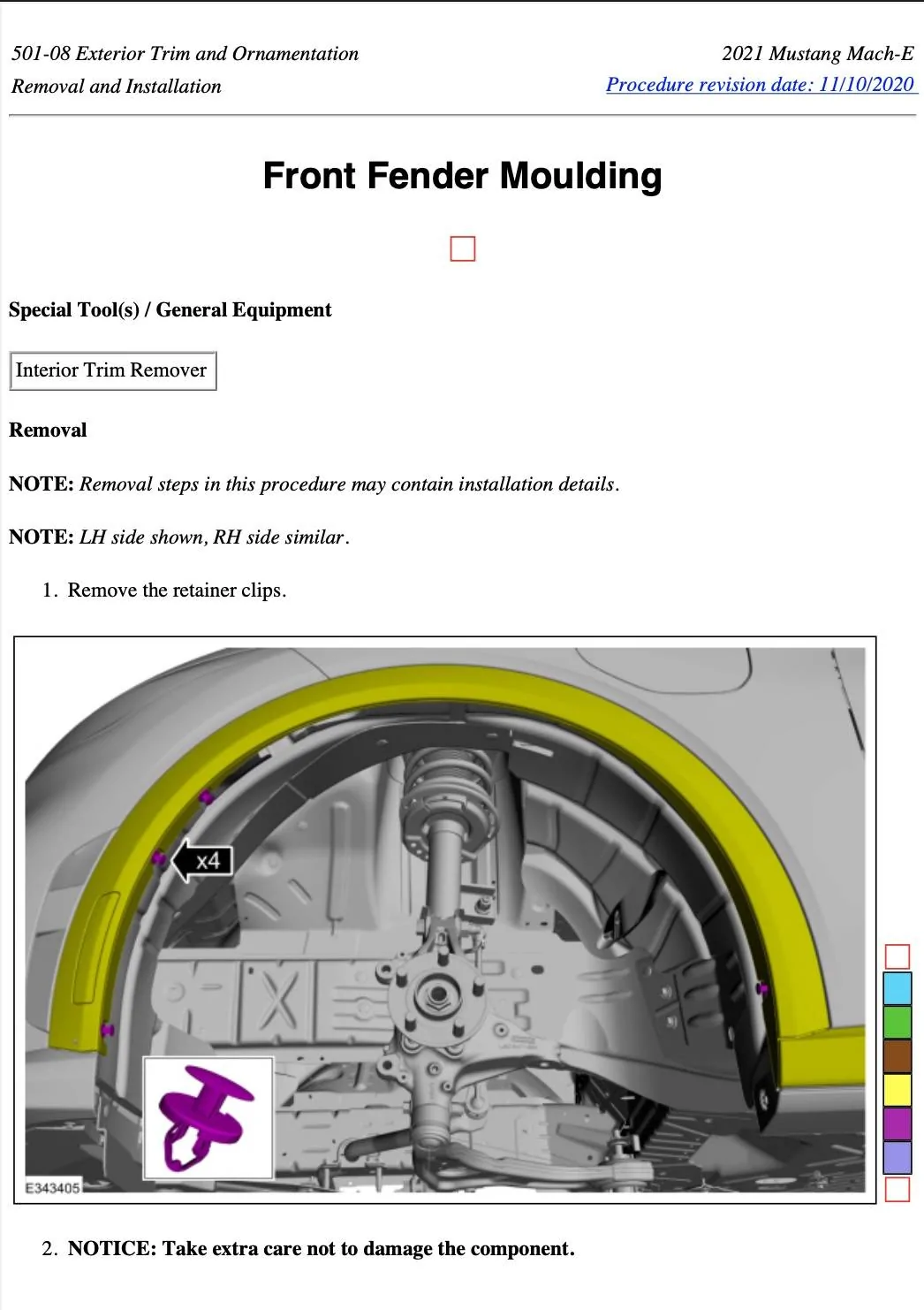

Below is from Ford Parts catalog. First photo I used a VIN from a Premium and it shows being a black molding, second photo used a VIN from a FE and it shows being primed. I said they are expensive but these are retail prices and can be had for a lot cheaper on other parts sites.
