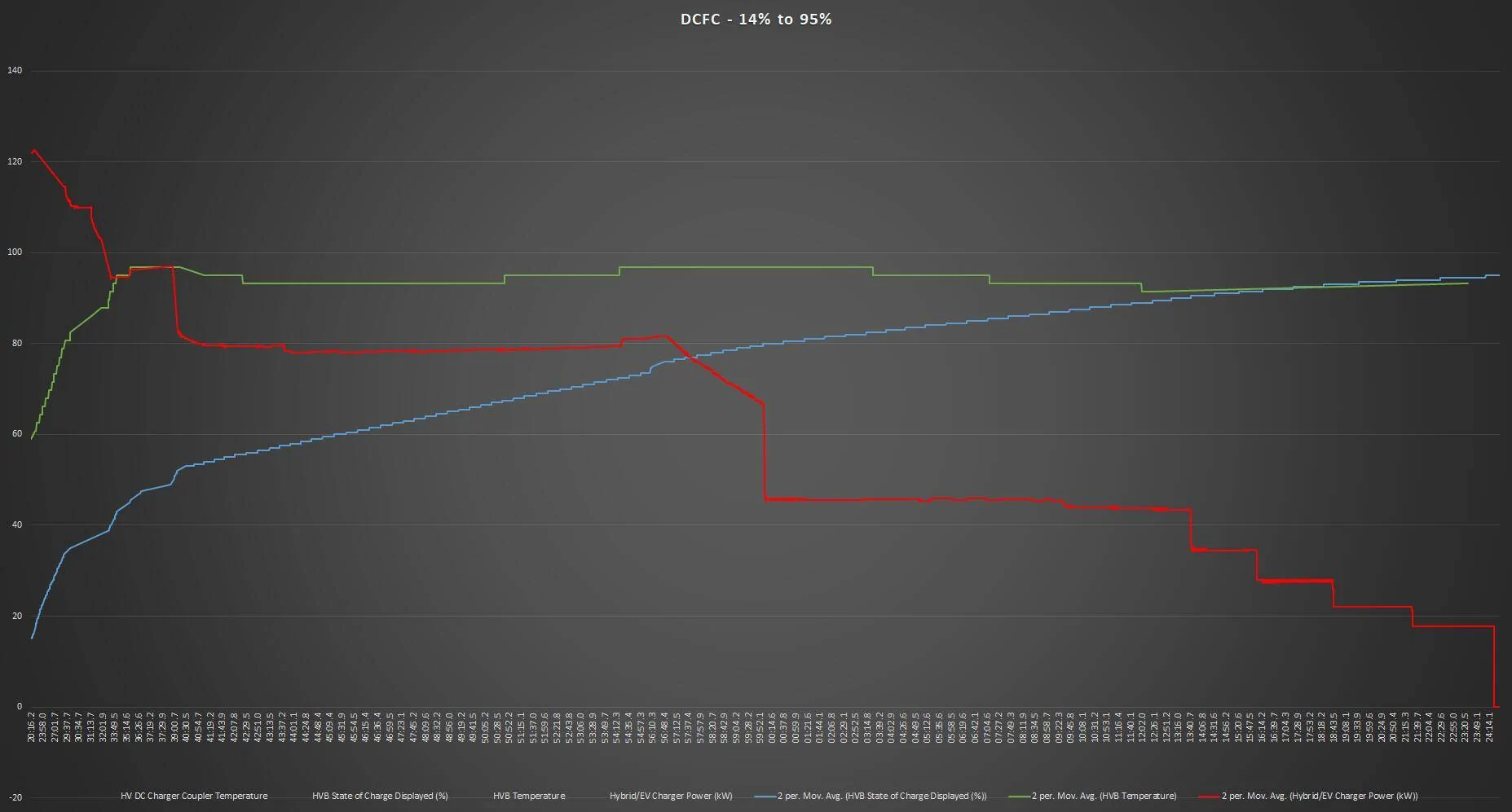

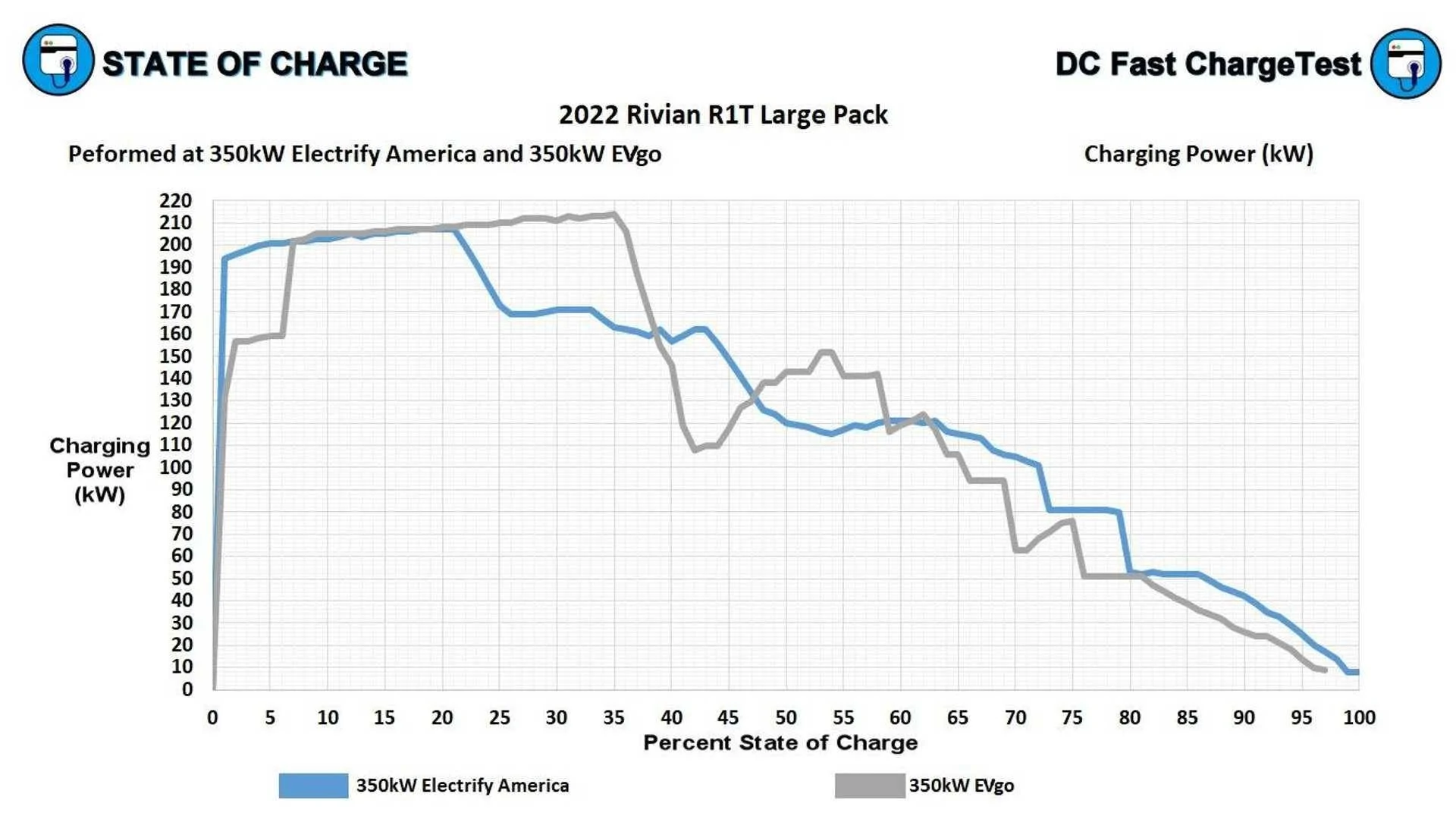

it won't charge faster than a Mach-E
That is not true. The R1T, for example, will start out at 220kW and will normally slow to about 110kW after about 20-30% is delivered. The MME peaks at about 160kW (if you're extremely lucky on a perfect day) and slows within 3 minutes to 80-100kW. They used to have a yo-yo effect on charging due to derating but that appears to have been solved with an update. It's still not perfect but either way, it charges faster than the MachE.
Here's a video from yesterday showing the charging of an R1T in cold Colorado, no less:
And here's a charge curve of the R1T:
Ford Mustang Mach-E Rivian observation 1681771352494
vs the MME Charge Curve:
Ford Mustang Mach-E Rivian observation 1681771436260

My comment may have been ambiguous, but I meant the Mach-E will charge [to 80%] faster.
1. So an update yesterday(?) might have kind-of fixed the Rivian yo-yo'ing? Seems like there are still all sorts of thermal issues.
2. Mach E with an ER pack doesn't dip below 100kw until 55% in my experience.
3. A Mach-E at 80kw is going to finish charging faster than a Rivian at 110kw.
4. Tom Moloughney has (had) both a Rivian and a Lightning. He says the Lightning will beat the Rivian charging every time. F150 Lightning ER pack does 15-80% in 41 minutes per Ford. Mach-E does 10-80% in 45 minutes per Ford. They reach 80% in about the same time.

Ok well yeah, I didn't assume you would be comparing it based on percentages, that makes little sense to do. A garden hose will obviously fill a bath tub quicker than a pool. kW delivered is much more than the MME which is really what matters. The R1T can pull down more power than the MME or the F150 in the same amount of time. Being that it has a bigger pack it will possibly take longer, but you can go further. 80% of charge is 100 miles more for the R1T based on EPA and they actually have accurate numbers unlike Ford.
Many of us have documented the charge curve for the MME in numerous places on this forum and I've never seen it sustain 100+ kW for 55%. The charge curve that we currently have is well discussed, plotted and tested here: https://www.macheforum.com/site/thr...-charge-curve-and-maybe-power-delivery.13747/
