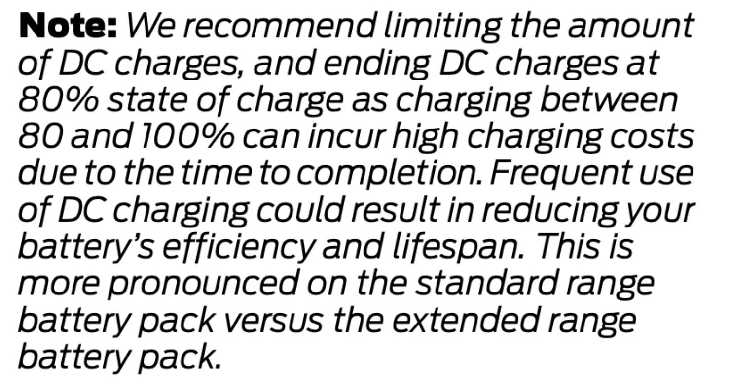

Since you asked the question, I remembered seeing this note in the MME manual FWIW. A trip two times a year might be less of an issue:

Oops, have not read this earlier, the ER charges with max 150(160 seen) and the SR charges with max 115 (not yet seen) Still degradation is worse for the SR battery???

... Still degradation is worse for the SR battery??? ..
Anyone know why? The smaller battery is not just less of the same type cells?
Because there are fewer cells. If the cells in the SR and ER degrade the same amount, the overall percentage of degradation will be higher for the smaller battery. For example, if degradation kills 10kWh of usable capacity, that’s 14% or a SR battery but only 11% of an ER battery. It’s the same amount of degradation, but more pronounced for the SR.
No. It's not degradation. The extra cells in the ER battery are wired in parallel so the current being pulled can be higher. Has nothing to do with degradation.
Yes, it is. As I mentioned it has nothing to do with degradation.
Each cell degrades a certain percentage with constant DCFC regardless of how many there are. It is not a function of a fixed amount of kwh degradation

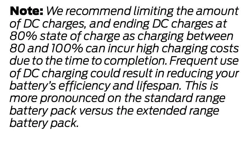

Can you explain this warning? Specially the last sentence
That warning is for apartment dwellers who don't have consistent access to L2 charging. If you rely on DC charging all the time you have to charge more frequently: the ER will have to be charged 1/3 less often. It's not a case of wiring but number of charge cycles.
Road tripping 15 or 20 times a year is fine regardless of battery size
