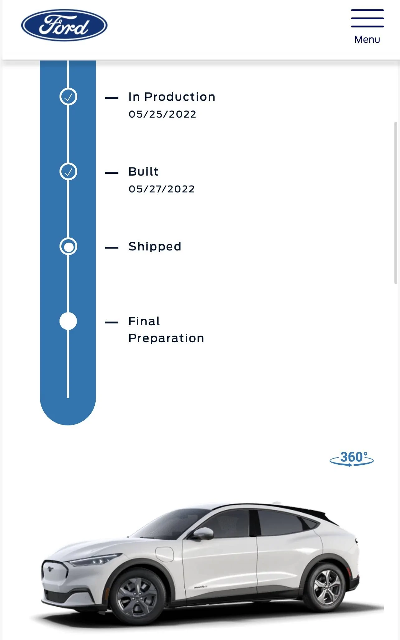

So, this means I’m theoretically in the clear, right?
I haven’t even taken delivery yet and a delay to Q3 would be very frustrating!
If it was built 5/27 like your picture shows then according to the notice yes you would be ok to take delivery. Ask your salesman to be 100% sure.
