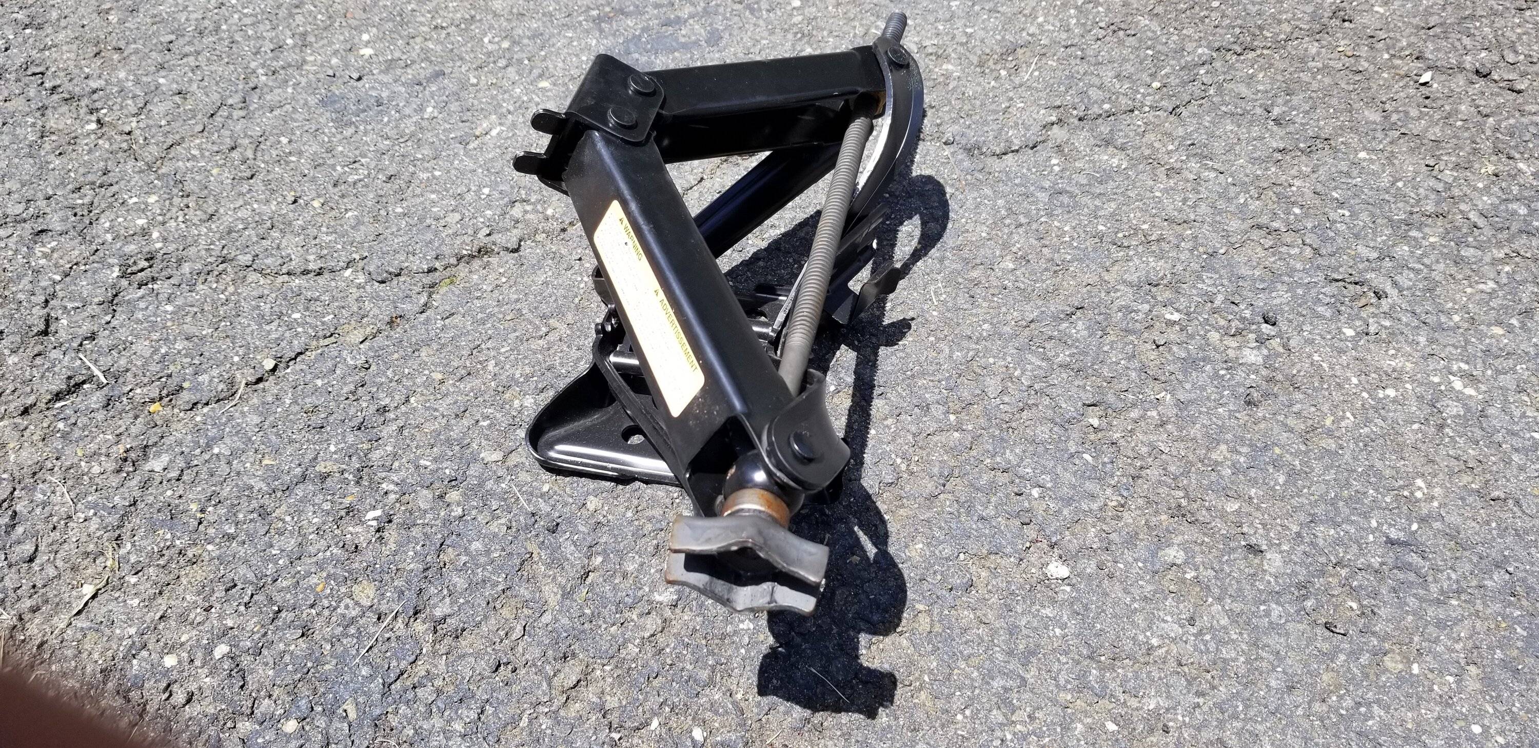

I've heard bad things about the Modern Spare jack and basically all of the other chinese scissor jacks, so I'm investigating alternative options. The Tesla forum loves the used aluminum Porsche jacks (https://www.ebay.com/itm/134160597691 for example). However, they only have a 2200 lb weight rating. Nobody seems to have a problem with them on the Model 3 but that car is quite a bit lighter than ours. Any idea how much weight goes on the jack to jack up one corner of the MME? Would it actually approach 2200 lb?
