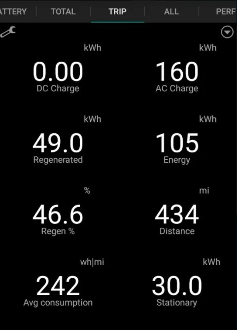

Below is a screen shot from my SMT app (pulled from the vehicle's CAN bus). Over the last 434 miles, temps ranging from 28F to 55F here in Delaware, 30% highway, 70% below 65 mph, I'm averaging 242 wh/mi. 2020 Tesla Model Y LR AWD with acceleration boost. If you do the math, that's 310 miles of range for the 75 kWh usable battery range (it's 78 kWh if count the reserve for those who happen to hit 0%).
If you compare the AWD ER to the numbers below, the AWD ER would need to achieve 284 wh/mi efficiency to yield 310 miles (based upon the 88 kWh usable pack). Considering the AWD ER has a rating of 308 wh/mi city and 351 wh/mi highway, the engineering group is going to have a lot of work cut out for them to get the efficiency improved for real world driving and not the EPA numbers.
Note, the LR Y AWD needs 230 wh/mi to hit the 326 EPA rating.
Given a few years, numerous improvements will be made and what we're seeing at launch is still a good effort, but I'll hold any judgement until production units are out in the field and people do some controlled tests.
