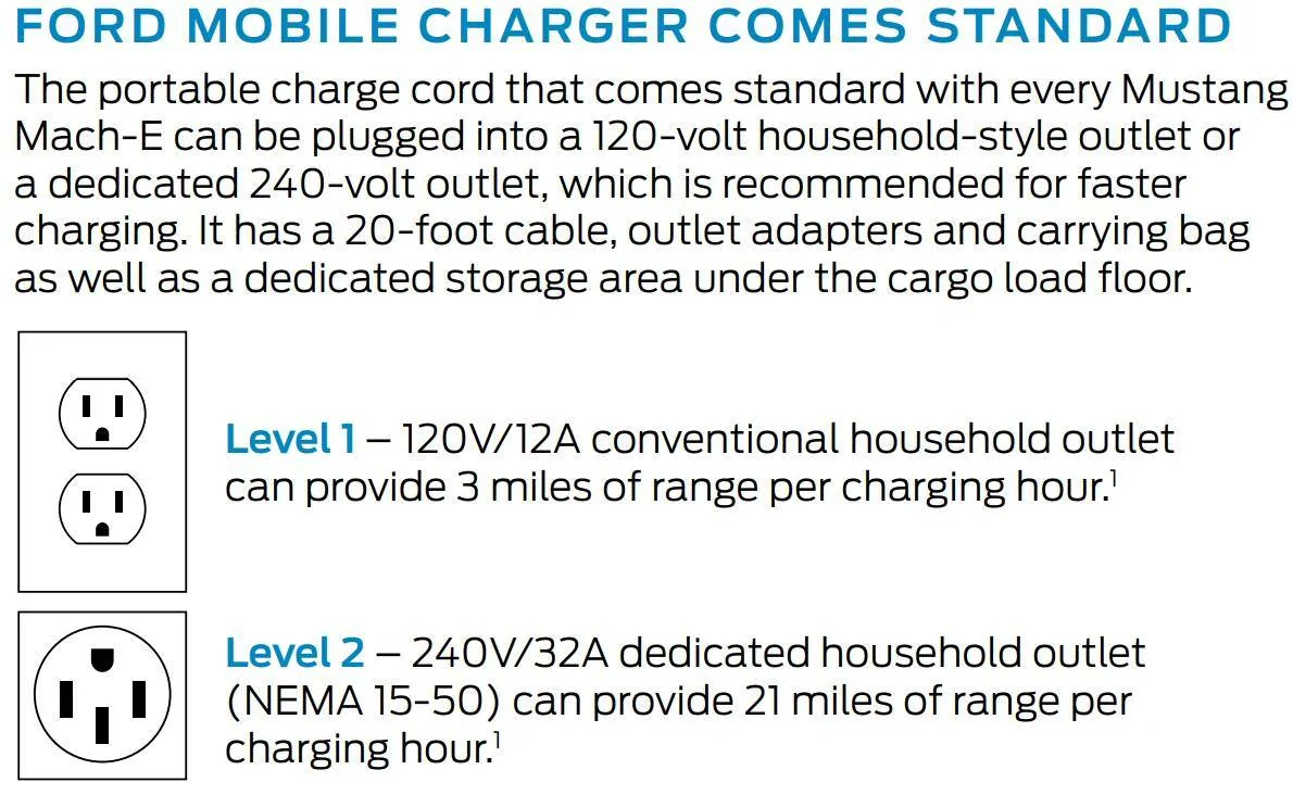

First post: From training doc, it indicates that Level 2 Ford Mobile Charger comes standard with vehicle, but requires NEMA 15-50 240V. I was planning on installing 14-50 outlet, for future plug-in charger of my choice. Don't see where any of the plug-ins use 15-50, only 6-50, or 14-50. Am I missing something?

The training doc is wrong. The mobile charger includes two plugs: NEMA 5-15 and 14-50.
Great... and they are quizzing the dealer trainees based on the 54 page document. Hope v2 of the document is already out.

The same training document has the following graphic. Correct image of 14-50, just incorrect text.
Ford Mustang Mach-E Shopping for a Home Charger 1597259988618
It would be nice if Ford had something official on that. I find media articles that say that, but nothing direct from Ford.
I agree. But the 15-50 isn't even normally available from places like Home Depot because next to no one has that in their home. And it's for three phase power, which is also generally not available in American homes. And we've already seen Ron Heiser saying that the NA MME's AC charger (built into the car) doesn't support 3P power at all.

Not worried now, based on feedback. Probably a typo. Just hope dealer parts doesn't start stocking up on 15-50 jacks, plugs, adapters, chargers... :)
