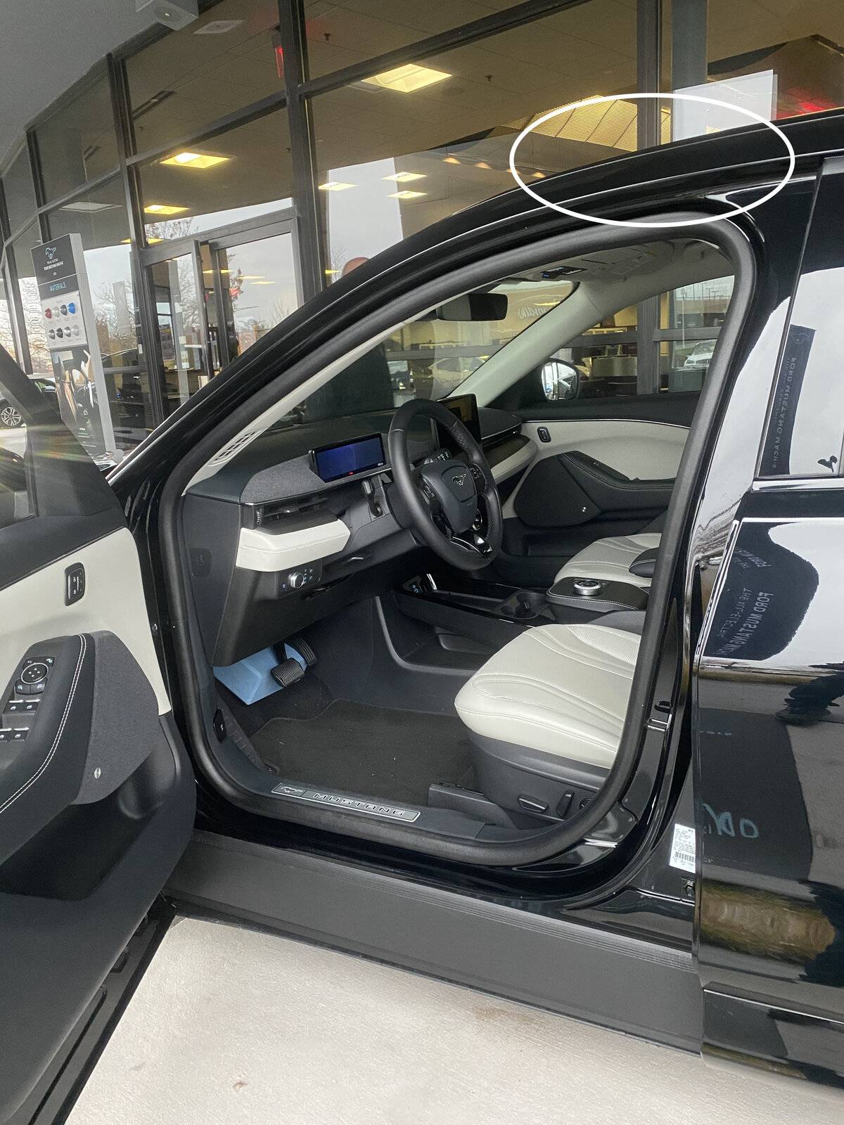

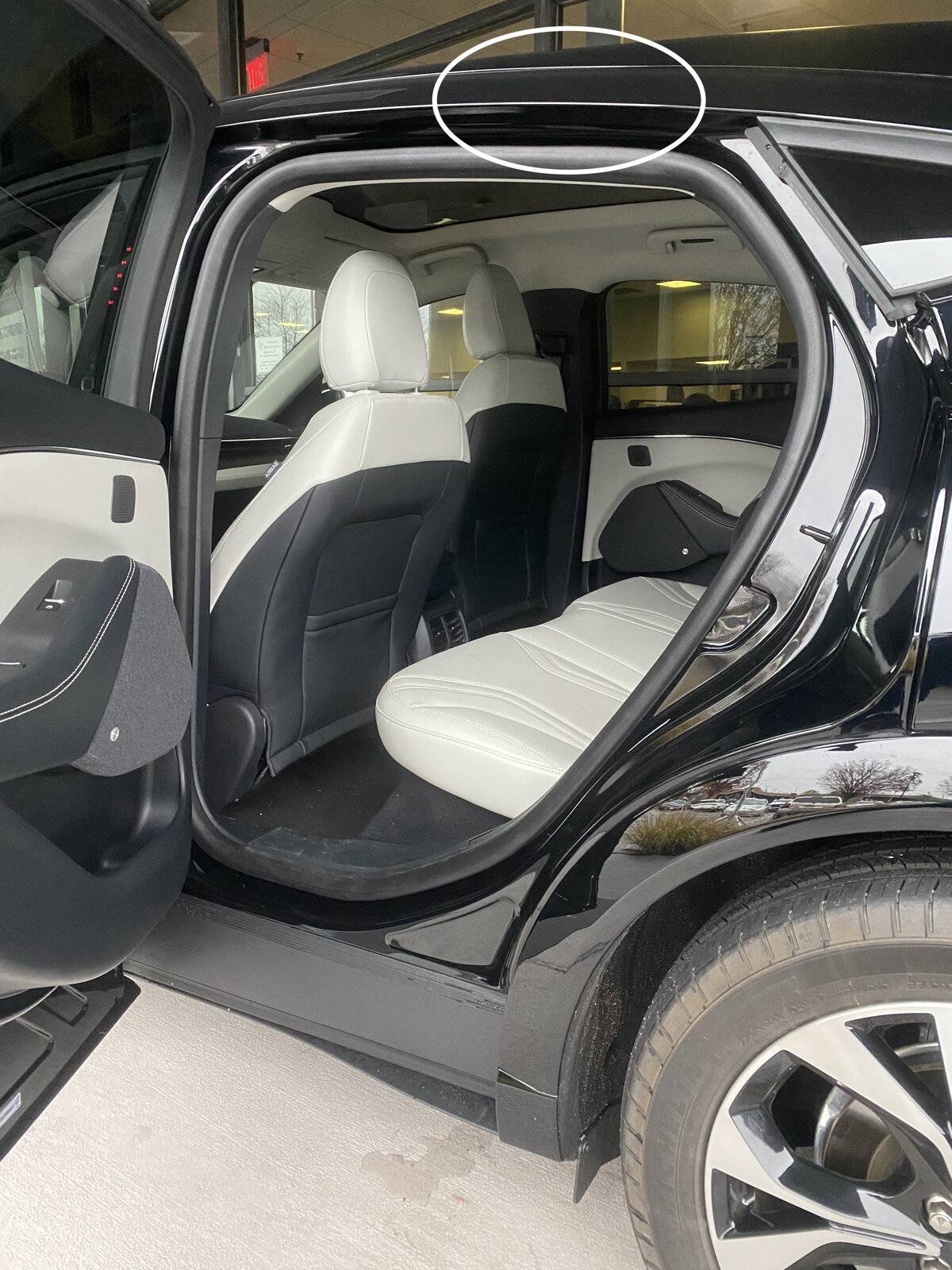

For those who have never used a Thule or Yakima roof rack, the feet mount at the steel door edge as shown in the ovals below.
Here's one of the myriad videos available online on how to attach a rack.
Should work fine for the Mach-e, even at the back door, I guess. Actually I am driving a car with frameless door/window and there I do not like this type of mount. There are fix holes to mount my Thule roof rack.

My concern is with the ~horizontal surface on top, that the roof rack’s foot is resting on and being pressed into with the wraparound clamp. You have the clamp force bearing down on that surface, plus the mass of the rack and attached cargo. If that surface is not structural, it will not maintain its original shape.
I had a similar rack on a WRX once. I apparently overloaded it with a two person kayak, and was left with permanent deformation of the metal under those roof rack supports.
I might be wrong about the strength of the MME there...it was just a quick check wondering about rack options. My conclusion was a roof rack wouldn’t be an option...maybe others will prove me wrong.
