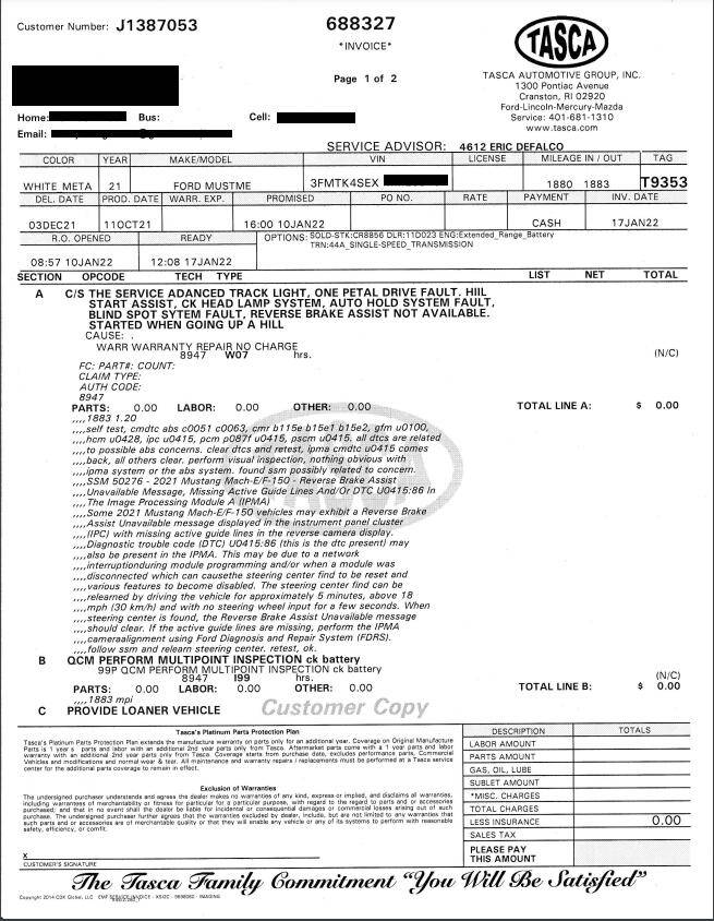

Glad they were able to resolve it! I do think this issue needs more investigation. Over-revving is certainly not the problem - the tires would have to be moving >120 mph for that to happen, since the car has a ~13,800 rpm redline, the inverter frequency is computer controlled, and there is only one gear.
I know that EVs and hybrids often donāt like spinning tires because when the tire suddenly stops spinning it can create a large back EMF (an electromagnetic ākickbackā) that can create overvoltages in the motor windings. The 2nd gen Prius (~2004), offered traction control at all trim levels - this was marketed as a safety feature, but it is really because they knew the car wouldnāt handle multiple big spin/rapid stop EMF pulses.
