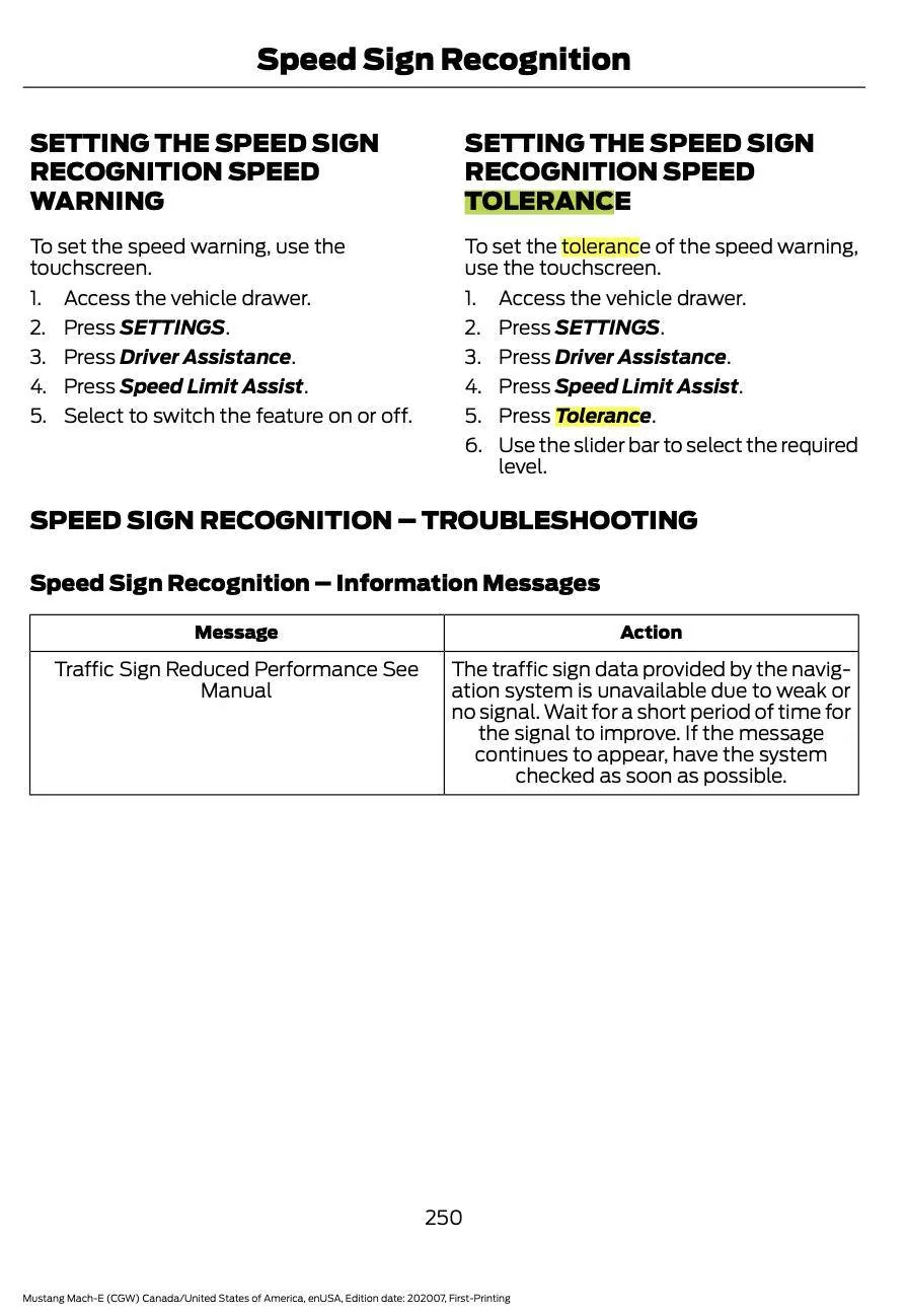

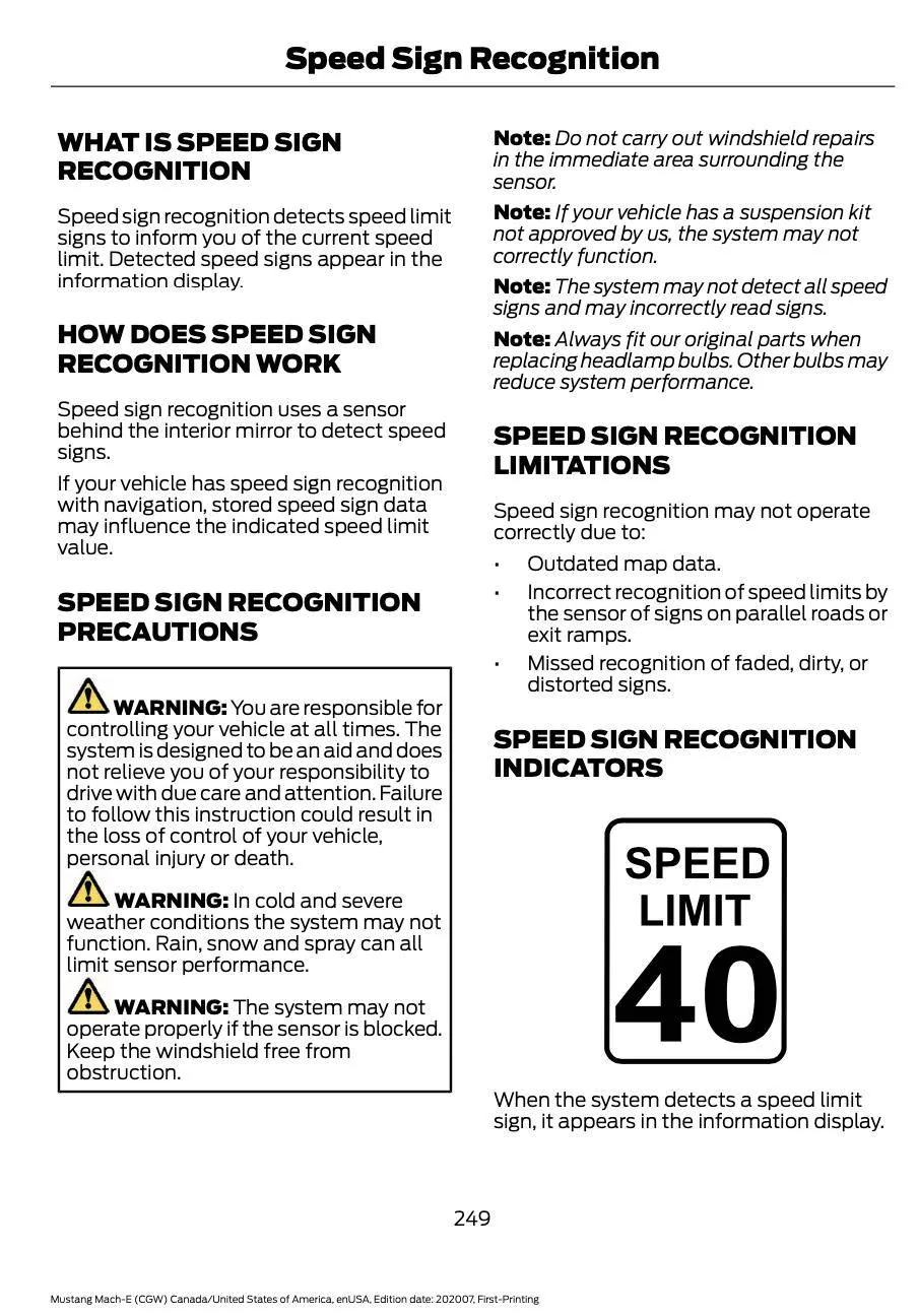

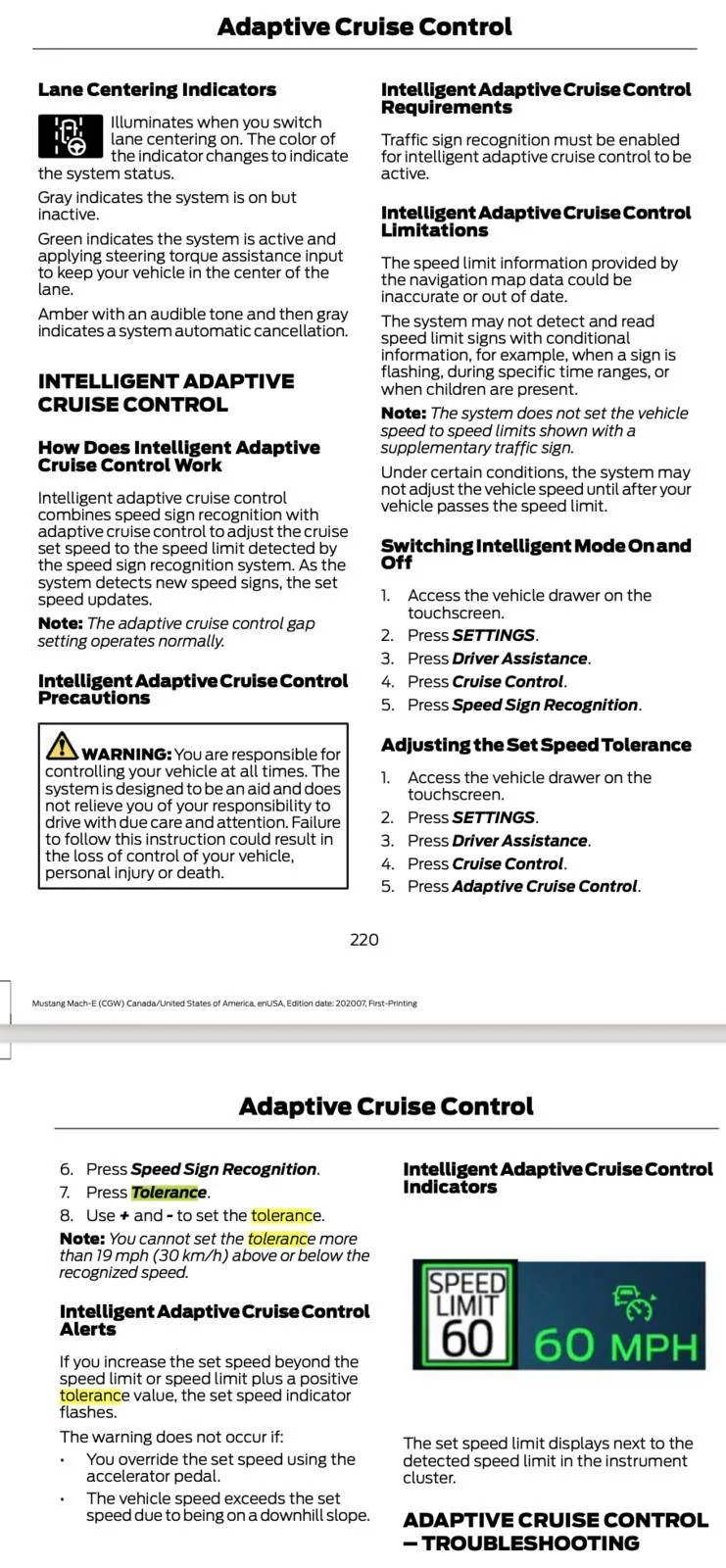

I should try to check the manual too. Well, so much for the manual - (no range for the speed sign tolerance)
Check out the last page and a half. CC tolerance does cause the car to follow signs (posted speed limit) by between -19 mph and +19 mph. That is very strange. Maybe +/- 10? I guess it's a problem if say you routinely do +10 somewhere by common local practice, and every time intelligent CC reads a sign, it would drop the speed back down to sign speed. The problem is that the common local speed vs. sign speed limit is so location specific. +10 on the highway might be fine some places (not here, where maybe +6 or 7 mph highway is worry free), but not 40 mph in some 30 mph zones, where others might be 40 by local driving practice just what most locals do.
