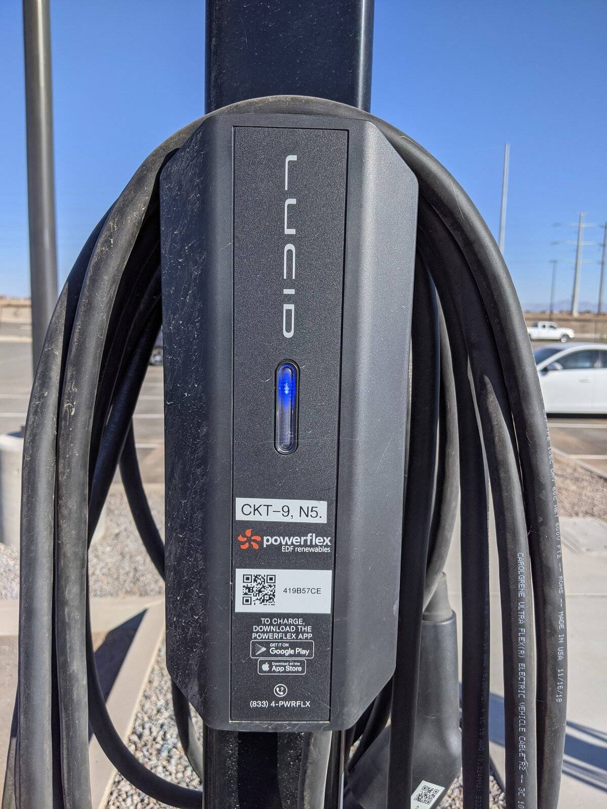

Looks like rebranded Webasto TurboDX L2 chargers here in the parking lot of the Lucid Motors factory.

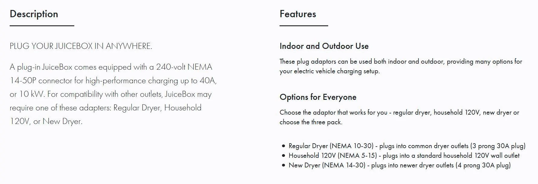

Why? The page says "UL and cUL Listed". It's possible that SRP is lying, but why would they?
It says that under the Juicebox EVSE column, not for the adapters.
How could an adapter that allows a device using a 50A plug to connect to a 30A circuit pass certification?
