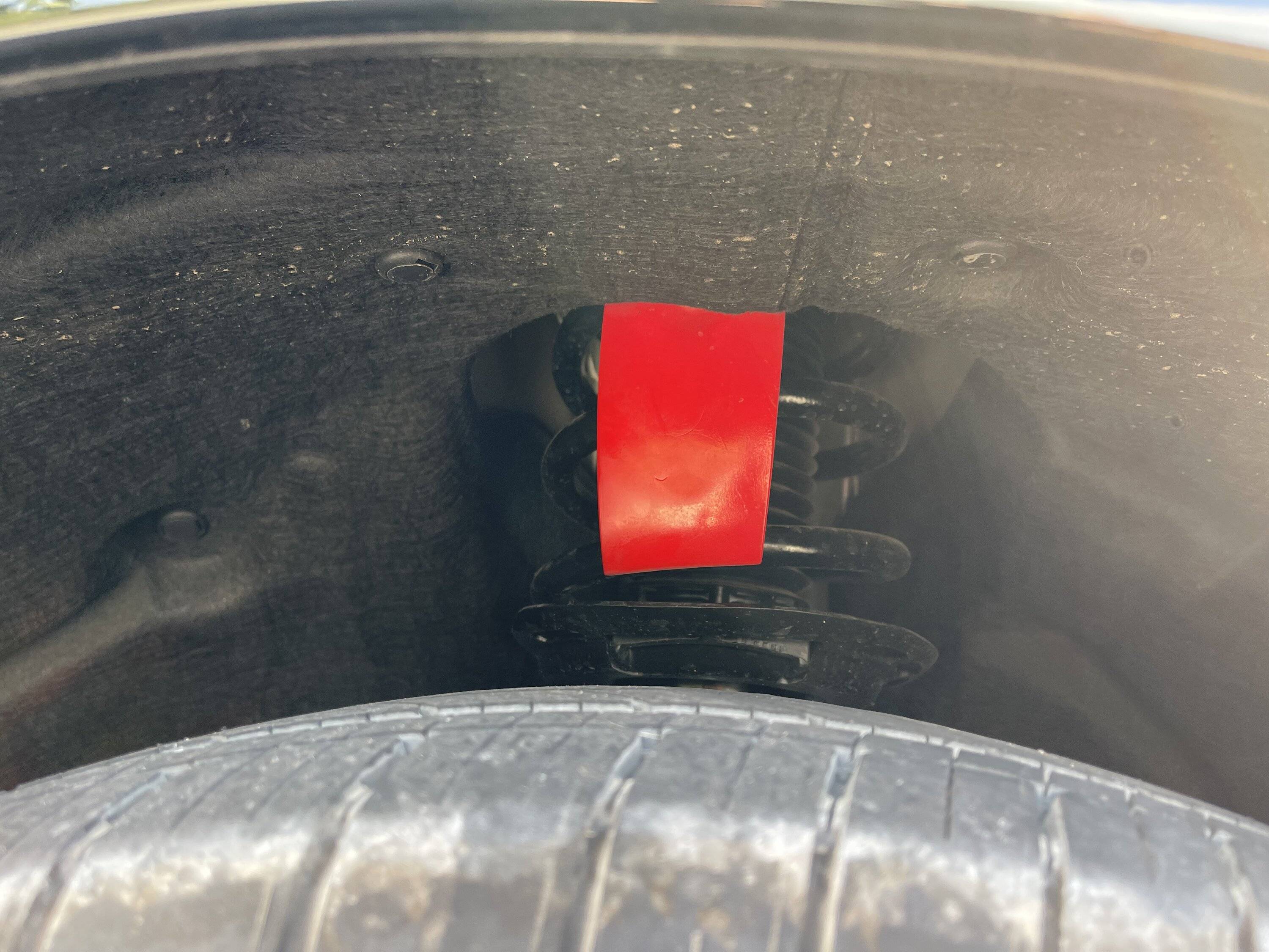

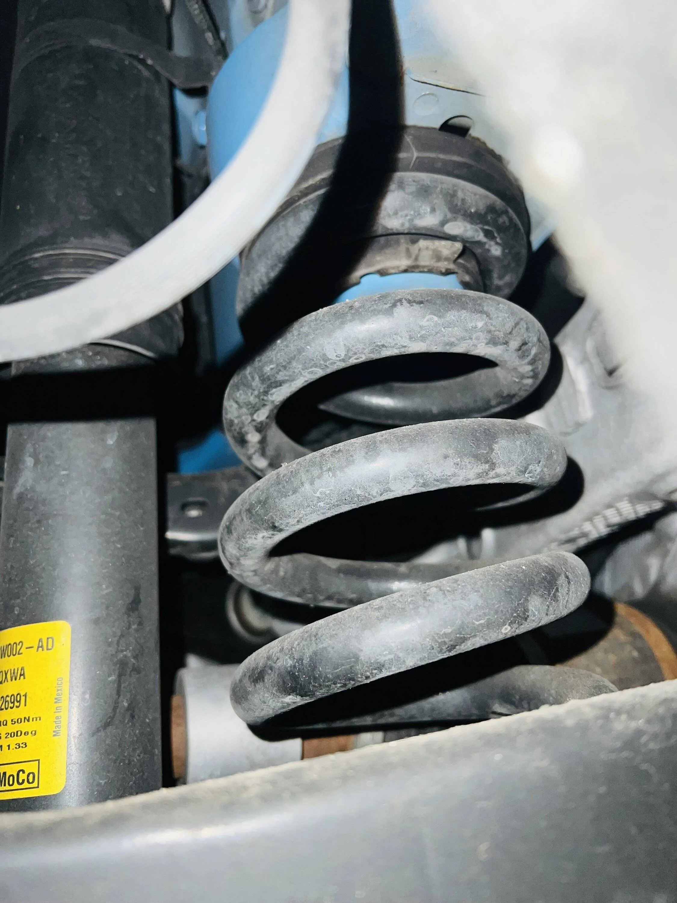

SSM 50173 - 6 Oct 2021 - 2021 Mustang Mach-E - Front Suspension Noise - Front Spring Spacers - Built On Or After 26-Jul-2021
Some 2021 Mustang Mach-E vehicles built on or after 26-Jul-2021 may exhibit a noise from the front suspension area. This may be due to spring spacers in the front springs. The spring spacers are for shipping protection and need to be removed prior to delivery to the customer. This is included in the pre-delivery inspection (PDI). If the noise is due to the spring spacers, remove the spring spacers. Do not submit a claim for this condition.
END SSM
This isn't really new, I thought earlier build cars had the same issue?

Ah, I see the PDI checklist did get updated to include checking for the spring blocks. They've also added instructions for checking the underside of the battery for dings and scratches, I would recommend you look under the car as well at delivery.
