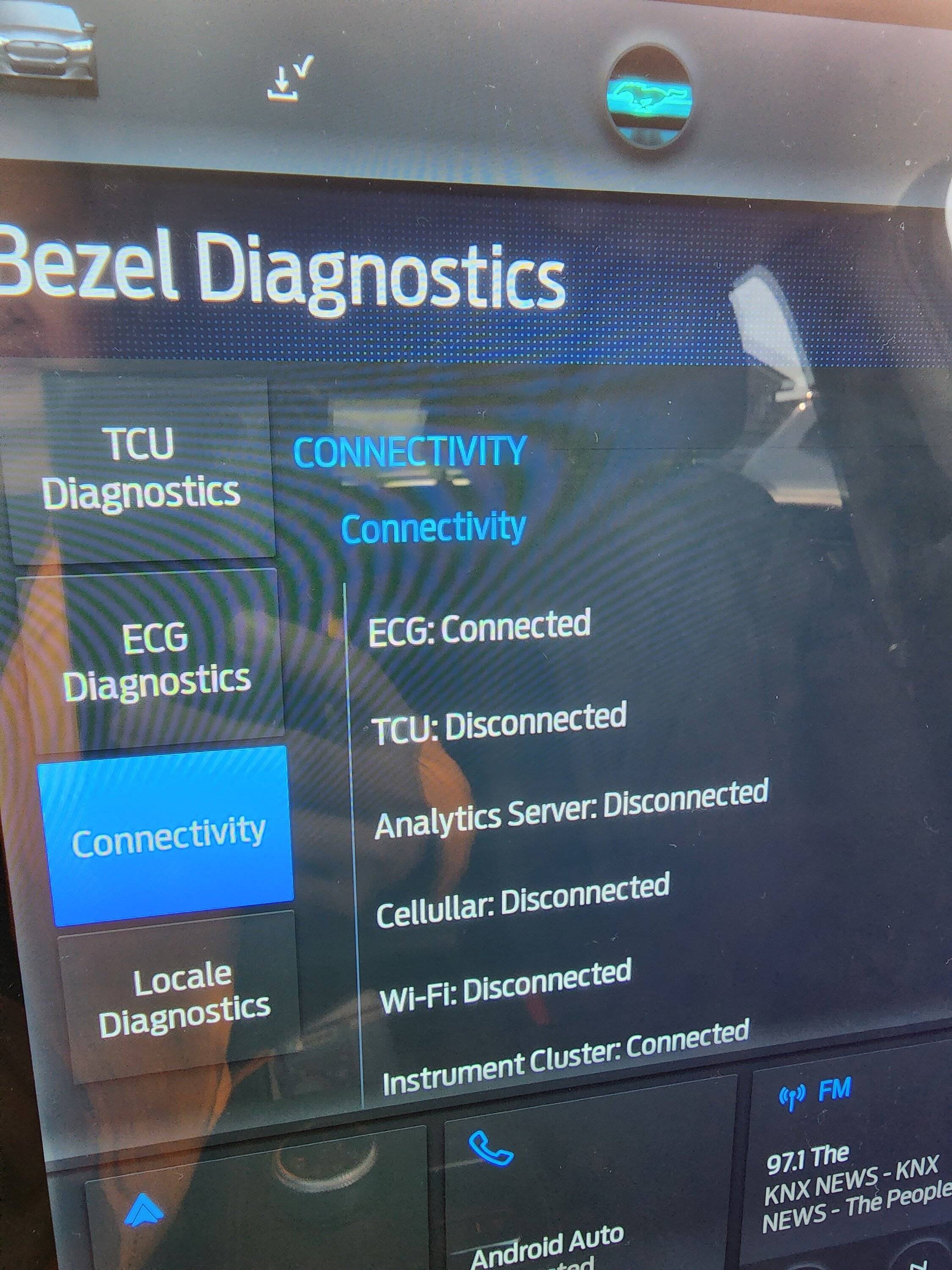

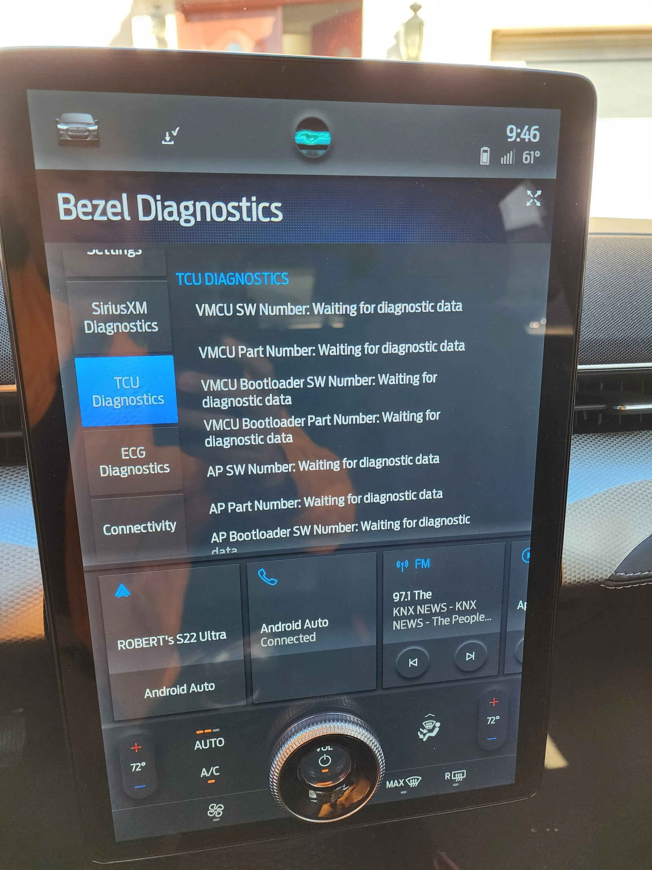

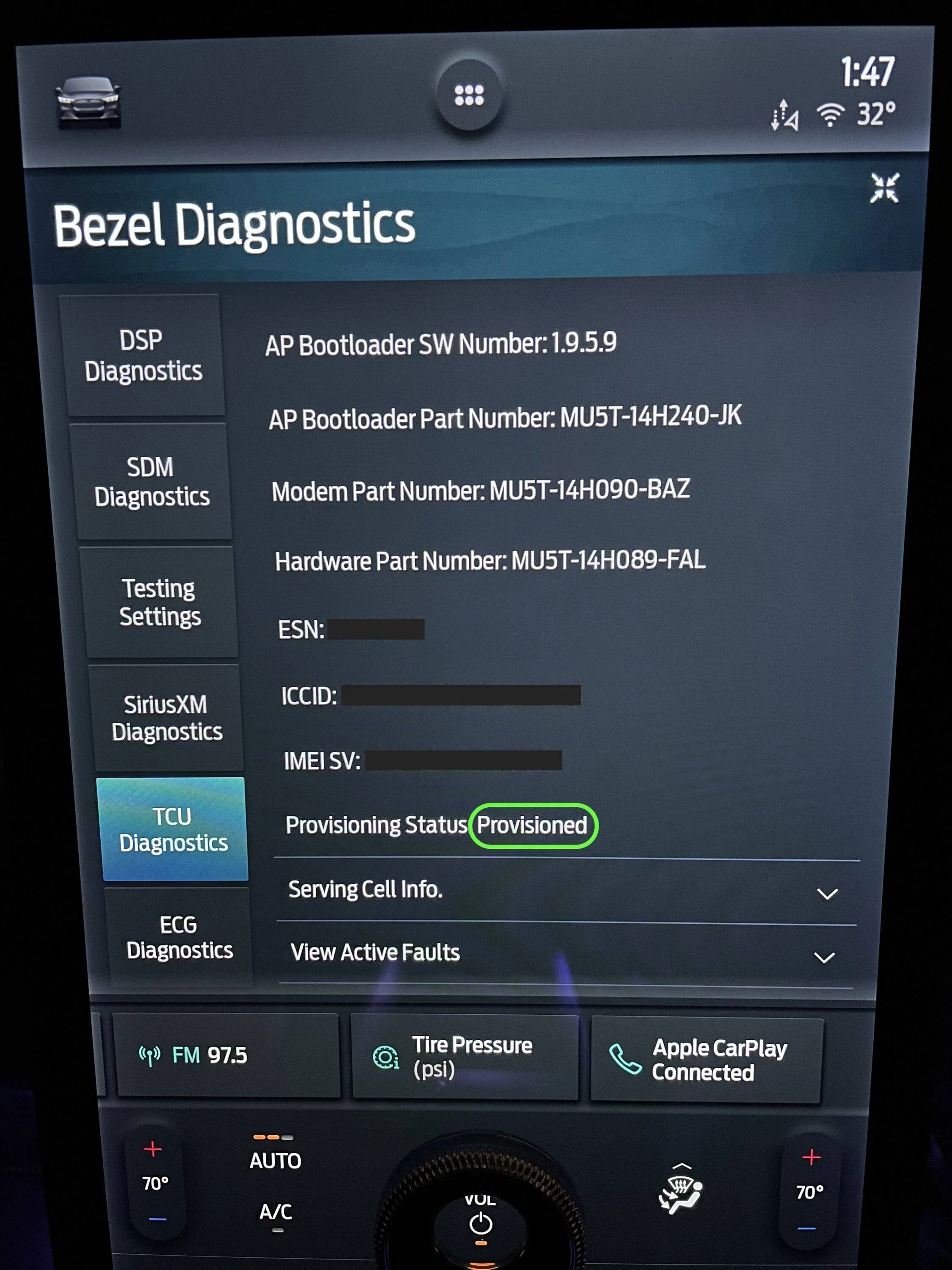

I've seen this a couple times over the past year, vehicles with this issue may not have functioning remote start from the FordPass app, or an "activation pending" message that never goes away. Affected vehicles may not receive any OTA updates as well. Check for the presence of a missing "Onboard Modem Serial Number (ESN)" in Settings > General > About SYNC on the screen. You can also directly check the TCU provisioning status in Bezel Diagnostics. On the steering wheel, hold VOL – and ᐊ arrow until it pops up on the screen (similar to SYNC reboot). On the left side, scroll down and tap on TCU Diagnostics, and then scroll down on the right until you see the Provisioning Status. It should say "Provisioned". If not, then you need to visit your dealer and mention this SSM.
The TCU fuse is #11 (5A) in the passenger footwell. FDRS is required to complete the provisioning process.
Note: This will not enable the frunk button before anyone asks.
