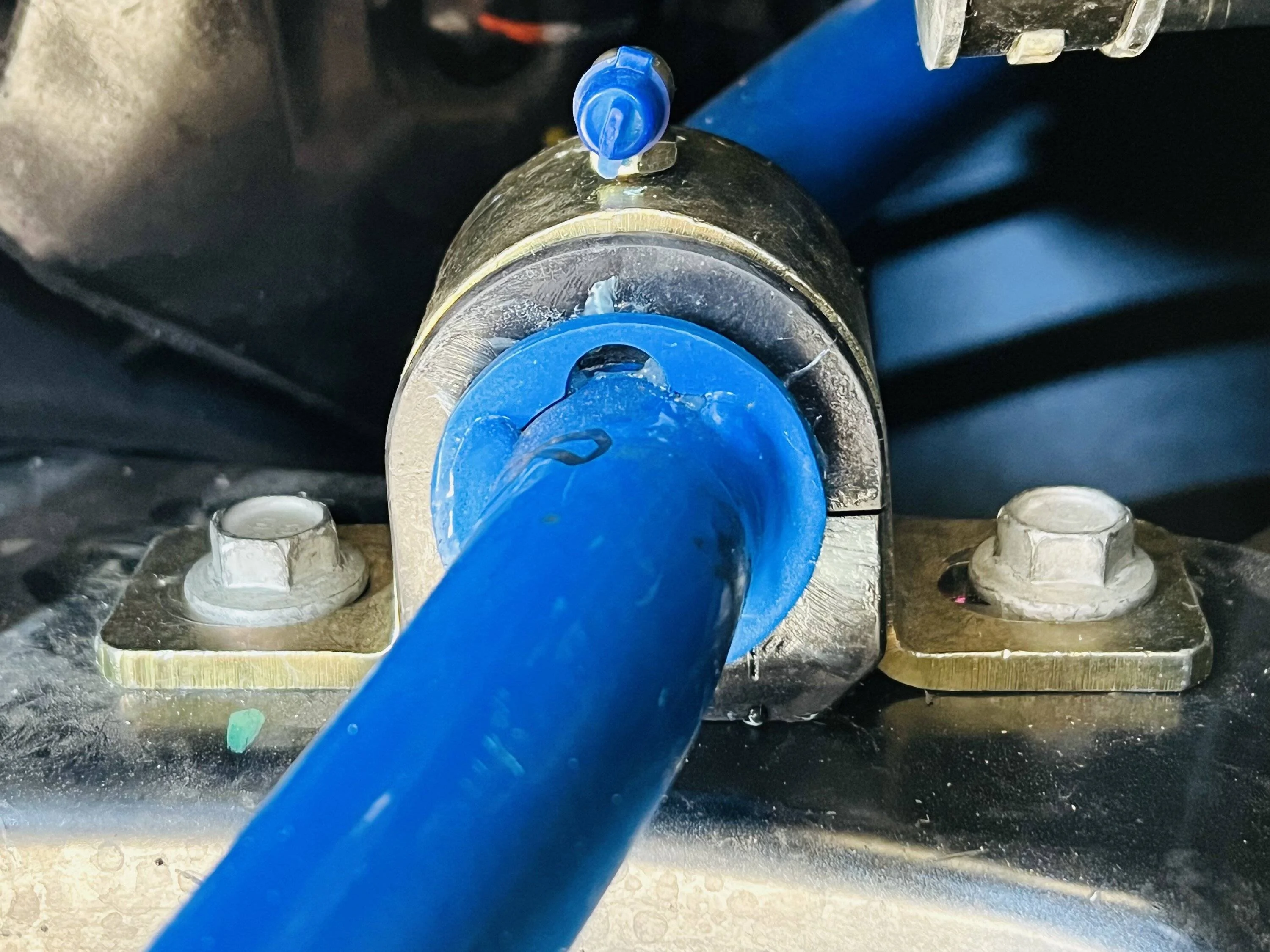

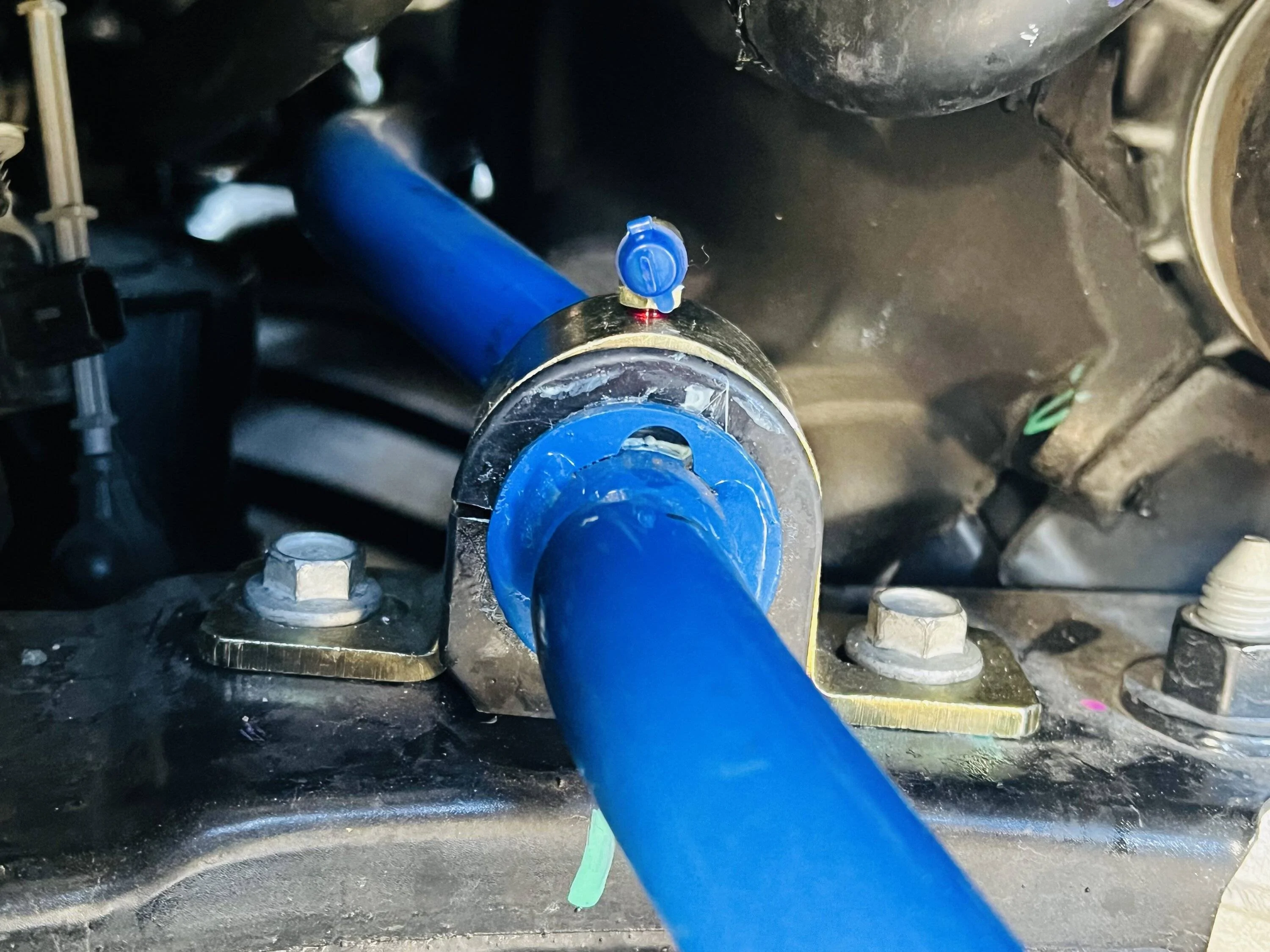

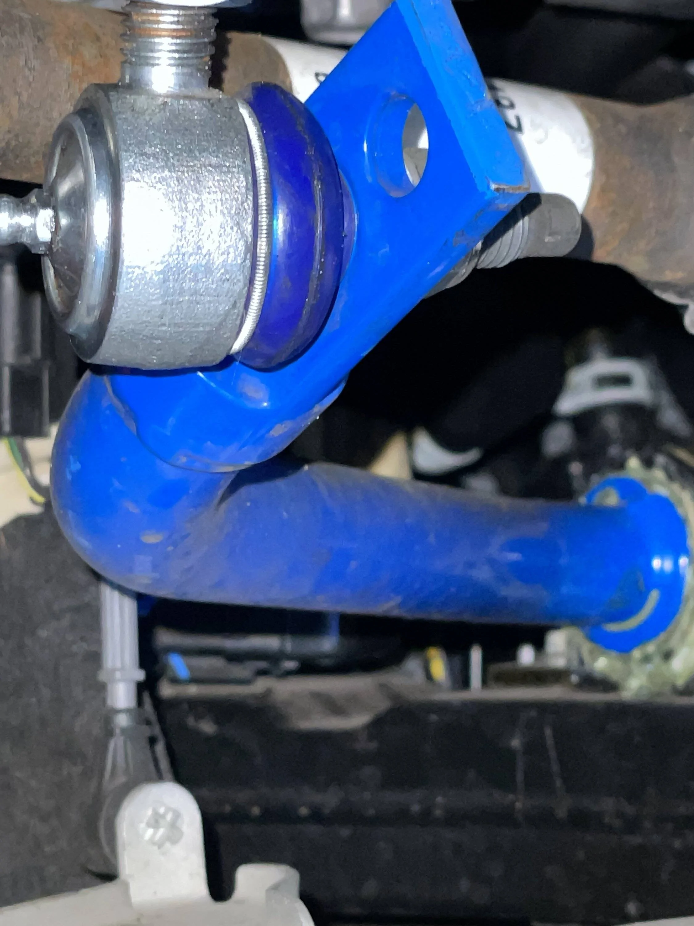

This is very true. Think of it as suspension friction. Any time your moveable parts are hard to move it causes slowness of the moving components.I attribute this to the Steeda bars having the typical type of bushings that allow the bar to easily move up and down. The OEM bars have bushings that are clamped to the bars and it is impossible for you to move those bars when they are mounted on the car (without the end links attached). To me, I would think that could cause a more harsh ride and also have something to do with bounce but I haven't noticed a change in that.

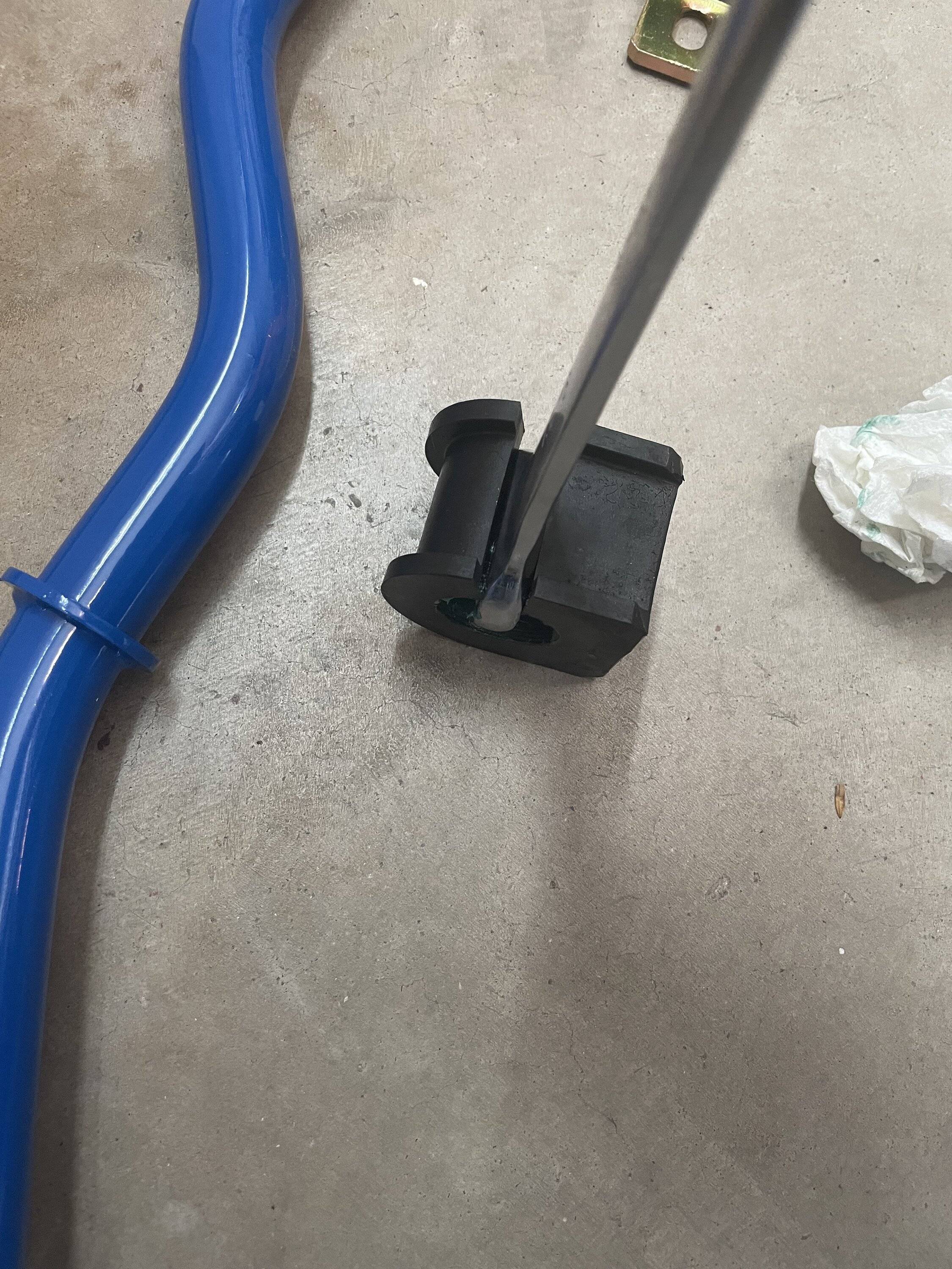

My Can-AM has 24 inches of travel in the rear. 2 feet. But when I updated my rear sway bar to an Eibach I (and everyone else that bought that bar) ended up with exactly this. The reason was the bushing was designed for the factory mount area. But 99% of us put a plate there to hold rockblockers to keep rocks out of the rear wheel. I hadn't thought about it until I drove the car around but once I took the end links off I couldn't budge the sway bar. And I weigh 240lbs. Pulled it off and sanded the bushing a bit so it'd fit better and allow the bar to move. These are hard shaped bushings, not urethane. Night and day difference. I had noticed after I put that bar on my suspension was only moving about 1/2 as much. Once the bar swung nicely the entire suspension was used again.
On the MachE I suspect someone got a sale on a bushing with 'X' internal dimension. But a bar with X OD. Thus it binds. It might be 'solvable' if someone just sanded the inside of the factory bushing and put it back in. But it won't be scientific and without there being 'it must be able to fit this Craftman 9/16 socket through it easily' it won't be internet mechanic friendly. I think the bushing would eventually wear in, probably around 50k to 100k, if one could wait that long.
