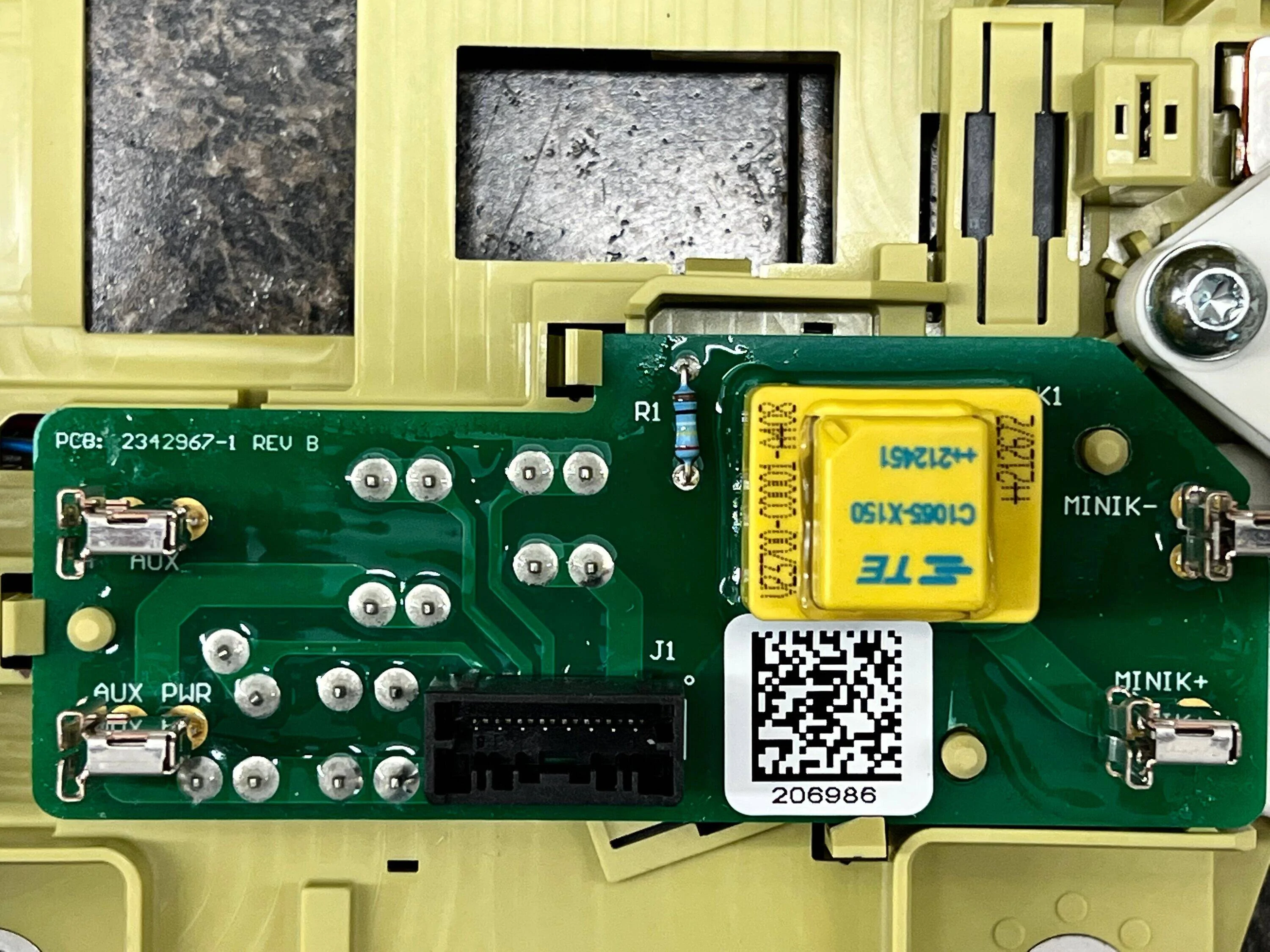

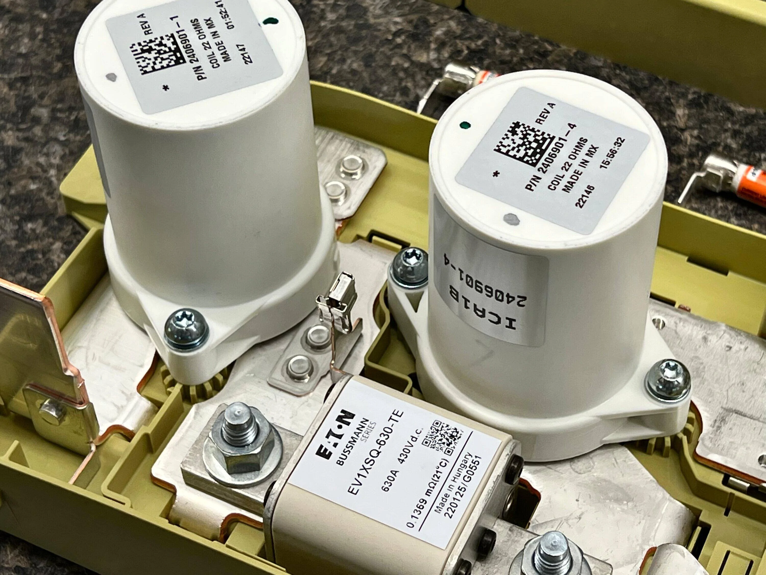

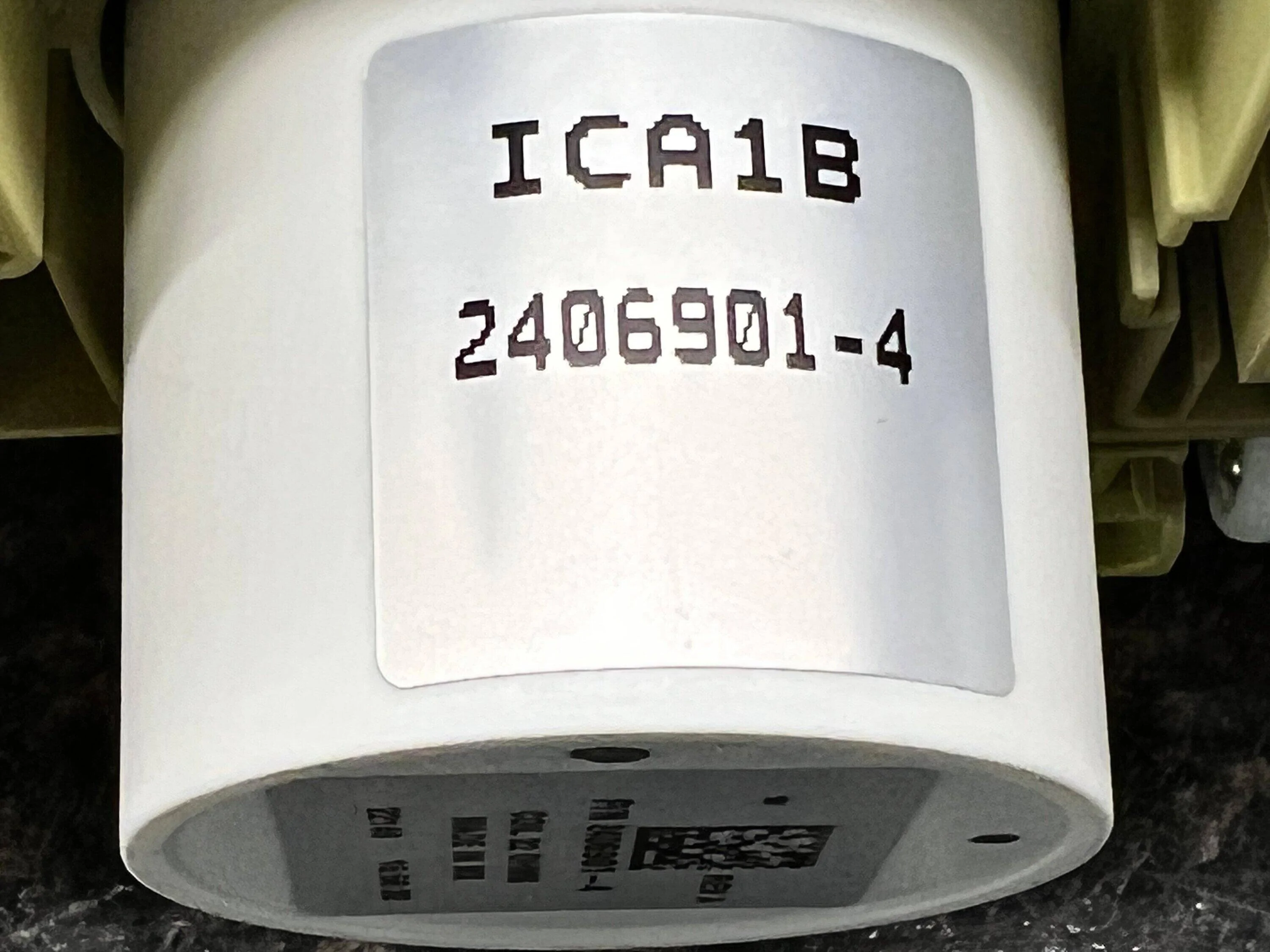

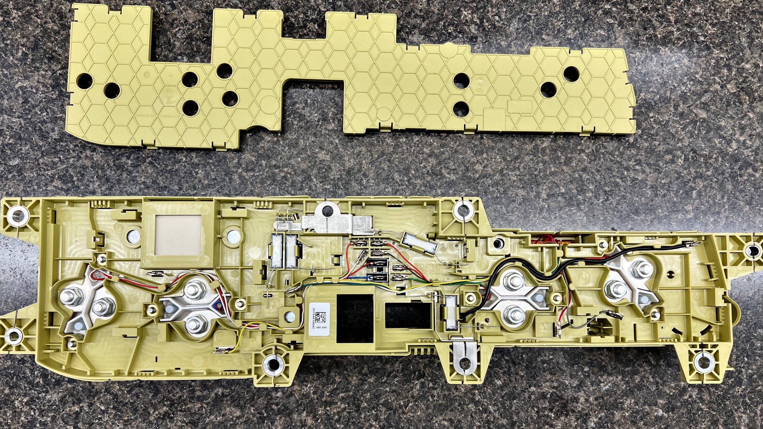

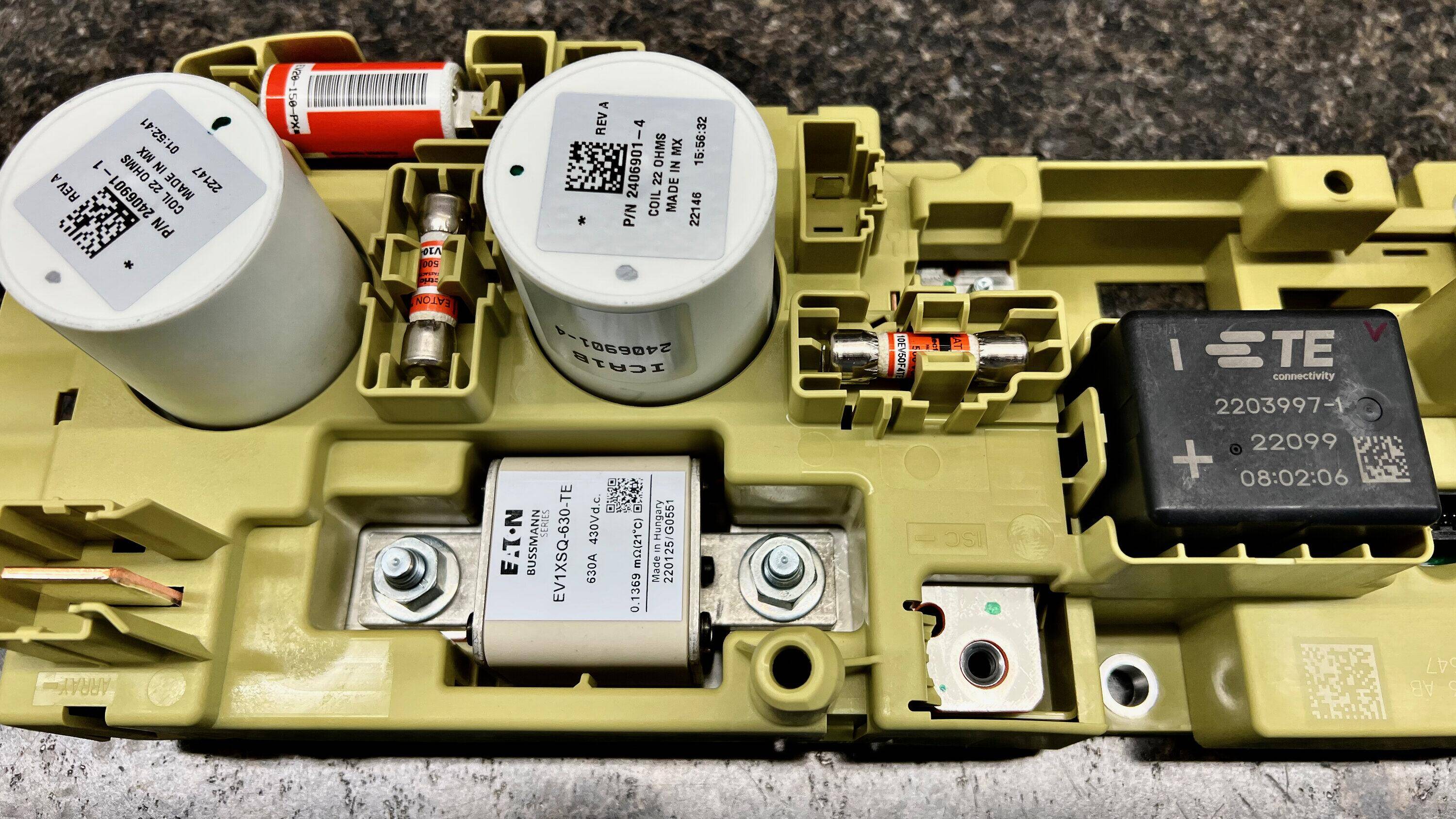

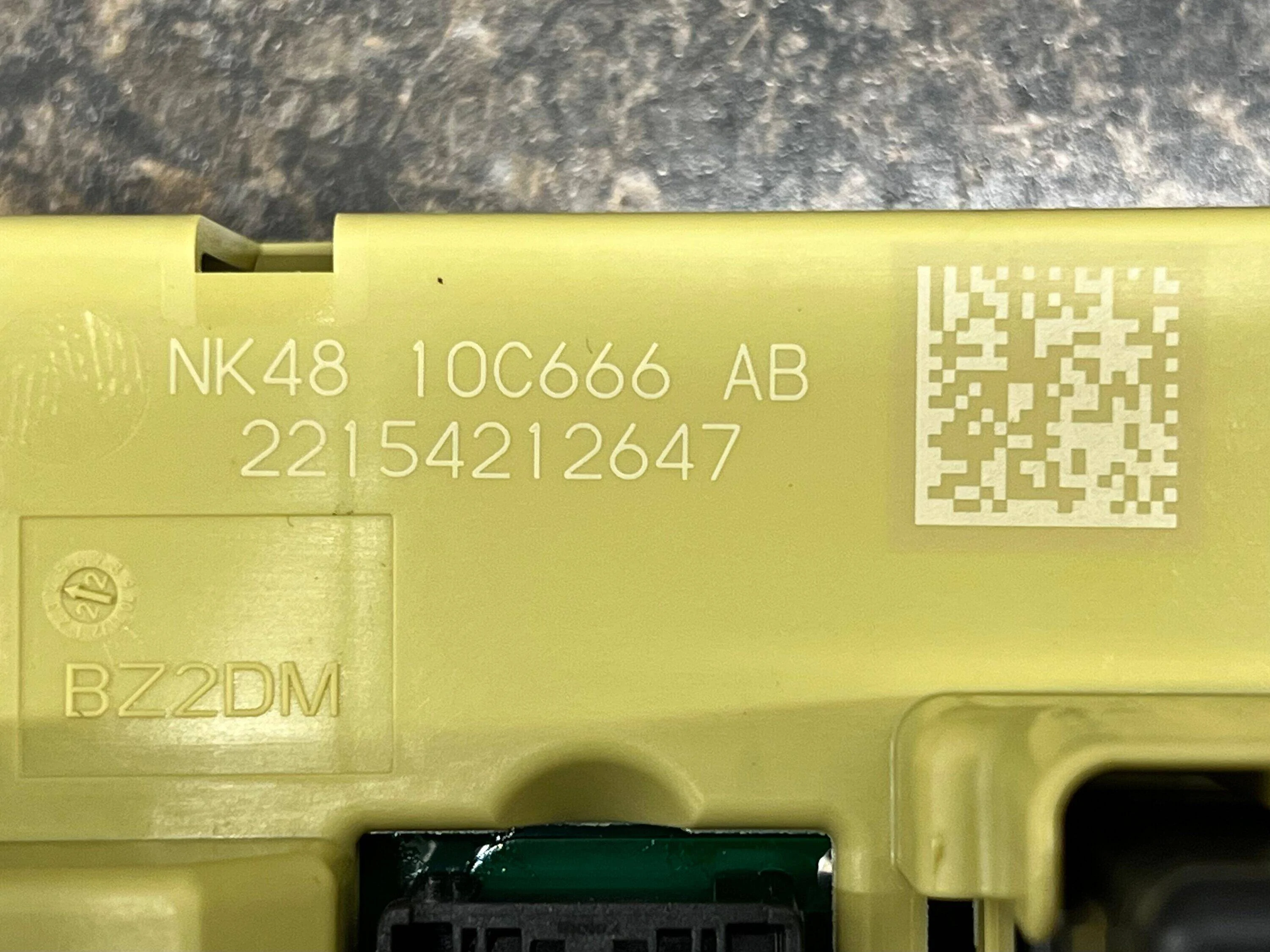

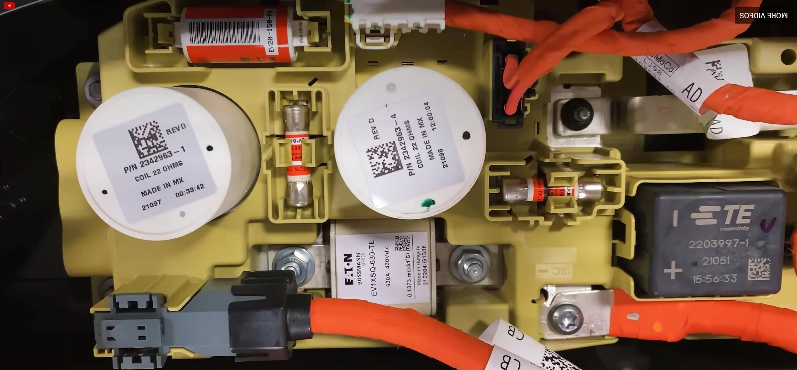

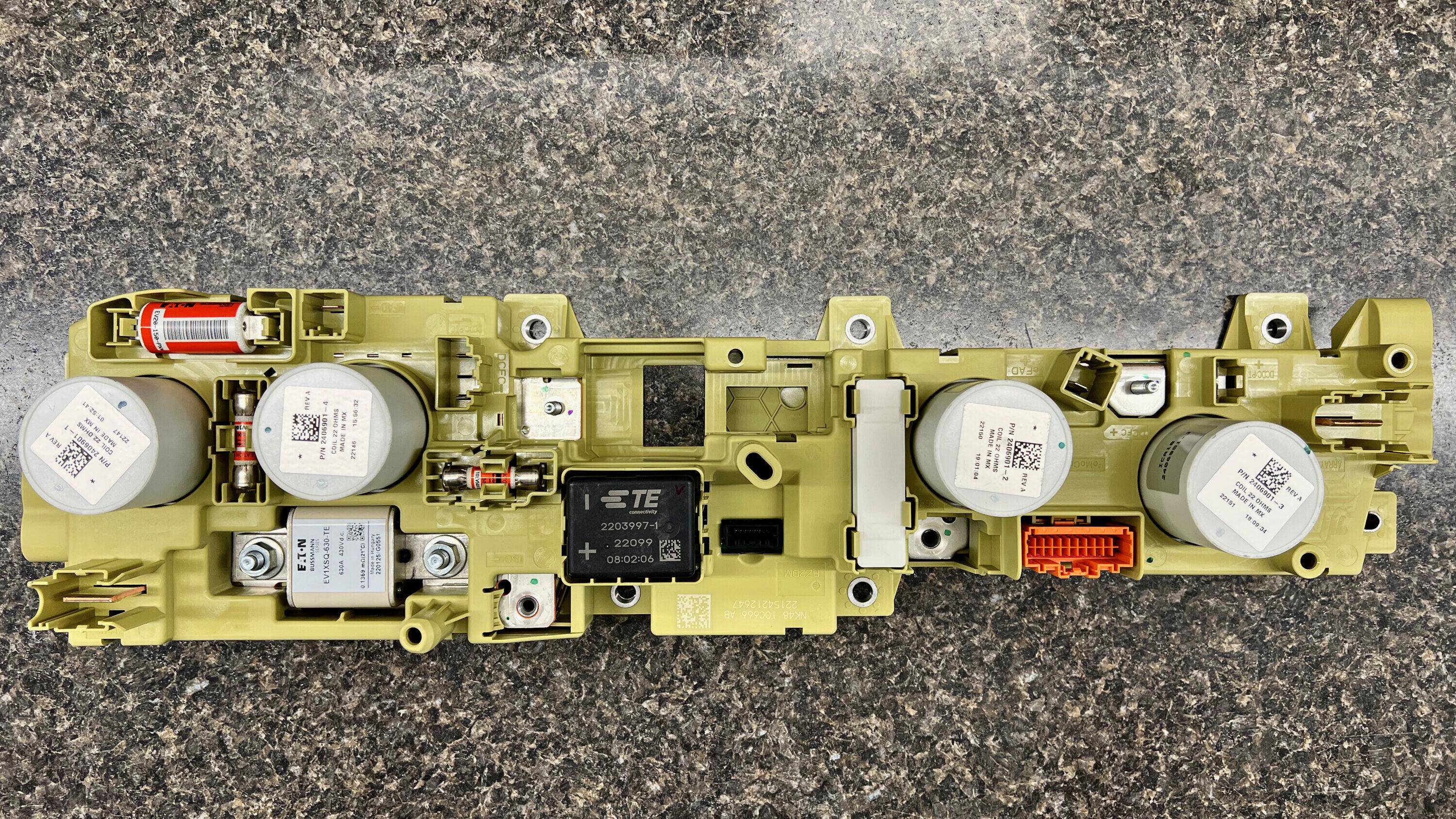

Pictures:
These are pictures thanks to @markboris - his post
This is the OLD - BAD version of the HVBJB thanks to @Scooby24 and his post here:
