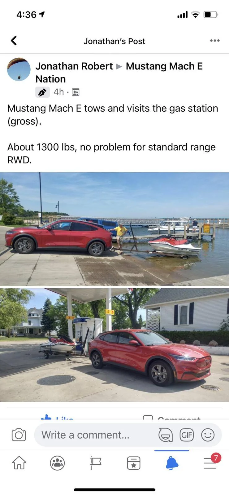

Towing example from FB
Ford Mustang Mach-E (Summary/collated) Tow hitch on MME (towing capacity and towing equipment for MME)? B7F64963-2A60-45A1-8385-A61E51D2C012
