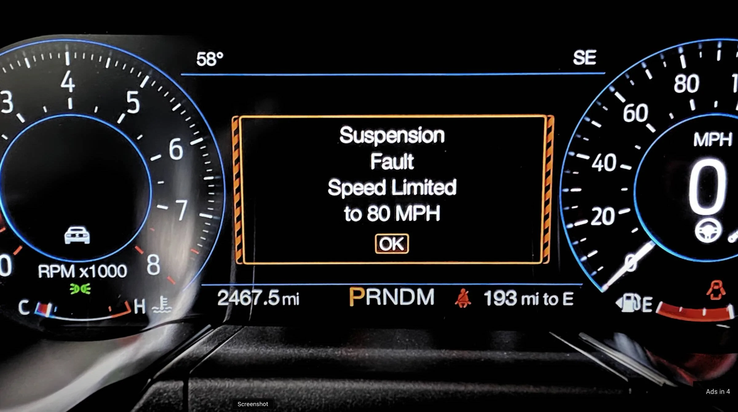

On my GT500 (MagneRide Suspension) I once had the "Suspension Fault Speed Limited to 80 MPH" warning when I had done some rear end suspension mods. After checking more closely, when I reinstalled the right rear MagneRide shock, I didn't plug the connector in tight enough. I never had the warning come back after that issue. I know others with S550 Mustangs have gotten this warning with failed ride hight sensors and damaged wiring leading to the shocks.
Nick (uncle_0gre) might be on to something and it has to do with the MagneRide shocks or some sensor getting too cold and displaying that warning. I don't take my GT500 out when it's extremely cold with the wide (345/30/20) summer tires so wouldn't know if I'd get that warning because of cold temps.

Just got this warning first time today on my GT PE. I'm in California so cold should not be an issue. We haven't seen temps below 40 in the past couple of weeks.
One thing I did different in the past 2-3 days: I have been using remote start more than usually. Today before seeing the warning I drove for more than 20 minutes on Blue Cruise (Ford 'self drive'), parked the car on the street around 6pm for an hour or so and then remotely started the car. And there it was. Other info: Drive mode was unbridled. Temp outside I'd say 54*F.
I'll keep an eye on it for next week or so before taking it in. At least I'm glad to hear on this thread that if the warning goes away we're not limited to 80mph. Although it sucks to hear that technicians are still scratching their heads.
