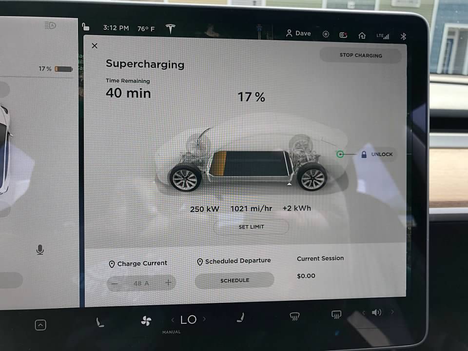

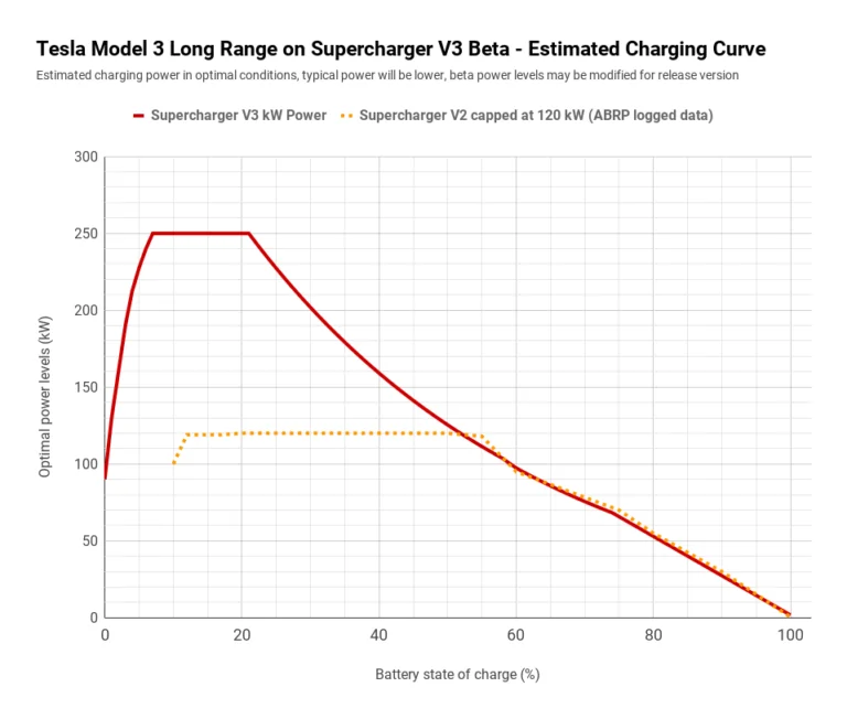

Is my math off, the Tesla photos not correct or does the Tesla mode 3 on a V3 Supercharger have one heck of a taper drop off?

Yep, I owned my Tesla and got the 250KW experience. IT is only marginally faster, and it really just a marketing gimmick. While it does speed up the charging time from 0-70% significantly, most the time people don't want to arrive at the charger at less than 20%.

Why wouldn't you want to arrive under 20%? The charge rate is faster the lower you arrive at... so I always try to arrive as low as possible, and only charge until the taper hits.
Unplug after it drops below 100kW, move on. Works great, personally.

That's 40 minutes to 100%, looking at the "charge to" bar.
