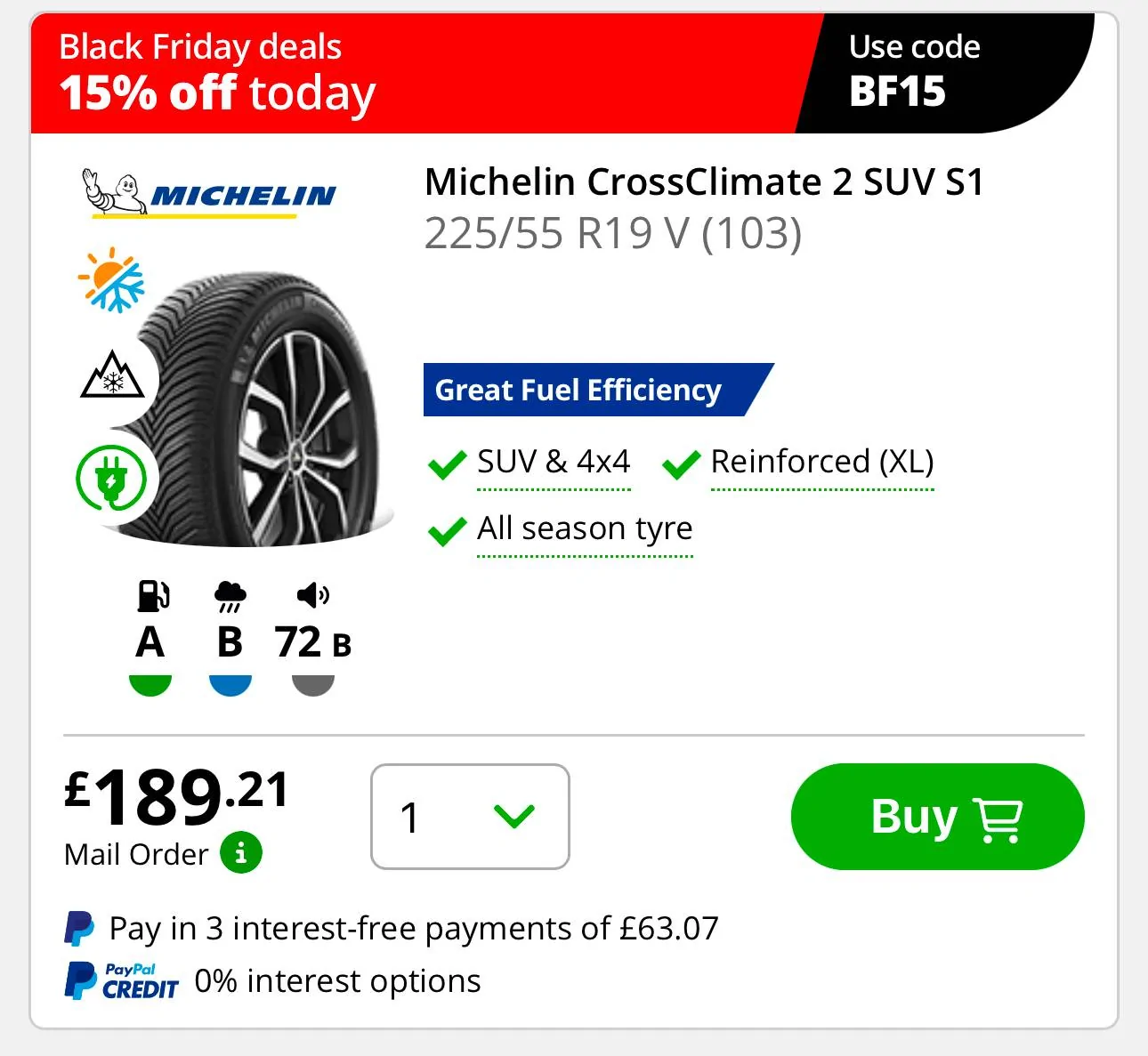

I can’t fault the Bridgedale Turanza T005 summer tyres that came with mine. I swap them in winter to Pirelli Scorpion Winter 2 tyres which are incredible in the snow and ice however I would probably go with Michelin CrossClimate 2 all season tyres and keep them on year round (they weren’t available in the right size when I first wanted them).
Ford Mustang Mach-E Tires wore out in less than 2 years - anyone else having this problem? IMG_6750
Been on Mich CC2s for c70,000 miles, they perform how their tread looks, up to the job👌
Really can’t be arsed with changing tyres twice a year, haven’t the time and Stangy’s wheels don’t stop turning long enough!
