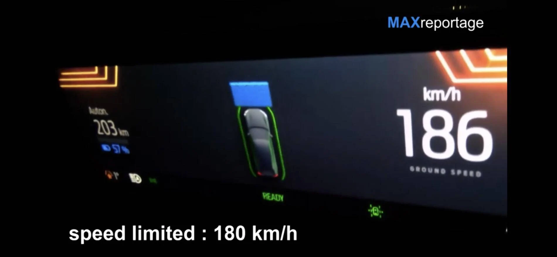

Pretty sure there is German autobahn video that shows actual 115 mph converted.
EDIT:
Ford Mustang Mach-E Top Speed of MachE FBCB6A20-4B38-4E23-BD20-065F305C27CC
