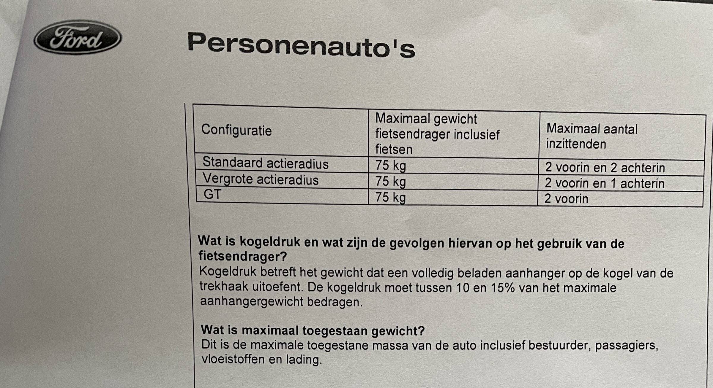

That must be why they don't allow for any towing or even have a bike rack option in the US. They know most Americans don't read the instructions!In the EU the weight you are allowed to pull is 750kg, tongue weight is only 30kg exept when using a bike racing then it is 75kg.......
When 75kg bike rack mounted the numbers of Passengers in the back is restricted:
SR 2 front, 2 back
ER 2 front, 1 back
GT 2 front, none back

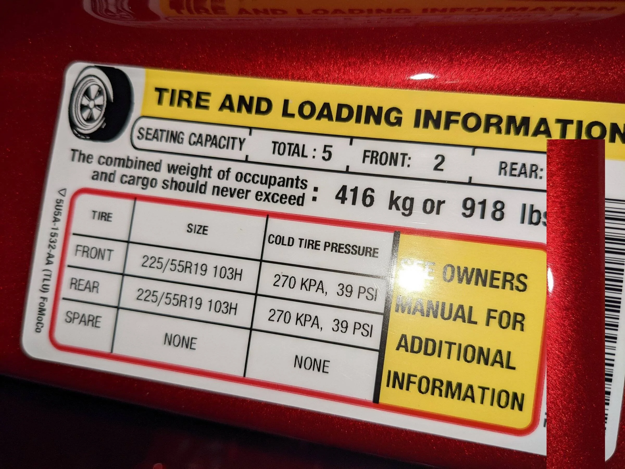

Are the wheels and tires able to handle the additional payload?As long as you're not doing jack-rabbit starts, 350hp and 450 pounds of torque seems more than capable of hauling a small trailer. It would be similar to climbing a hill.... or my driveway.
I'm sure range suffers, but I trust Ford tested for extremes.
Loading the cargo area with 150-190 pounds of trailer tongue doesn't make much difference given that the car weights 4,920 pounds. An extra passenger is that much added weight.....Monkey on an elephant's back.The effect of weight is very different dependend of where you place it...
The carrying capacity of any tire can be found. Let us know.Are the wheels and tires able to handle the additional payload?
