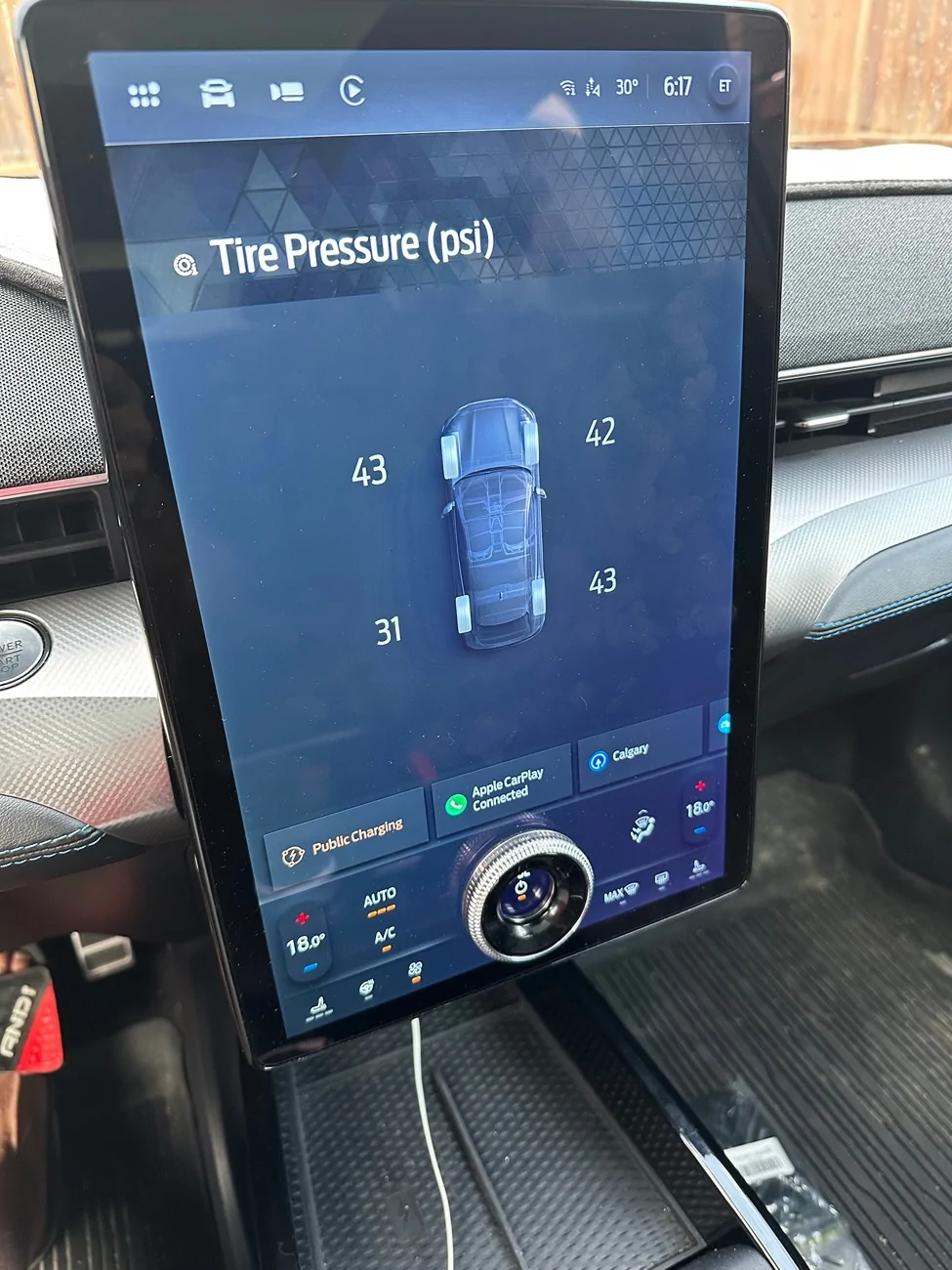

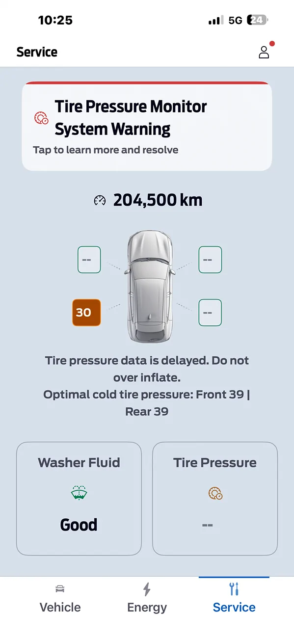

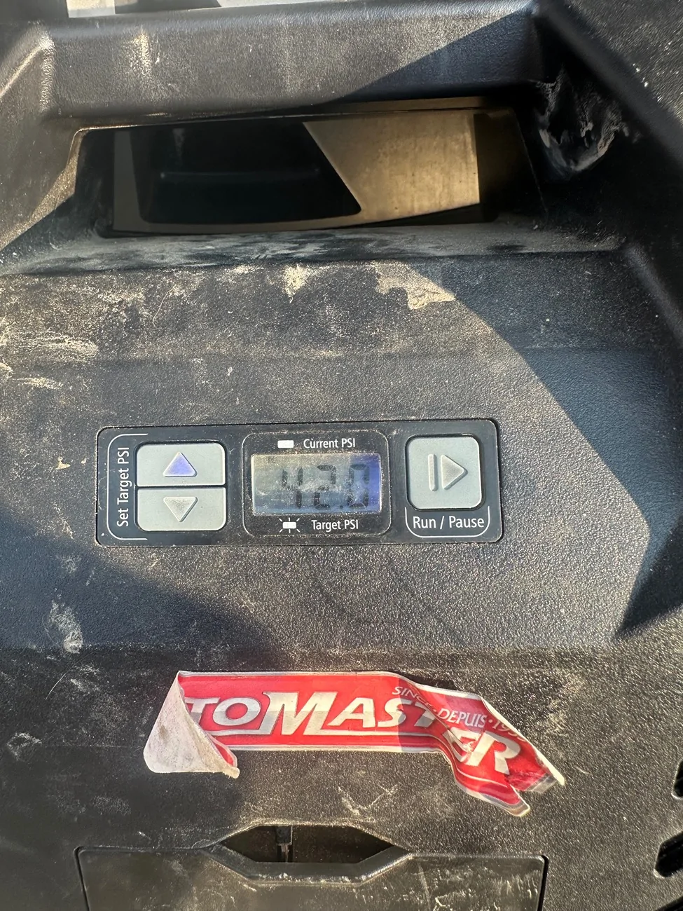

TPMS on my display says 30 psi but when I plug in my air compressor, it says 42 psi.
I have checked the other three tires and they are all the same as the air compressor.
I am going to call Kaltire tomorrow and make an appointment to get the issue looked into.
Does anyone know what is wrong?
Thanks

Drive the car several miles and see if it updates. If not, then double check with a tire gauge (not the inflator). It’s possible the valve core may be stuck and not opening.

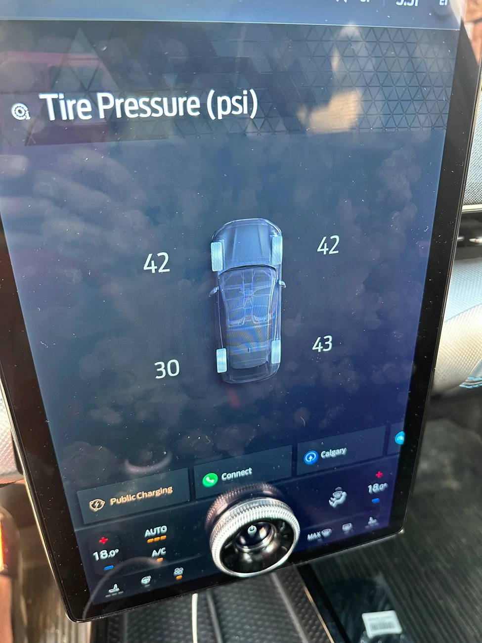

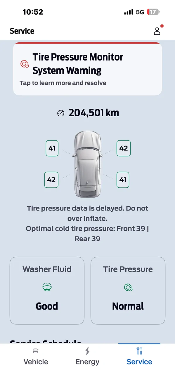

I went for a 5 km drive and here is the display:

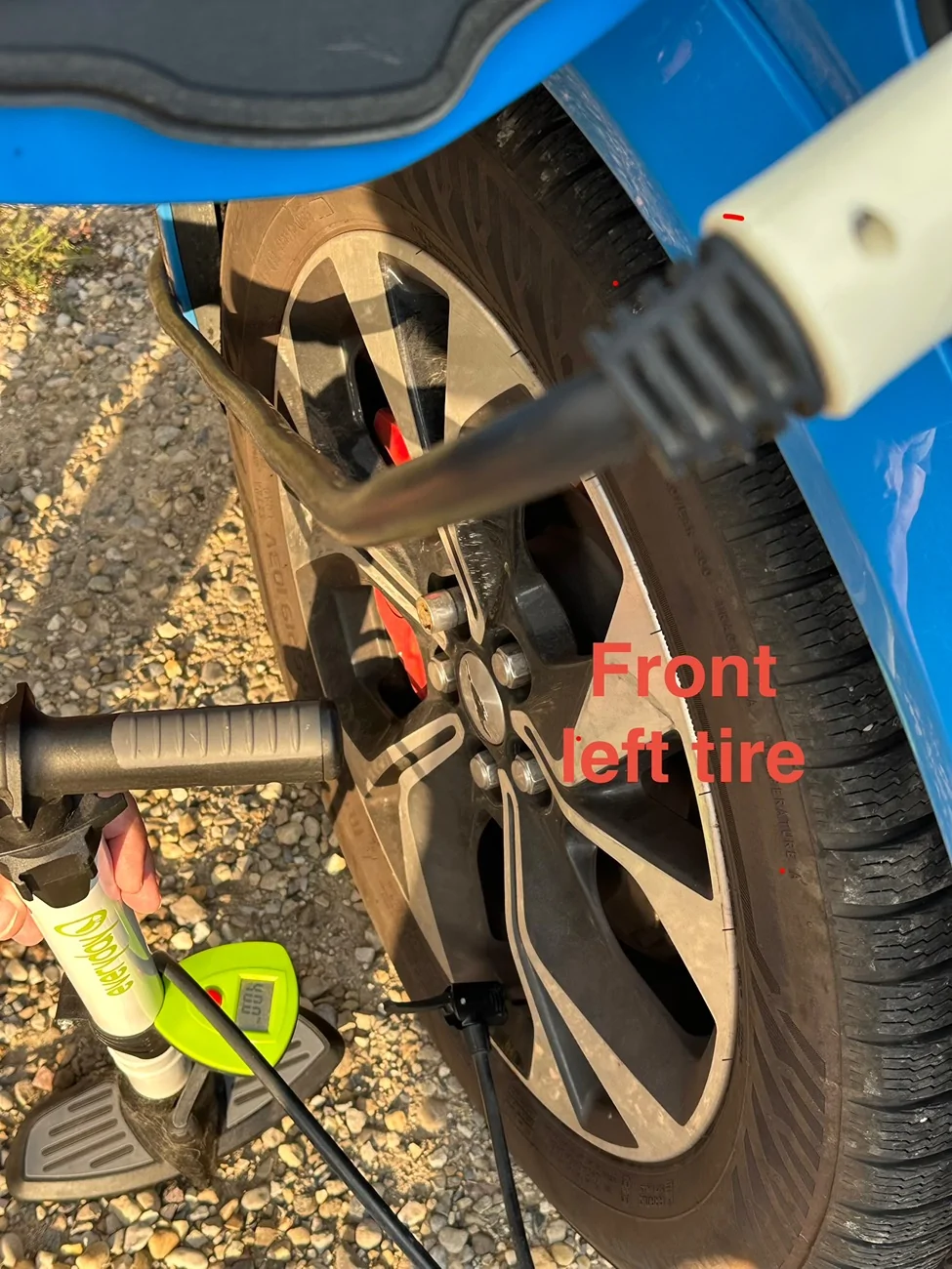

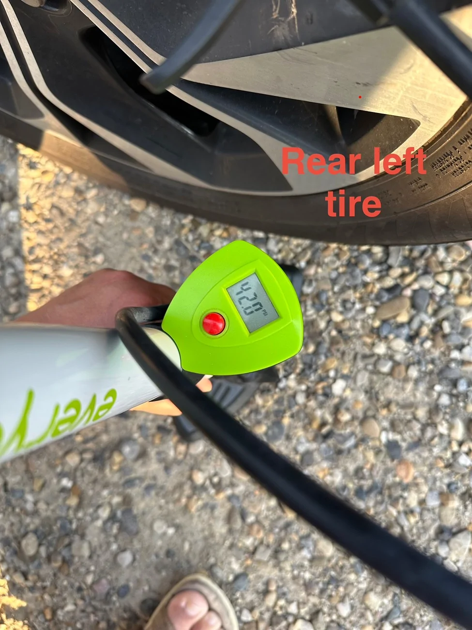

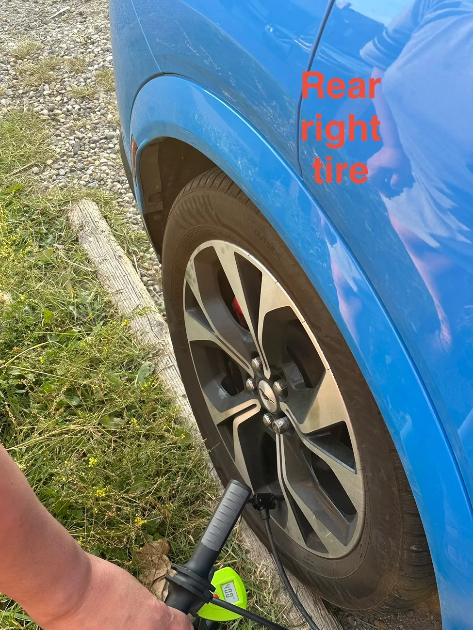

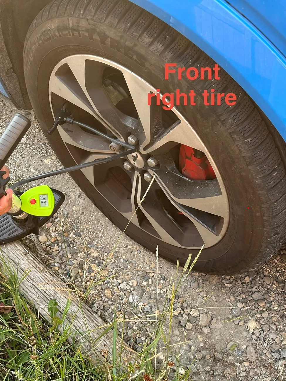

I used the gauge on a bike tire pump about ten minutes after I went for a drive.
Help is greatly appreciated.
Here are the pics:

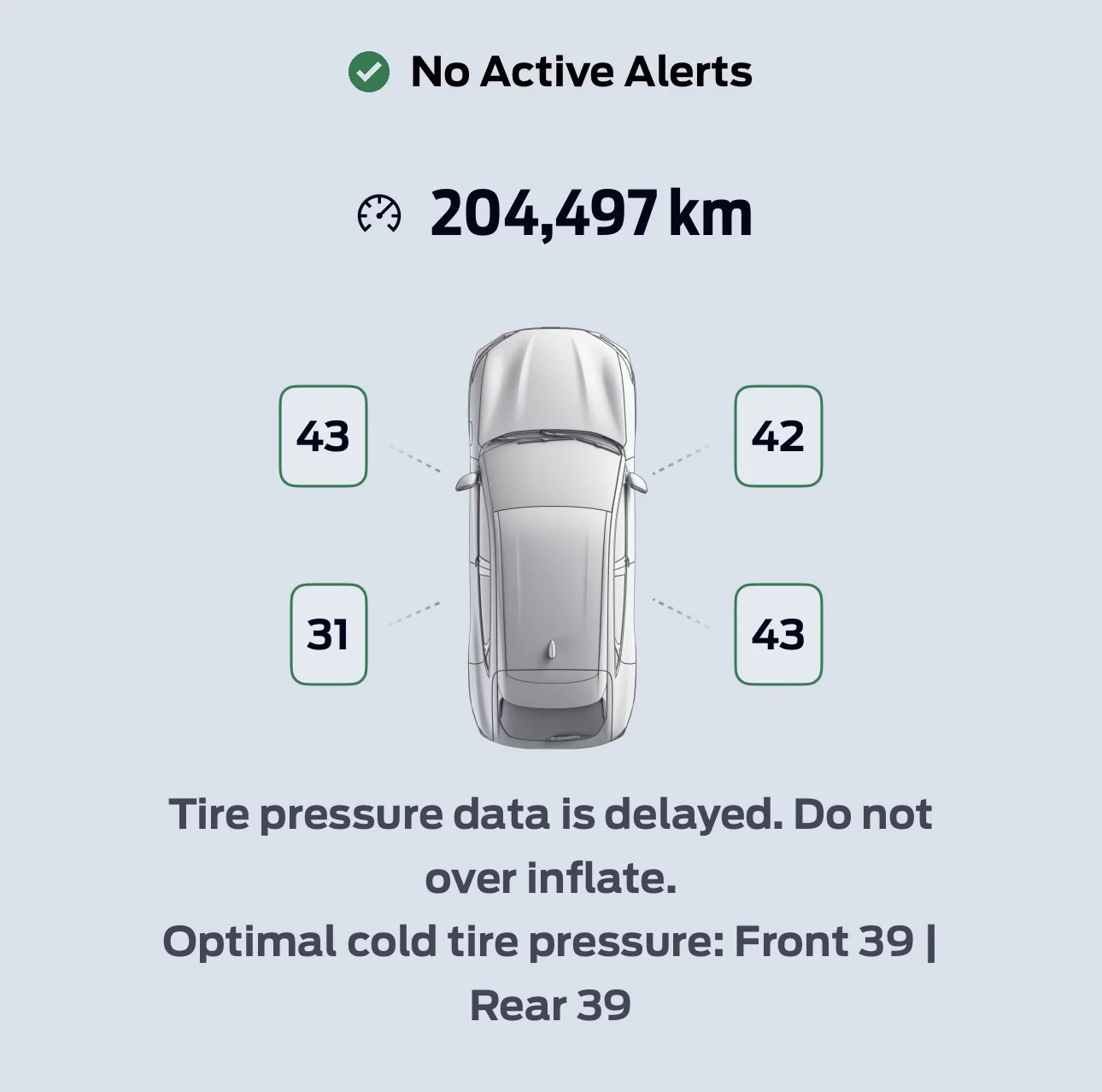

Here is what the app says:
First, I would buy a tire gauge if you don't have one. Everyone who drives a car should have a tire gauge. Not sure what to tell you because I don't know if a bike or inflator will read pressure properly unless you can get a reading before putting any air in. They are also notoriously inaccurate in a lot of cases. You could try a 12V reset, otherwise take it to your dealer. The TPMS sensor may have died or failed.

The outside temperature is 26 degrees Celsius.
Your answer is in the bottom of that picture:
“Tire pressure data is delayed.”
What’s it say today?
