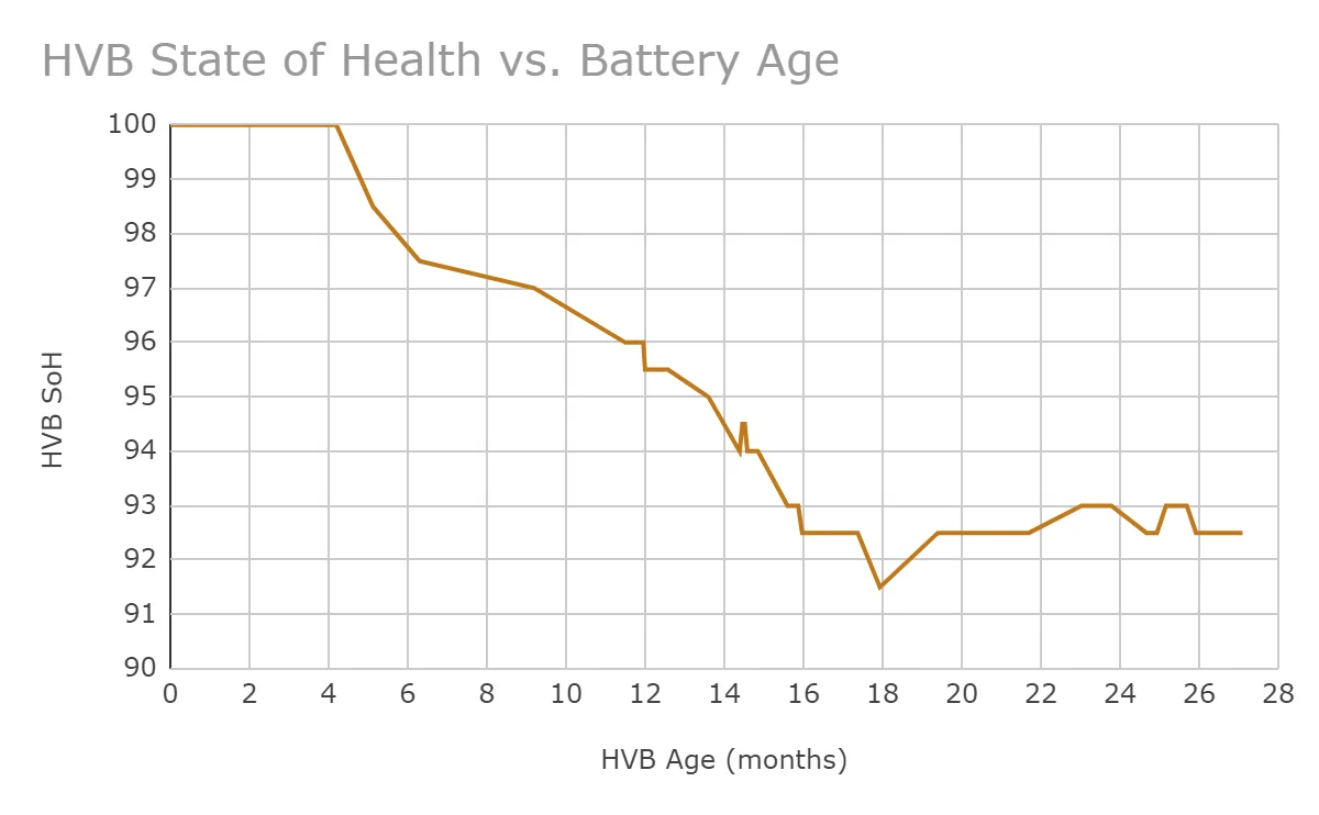

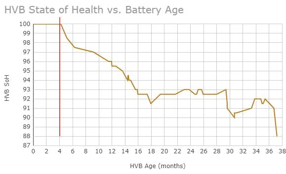

Below the SoH is graphed relative to battery age in months as of today. The red line is the day I took delivery of the car. (Yes, it sat in Mexico for a while.)

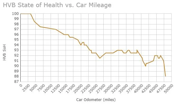

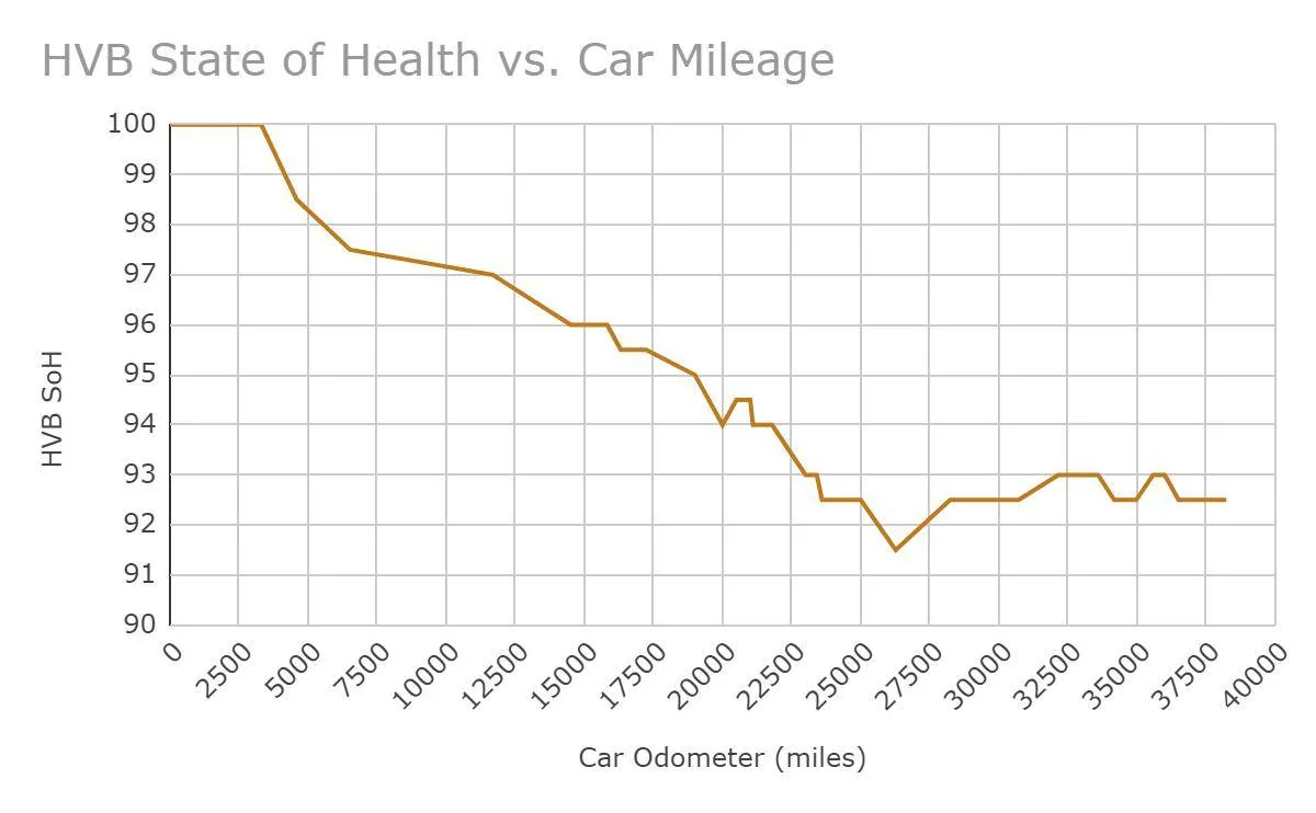

I also compared SoH with odometer mileage. Unfortunately I was not capturing that in my CarScanner data feeds, but until the beginning of October I was using Tronity, which gives me accurate odometer readings until I had to turn it off on 10/10/22 (at 17,659 miles). I really, really miss Tronity, BTW.
After Tronity ended I had to estimate the mileage based on records I recorded in my car maintenance log, which are very few. Today I added the odometer reading to the data I always capture in CarScanner, so going forward I will be able to accurately track SoH (and other data) relative to mileage. And maybe Ford will release an official API so I can turn Tronity back on again!

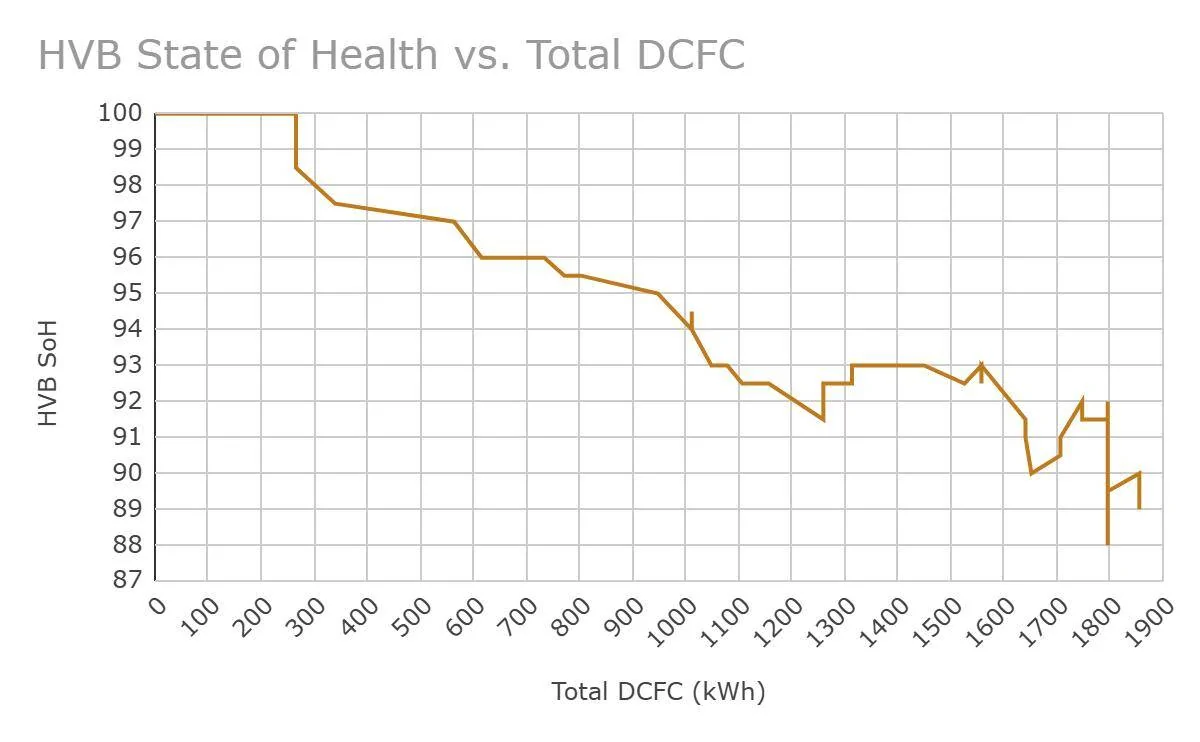

So many people have asked if DCFC could be causing the decline in SoH. So I went through all my charge logs, heavily leveraging Tronity until October, and compared SoH to all the DCFC battery capacity I have added since I got the car new.

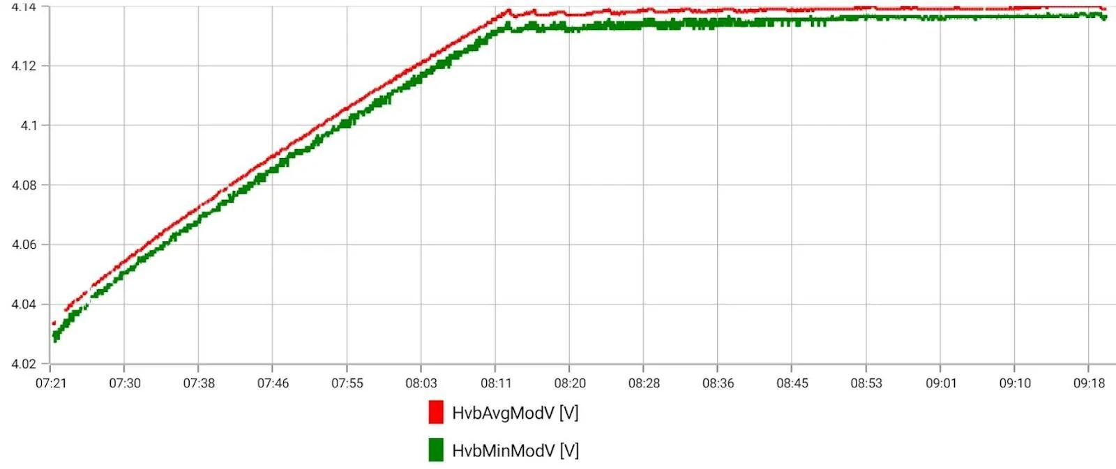

I have also been asked if maybe there is a problem with the battery pack, and so I checked the HVB average voltage with the HVB module minimum voltage, and they are practically the same. Below is a graph of a 100% charge I did this morning, comparing average module voltage with minimum module voltage.

The SoH appears to be best correlated with mileage, and the worst correlation is with DCFC. I think if I spent the time and pulled together all charging events, instead of just the DCFC ones, we would see a strong correlation with total charging kWh. Obviously every mile that is put on the car requires a charge to get there, so that is why I think mileage correlates well. But I have a ton, literally, of charging events. And after Tronity ended, I only have FordPass as a record source, and it only goes back 30 days. Arrg.
I am very interested to see what others are getting for SoH vs. how many miles are on the car.

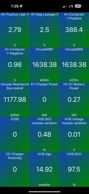

I just rolled over 20,000 miles and this is actually the first time I have looked at the state of health for the battery (97.5%). This is what it looks like after 3 HVBJB replacements and a lot of back road country driving. Maybe just like humans, exercise is really good for battery SOH.
I have the L2 home charger set to 85% and charge when it gets under 50%
I have around 10 DCFC over the entire year of ownership
I charge to 100% on weekends since I do a lot of back road driving Saturday and Sunday
Car is driven daily
