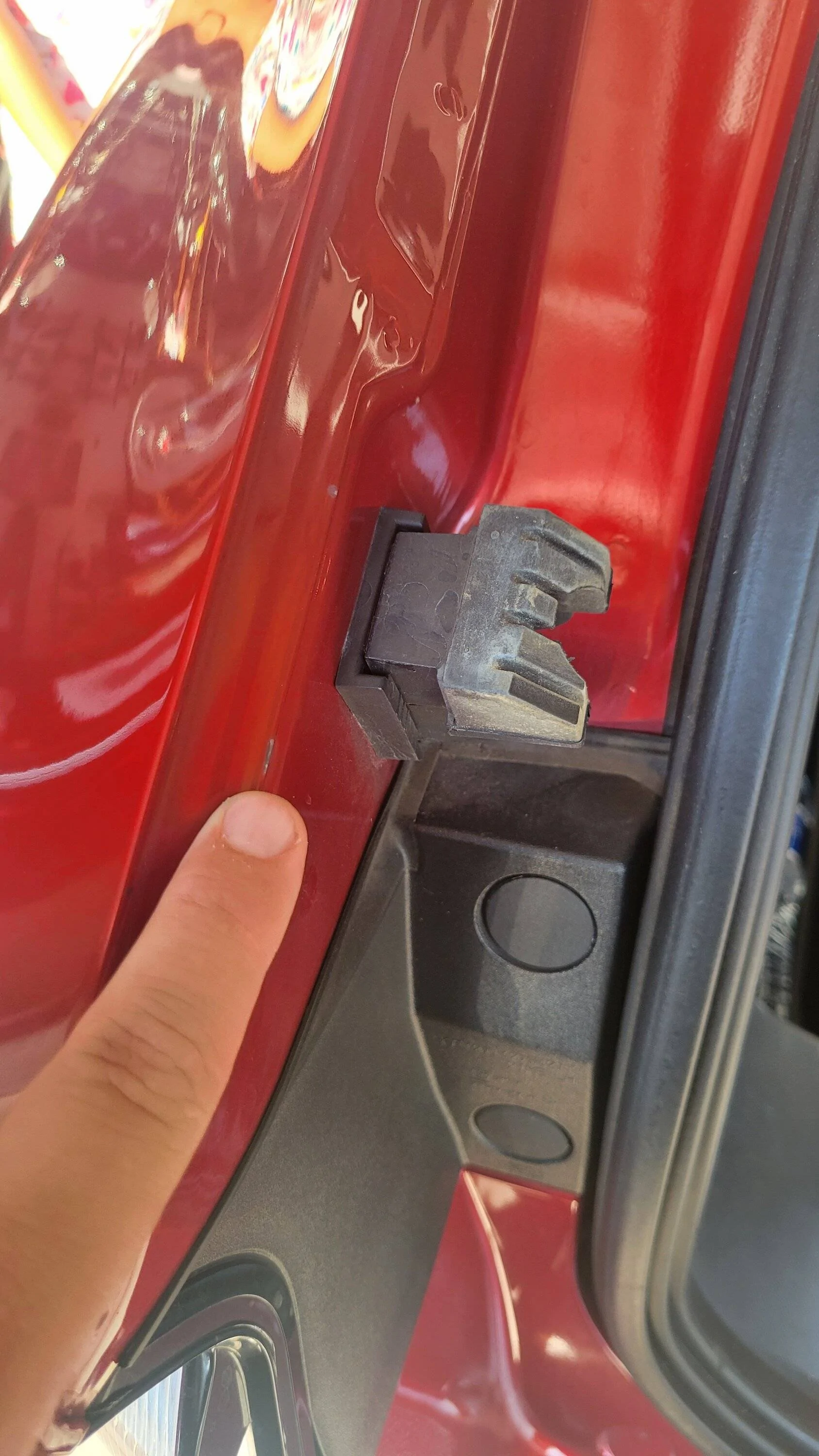

My trunk is hitting in the left side the pinted panel and starts rubbing the paint off. A year ago I asked the dealer about allignment adjustment, they said there is not much which can be done.
Is there anything I can do diy and how would I do it?

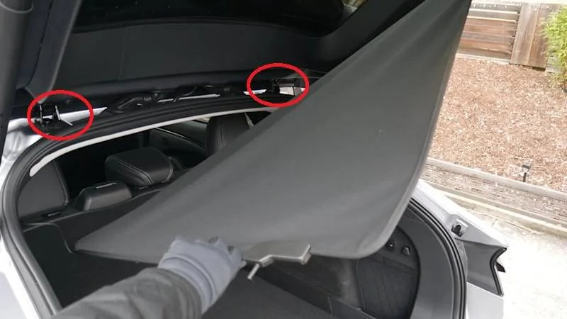

I'd assume the ones up top that actually hinge it up. They're likely what is controlling the position/horizontal level, the lift arms are just along for the ride.
I knew my hatch was a bit crooked and rather suspected that's why the "customer" (... tech at the dealership ...) refused delivery, but now I'm going to have to go inspect for paint damage. Bleh.

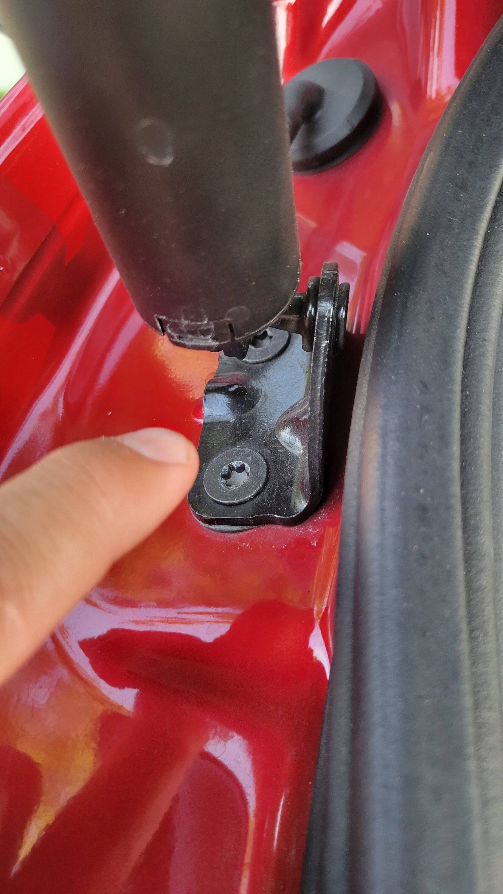

Those are what I used to adjust my gate up as it was too low, but the dealer ended up getting them replaced by a body shop as even at the highest setting the gate was too low and the inside molding rubbed against the inside edge of the frame opening. I would imagine there is a small bit of play L-R, or raising the right side would move the lower left away from the frame.
