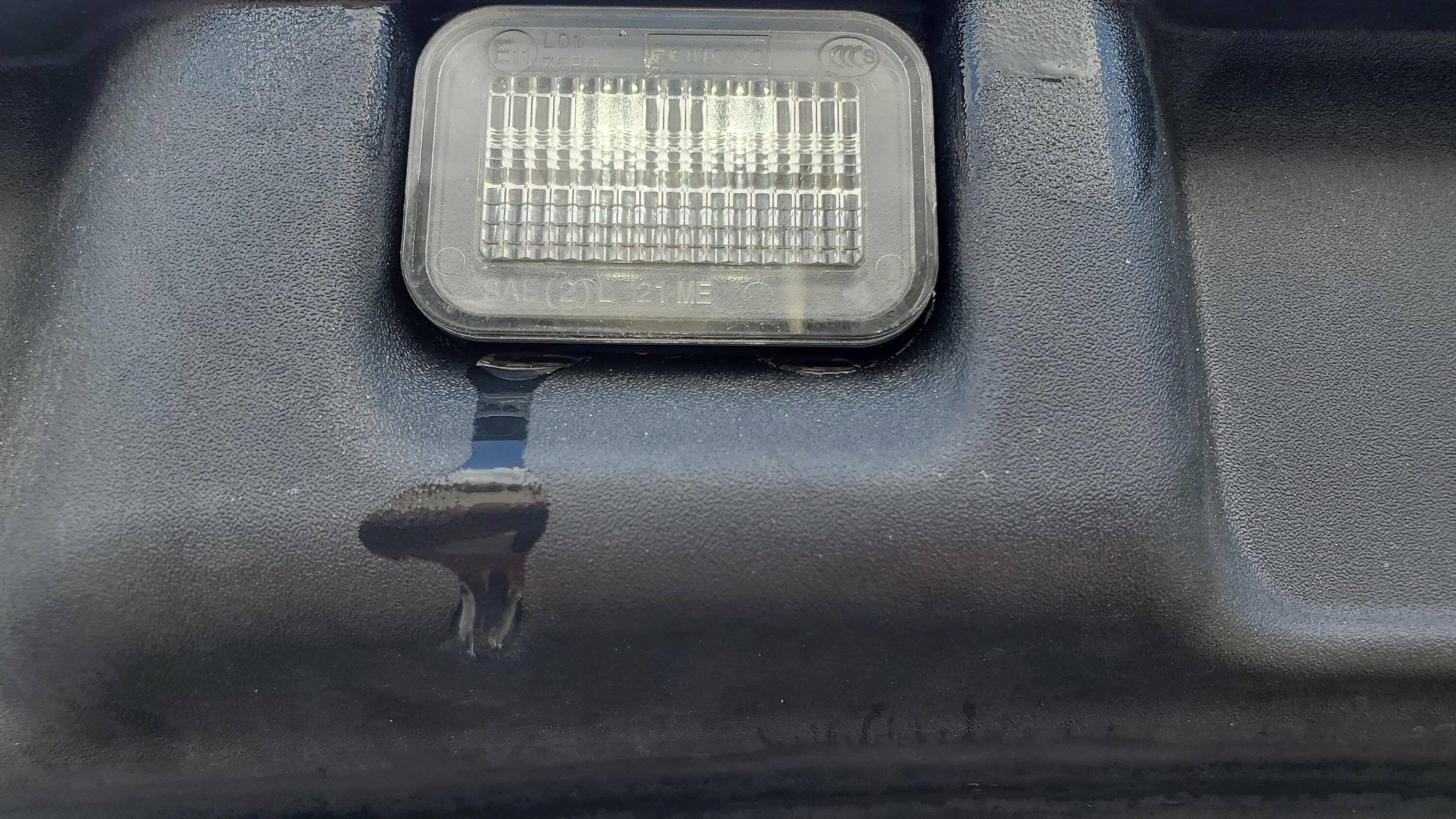

1. Remove the liftgate mounted rear lamp assemblies. Refer to Workshop Manual (WSM), Section 417-01 > Removal And Installation > Rear Lamp Assembly > Liftgate Mounted Rear Lamp Assemblies.
2. Determine which lamp cavity has been leaking by inspecting for water trace. (Figures 1-2)
3. Using butyl sealant tape, create a bead around the lamp cavity where the leak was present. (Figure 3)
4. Reinstall the liftgate mounted rear lamp assemblies.
