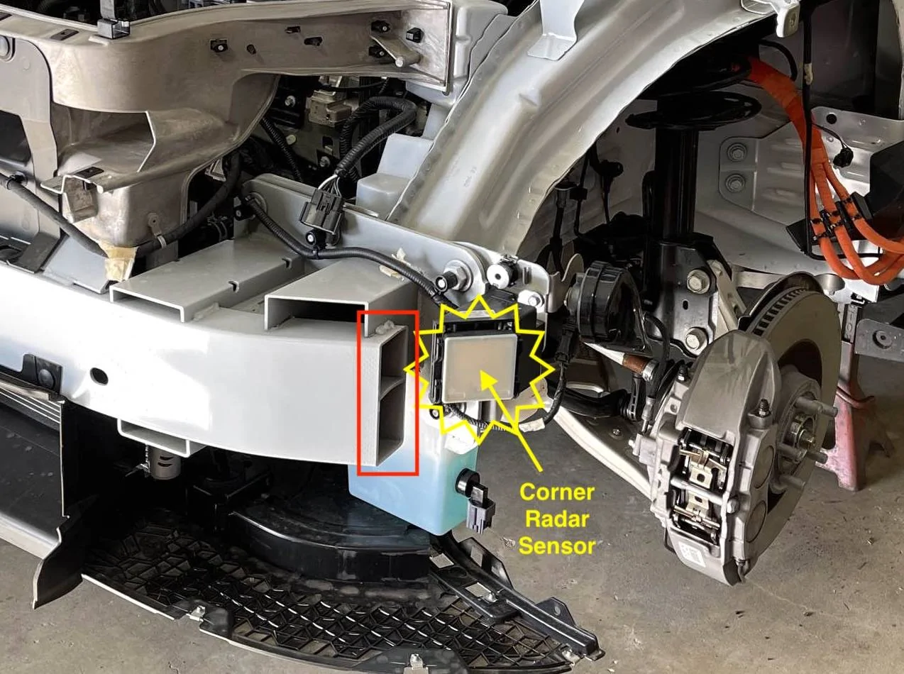

Well this is an interesting one. Some vehicles may experienced unintended or "phantom" braking using adaptive cruise control or BlueCruise when there are no cars in front of you. This may be due to unwanted radar sidelobe reflections hitting the front bumper which is positioned directly behind the front corner radar sensors. The front bumper can act as a waveguide and direct radar signals to the opposite side of the vehicle, and potentially allow the two front corner radars to interfere with each other, or pick up objects to the side and rear of the vehicle. The fix is to cover the open ends of the front bumper (red) with aluminum foil tape, which should prevent unwanted signal ingress. The front corner radar sensors are positioned below the headlights at a 45º angle relative to the vehicle axis and are used to detect vehicles in adjacent lanes for the assisted lane change and lane shift features of BlueCruise.
I will also mention that a damaged front adaptive cruise radar sensor (located centrally between the grille shutters) can also cause phantom braking if the sensor bracket is broken and the sensor is no longer aligned perfectly vertical. This can occur after a mild impact to the front bumper (such as being backed into, or hitting the chin on a curb). Issues with the front sensor may cause a false "car ahead" icon or braking associated with hills. I would recommend inspecting the front radar bracket during this repair as well to rule that out as a potential cause.

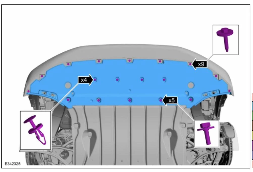

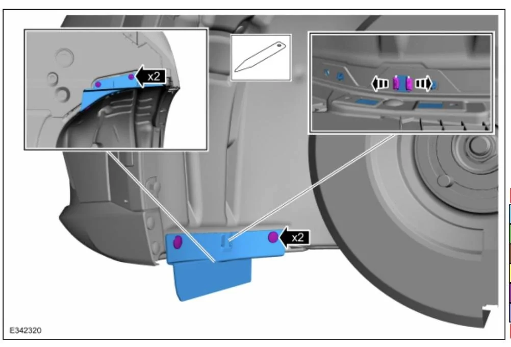

2. Remove both stone deflectors and the lower air deflector to gain access to the front bumper from underneath. Refer to WSM, Section 501-19 > Removal and Installation > Front Bumper Cover. Perform only Step 3 and Step 8.

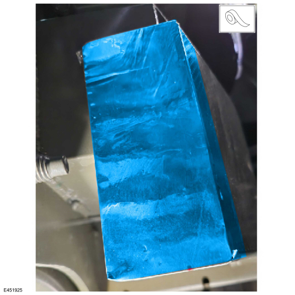

4. Using a minimum 2 in. wide (50 mm) by a minimum 6 in. long (150 mm) piece of aluminum foil tape, place the aluminum foil tape over each of the open ends of the front bumper as shown in Figure 1.

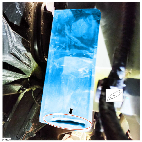

5. Cut a long opening into the bottom of each of the aluminum foil tape on each front bumper end to allow a drain path for moisture as shown in Figure 2.

6. Install both stone deflectors and the lower air deflector. Refer to WSM, Section 501-19 > Removal and Installation > Front Bumper Cover. Perform only Step 3 and Step 8.

All that is required is to remove the stone deflectors on either side and the lower air deflector. There is no need to remove the entire bumper cover although I think it would be easier to fix this bumper issue if the cover was off. I've taken mine off a few times and it's not difficult at all.
