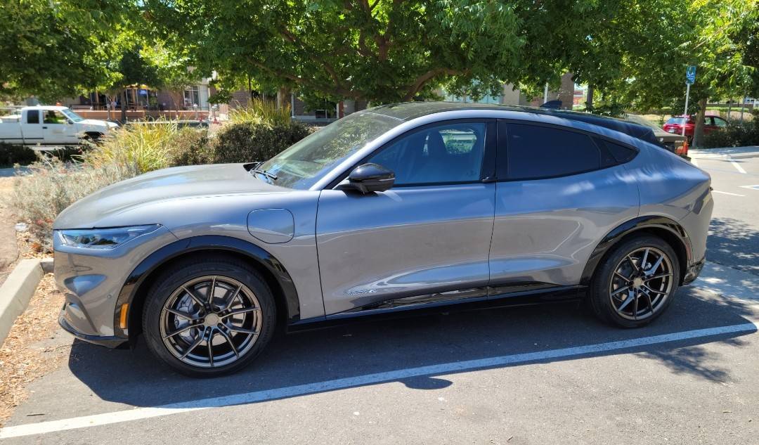

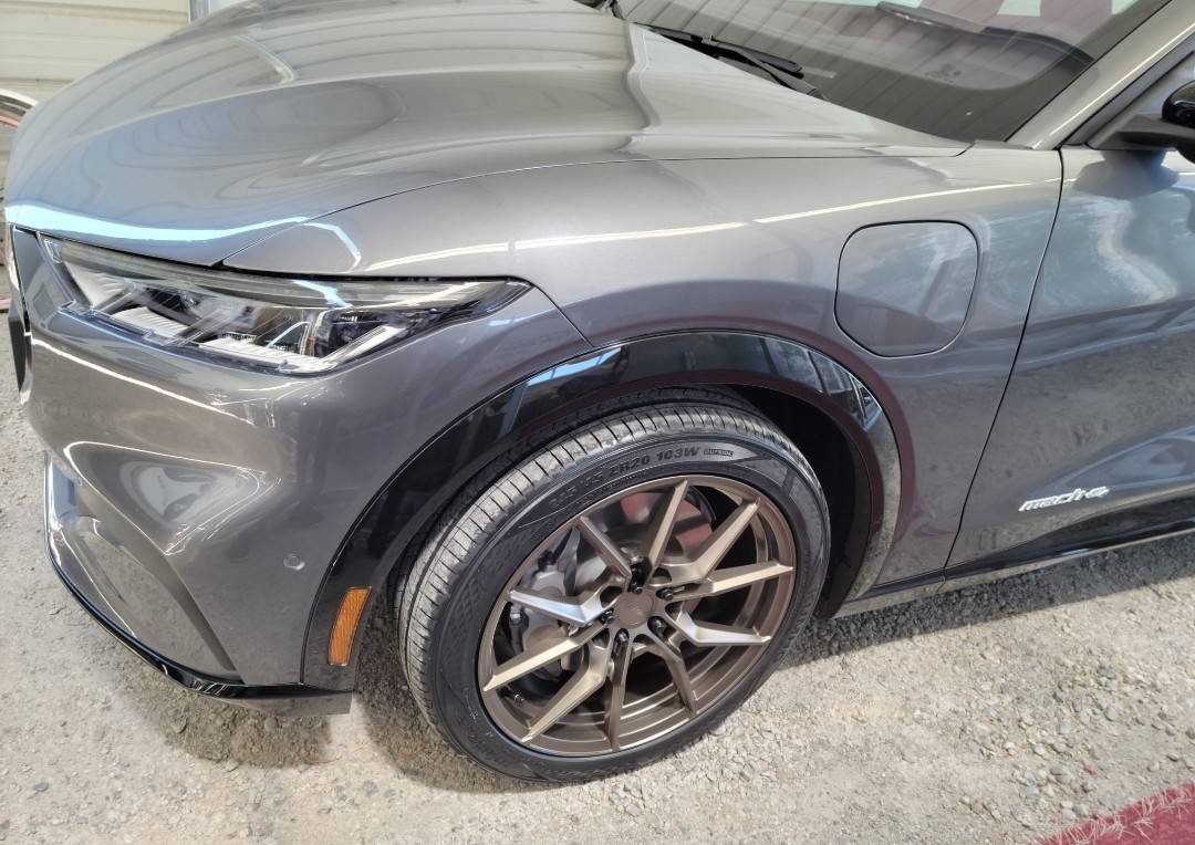

Just got my wheels put on! I was a little worried because no one could confirm fitment but I researched what should fit and gave it a shot. These are actually bronze but look different in the sun. Wheels and lug nuts bought from Custom Wheel Outlet and tires/tpms from Tire Rack and a good price! No centering rings were needed because bolt pattern was hub centric.
Wheels specs:
20"x8.5" with +40 offset 72.1 CB TSW Neptune Rotary Forged (24lbs) with 245/45ZR20 Kumho Majesty 9 Solace
Small diameter black lug nuts with locknuts to be installed soon
New TPMS sensors that auto-programed
