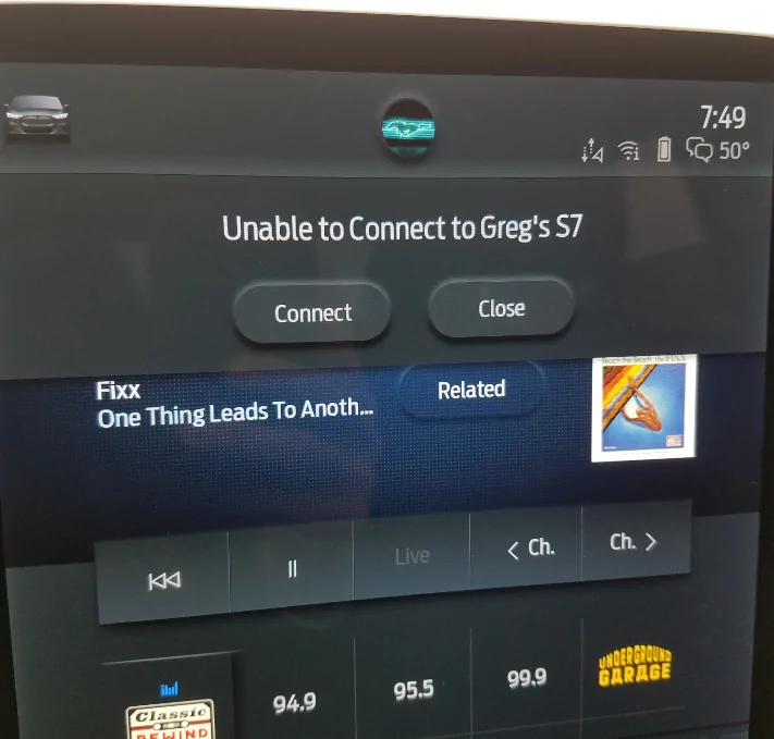

Have been getting this message often and it is VERY annoying because it stays there on the screen until I touch one of the two buttons. Usually, my phone reconnects automatically but this message still stays on the screen. At first I thought maybe the problem was coming from my wife's phone because this message started appearing after we paired her phone to the car. I deleted her phone, message still appears. Then I thought maybe the phone was having some problem with the wireless charger and/or bluetooth so I plugged it in and it seemed to remedy the issue but the issue persisted (just far less frequently).
Now I can duplicate the fault. If I log out or force close FordPass then I never get this message. If I turn on FordPass then the message will appear about every 3-5 minutes of driving.
So, I have to make sure FordPass is not running to avoid this message.
