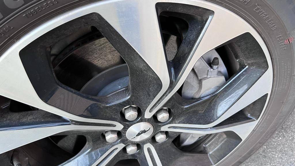

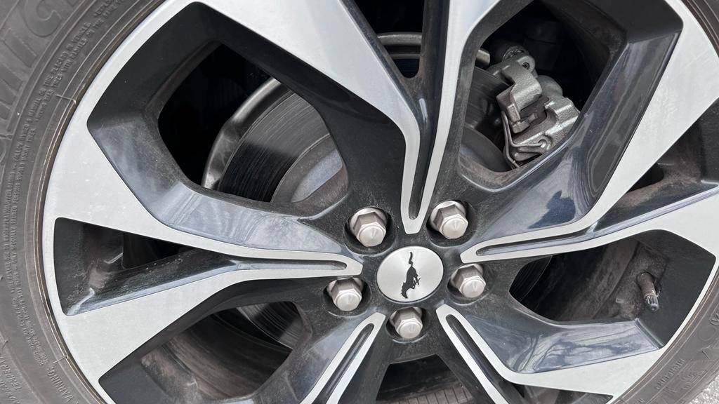

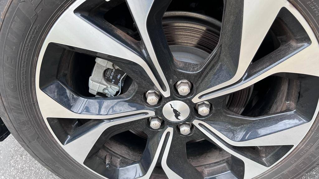

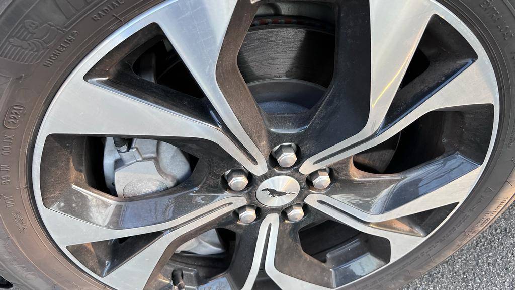

My wife's MachE has only 1200 miles and less than 3 months old.
One right rear rotor has scrape marks.
There is another rotor with much less markings and two without any wear.
No noise or performance issue but I wonder if break pad is wearing uneven on the rotor with heavy markings.
I can take it to the dealer but they are not very good (no loaner, last time kept the car for 2 days and nothing for headlight issue, still no replacement part)
Anyone have seen this on their car?
Does it needs to be checked by the dealer?

Third image has most markings, fourth has some..
First 2 shows no wear...
Thanks

There should not be grooves in the rotors, if that is the case it has to be bad calipers. Rust and corrosion is possible, but that should not result in grooves, especially not across the entire surface of the rotor, which is the case in those pictures.

Get the Route 1 Wheels and you will never worry about it again……lol. Mine look the same after a Maine Winter.

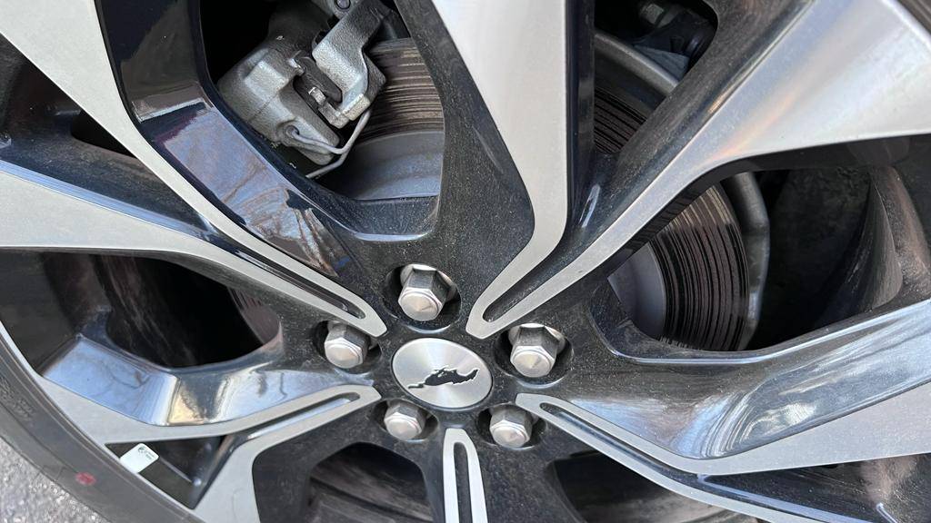

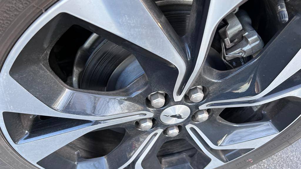

Update...
I drove car today on back streets.
1PD OFF.
Did braking at least 10 times (some light, some heavy, medium for long stretches etc.)
I don't think it made significant difference.
Both are rear wheels.
Rear passenger is worse.
I think rear driver one cleaned up a bit with braking.
When weather is warmer I may try to clean the rotor myself...
Though I may take up Ford's to see if the dealer can fix it...

You can see if they’ll resurface the rotors under the TSB for the brakes. They’re supposed to look for stuck pad material on the rotors, but you may get lucky.
