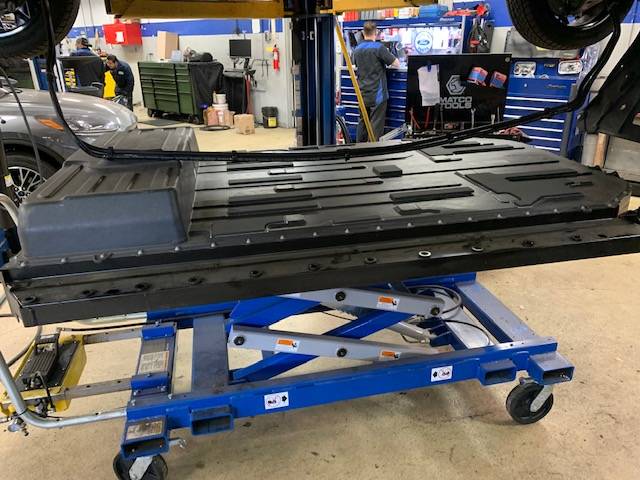

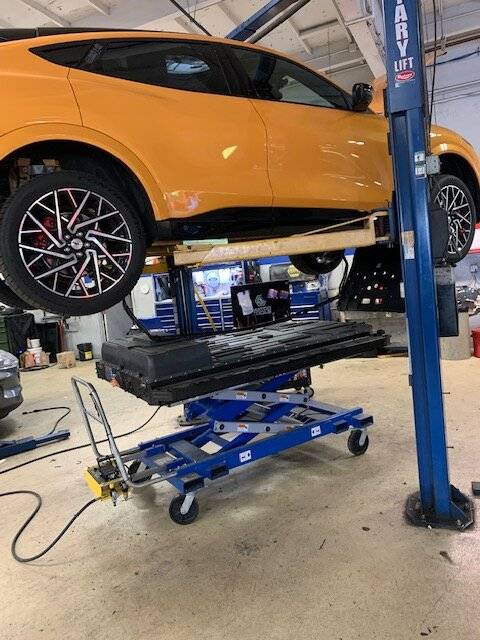

Not sure the repair is going to be done today yet, but I did get these cool photos first thing in the morning from my service advisor.

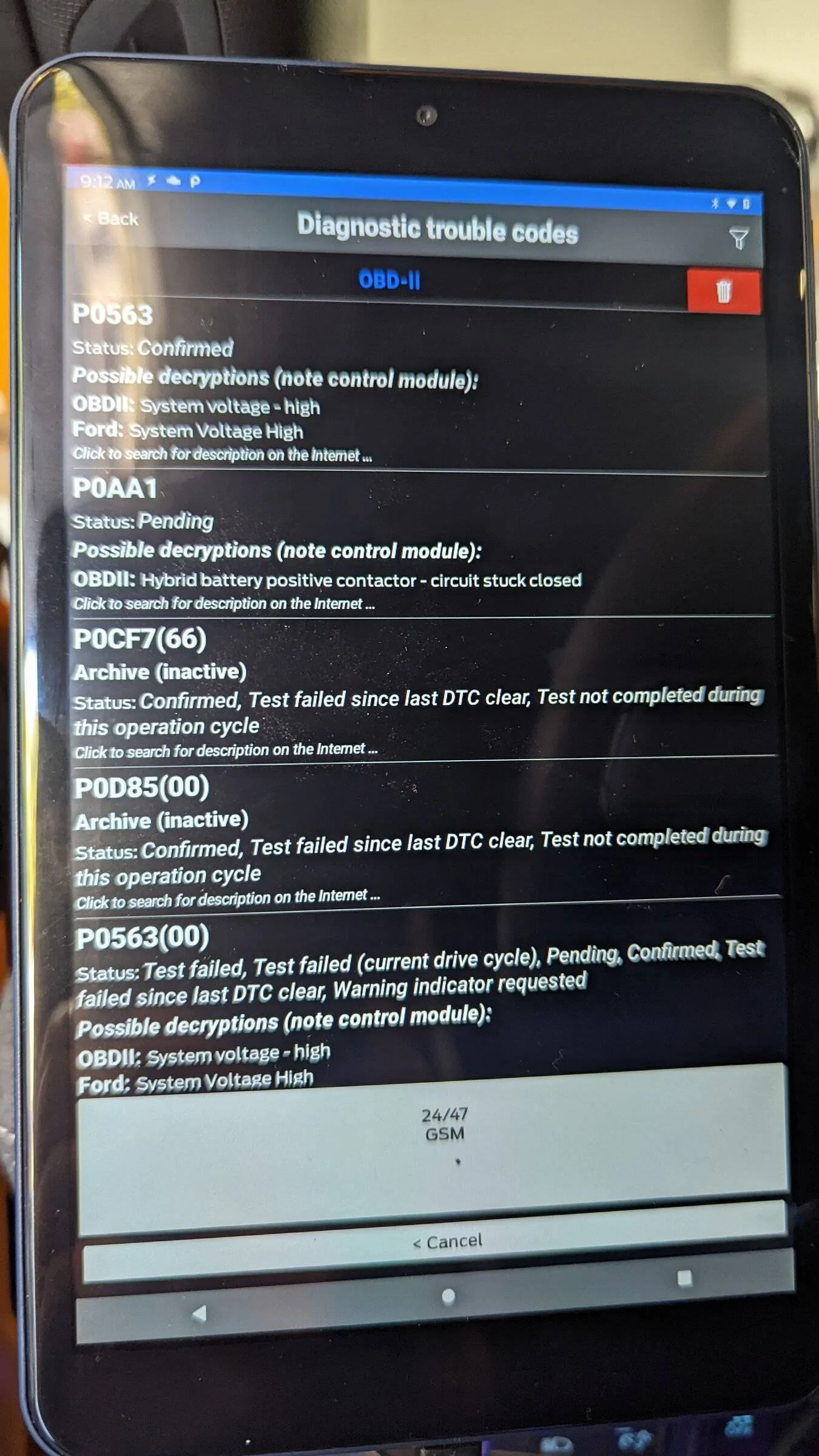

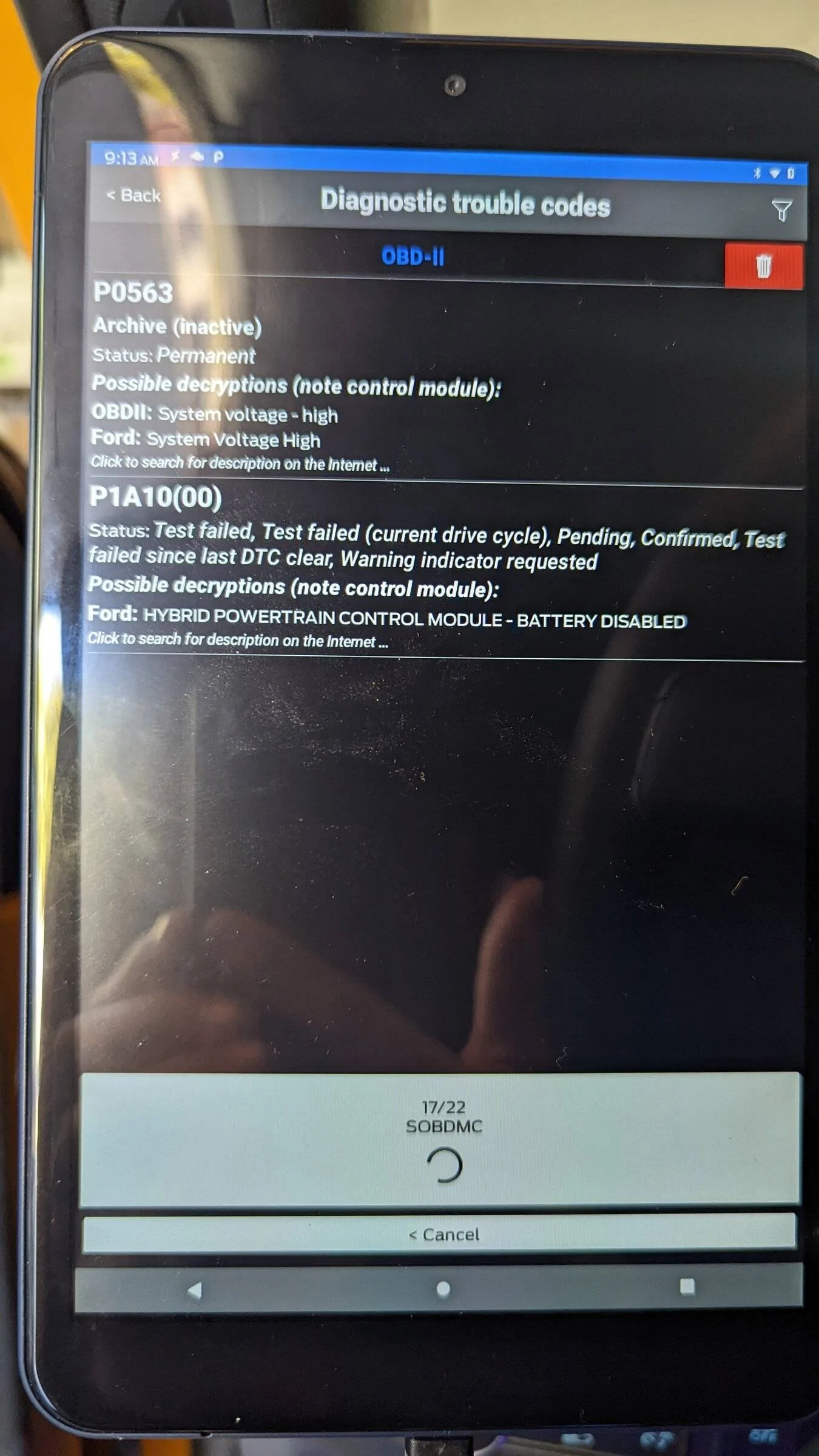

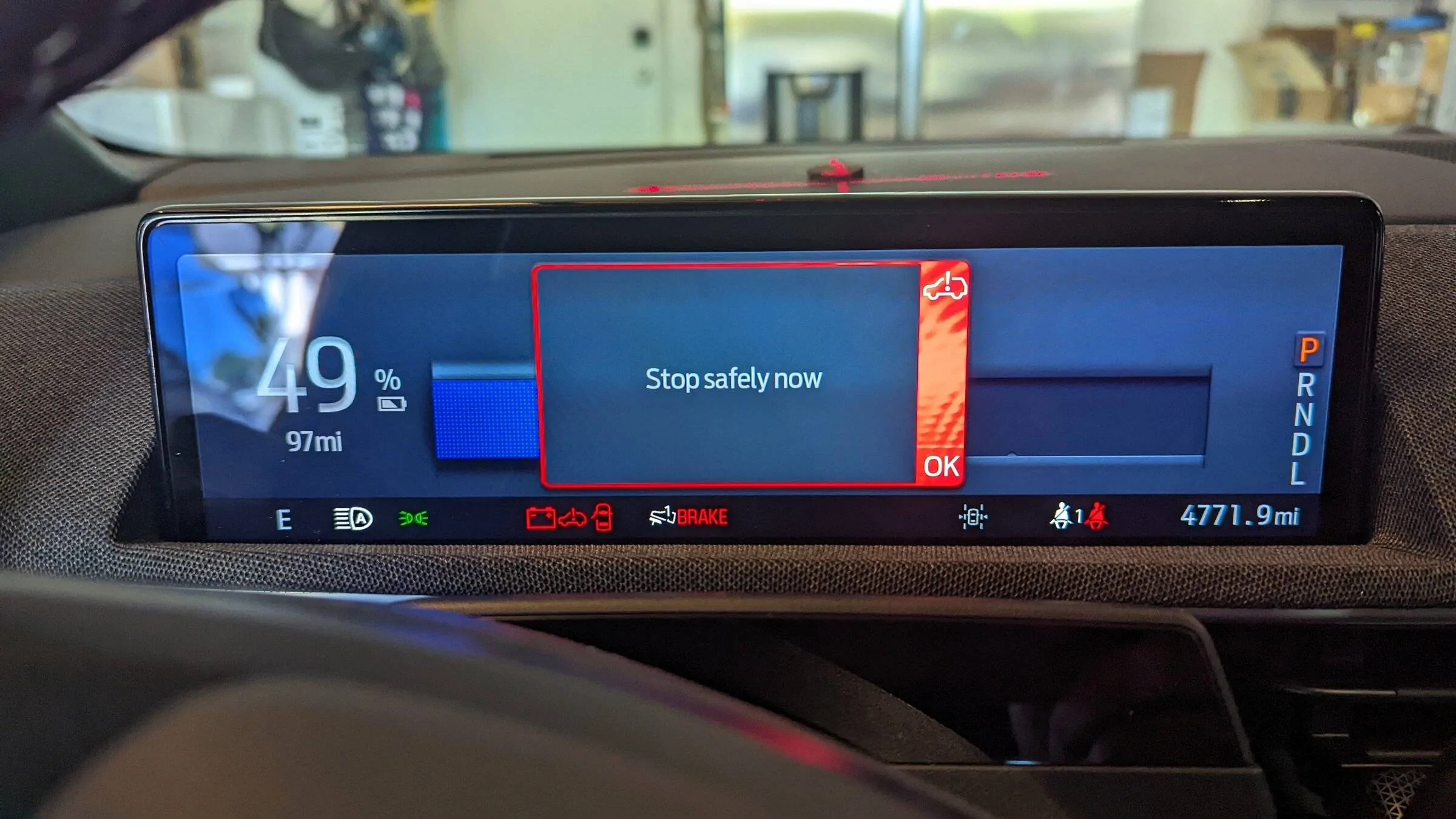

Got a red ring of death when I plugged in, with a charge fault on FordPass. I went in the car and saw:
Pulling the codes showed:
Clearing the codes did not solve the problem, and showed my HVB is disconnected:
My car has every available update including new charging curve so this is absolutely not a software issue. Also, it's not cold at all here, it's basically weather paradise. This is definitely a faulty batch of part(s) and I bet will be a recall.

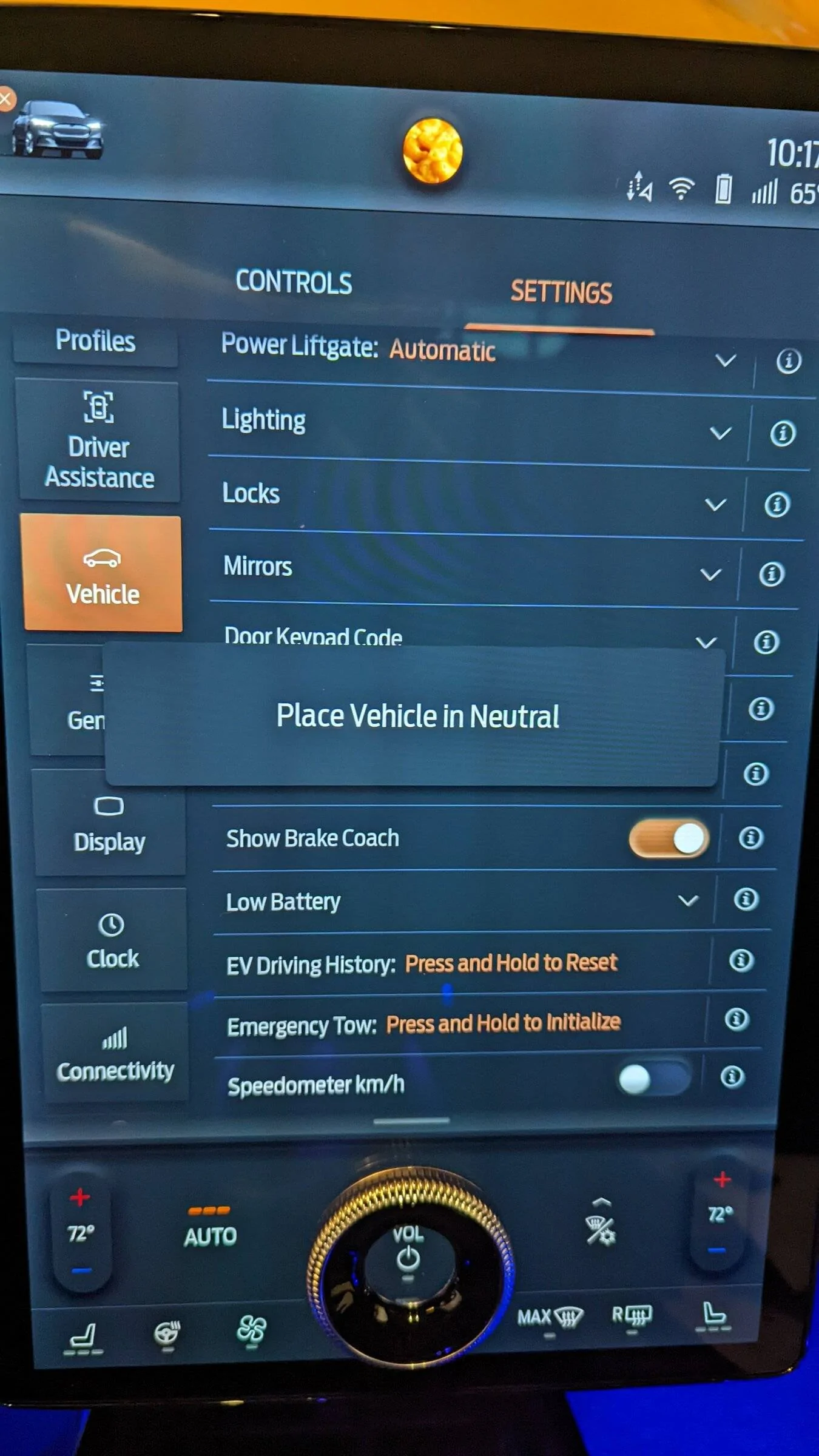

I'm really glad this happened in my garage and not on the road with my family -- but I'm also wondering how we're going to flatbed my MME out of my garage where it's parked tow-point nose-in. My driveway is also on an incline so this will be "fun".
My current game plan is to see what the hive mind here thinks about what dealer to get it towed to today, and contact the service department of said dealer tomorrow morning and arrange for the tow.

It turns out that it was my High Voltage Battery Junction Box that was fried. BECM was fine:
Sunnyvale Ford was not a good sales experience, but they were great for this repair. Anderson was a good service advisor and they kept me very informed via text messaging all the time. It was under 5 days from the tow to return of my car. Yay! Hopefully the new part is more robust....
