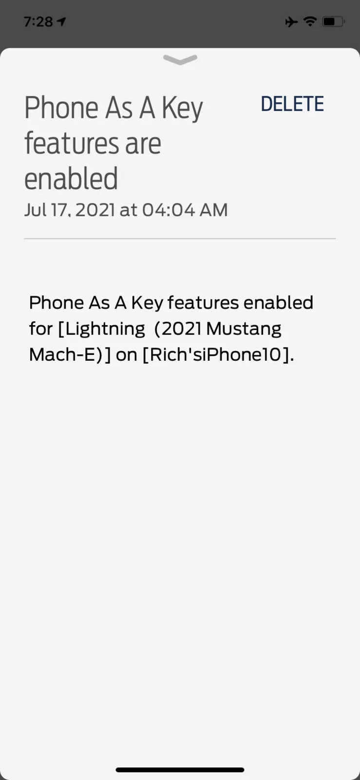

I believe you need a fob in the car AND your phone to set up PAAK, I could be wrong but I recall my dealer saying that……. Glad the code worked and you are on your way…..for sanity sake, I reentered my code yesterday!
yes, you need both phone and fob in car to re-install and activate PAAK.... It can be a total PIA if you have a partial install because you have to be sure to delete and remove and re-install Fordpass from phone as well as existing PAAK and BT connections from Sync in the vehicle when starting over for a 'clean' install as if you just took delivery.
Once you get thru the re-install, activate PAAK, and set up BackupStartCode.... you *should* be all set.
