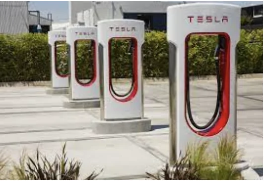

You cannot use Tesla super chargers at all. Those are DCFC and there is not an adapter for that. The Tesla adapters are only for the level 2 chargers, referred to as destination charger. These are most commonly found at hotels and airports where you can plug in for 8-12 hours at a time.
Tesla chargers are either destination chargers, or super chargers. They don’t do both.

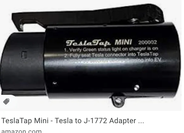

I don't have my car yet (SOON), but I already have a Tesla Tap Mini. The Tesla Tap just seems like a good thing to keep in the frunk for when you need it. A lot of hotels have Tesla wall chargers for destination charging but may not have J1772 chargers. Keeping the adaptor in the charge bag just seems like cheap insurance.

I went with the TeslaTap at the advice of my electrician, but there are tons on the market and available in Canada, I would guess. The TeslaTap version of adapter is much less bulky and as such, a bit more expensive. Both our Tesla and Mach-E are extended range batteries and all of the charging we do has been at home. Commutes to work are 20 and 30 miles each way and even at that, plenty of charge left each day to run errands. I live in the SF Bay Area, CA and gas here is north of $6 and I'm really looking forward to getting rid of my Jeep which is close to $100 each time I fill that tank.

I use the Tesla-Tap adapter:
http://www.umc-j1772.com/index.php?route=product/product&path=17&product_id=99
These come in various amperage ratings. The Mach-E can charge on 240v AC power at speeds up to 48 amps. The 50-amp adapter would cover you. But if you consider the adapter as something for "you" rather than one of your specific cars (e.g. what if you get a different car ... would you keep the adapter) then you could get the 80-amp. This is overkill for a Mach-E ... but not for an F-140 Lightning -- which has dual 40-amp onboard chargers that can charge at 80 amps if the power is available.
Tesla-Tap adapters have a nice feature (I don't think the Lectron has this feature). The Tesla Destination Charger can be put in a Tesla-only mode vs. a J1772 mode. The diffference is the communication protocol between the wallbox (EVSE) and the car -- not just the physical plug design. In this mode the Lectron adapter would fail. Tesla Tap has logic in it that understands both J1772 *and* Tesla's proprietary mode. This means you can use it to charge ... even on Destination Chargers that have the J1772 mode disabled.
To make that work, the order in which you connect things matters.
If J1772 mode is enabled on the Tesla Destination Charger, then connect the adapter to the Tesla charging cord FIRST and then connect to the car 2nd. You can do this right away.
If J1772 mode is DISABLED on the Tesla Destination Charger, then still connect the adapter to the Tesla charging cord FIRST ... but wait 30 seconds ... and THEN connect to the car.
The Tesla-Tap gets owered up by the cord, attempts the J1772 negotiation -- which fails (because the mode was disabled by the Destination Charger) then flips to Tesla mode ... and this takes about 30 seconds for it to time-out and switch modes. At that point you can plug in and the adapter will work.

That's the Lectron brand. It will work on a Tesla Destination charger as long as J1772 compatibility mode is enabled. The Tesla-Tap brand will work on any Tesla Destination Charger regardless of whether J1772 compatibility mode is enabled.

When I bought my MME this year, I purchased the TeslaTap Mini adapter (60 amp). Even though my system is set up to charge at 40 amps maximum, you need the 60 amp adapter. It has worked flawlessly ever since.
I looked at the other adapters on the market such as the Lectron, but decided not to be "penny-wise and pound-foolish"...

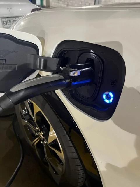

The garage has 20 Tesla level 2 chargers. I use the Tesla Tap 60 mini frequently with no issues. It charges at the full 48 amps that the car will except. The adapter and cable feel warm while charging. Not hot.
I am glad I went with Tesla Tap rather than the Lectron.
Have you tested this? When I asked the folks at TeslaTap, they said it wouldn’t work at a Gen 3 destination charger if it’s set to only allow Teslas. I haven‘t been able to find one to test it.
