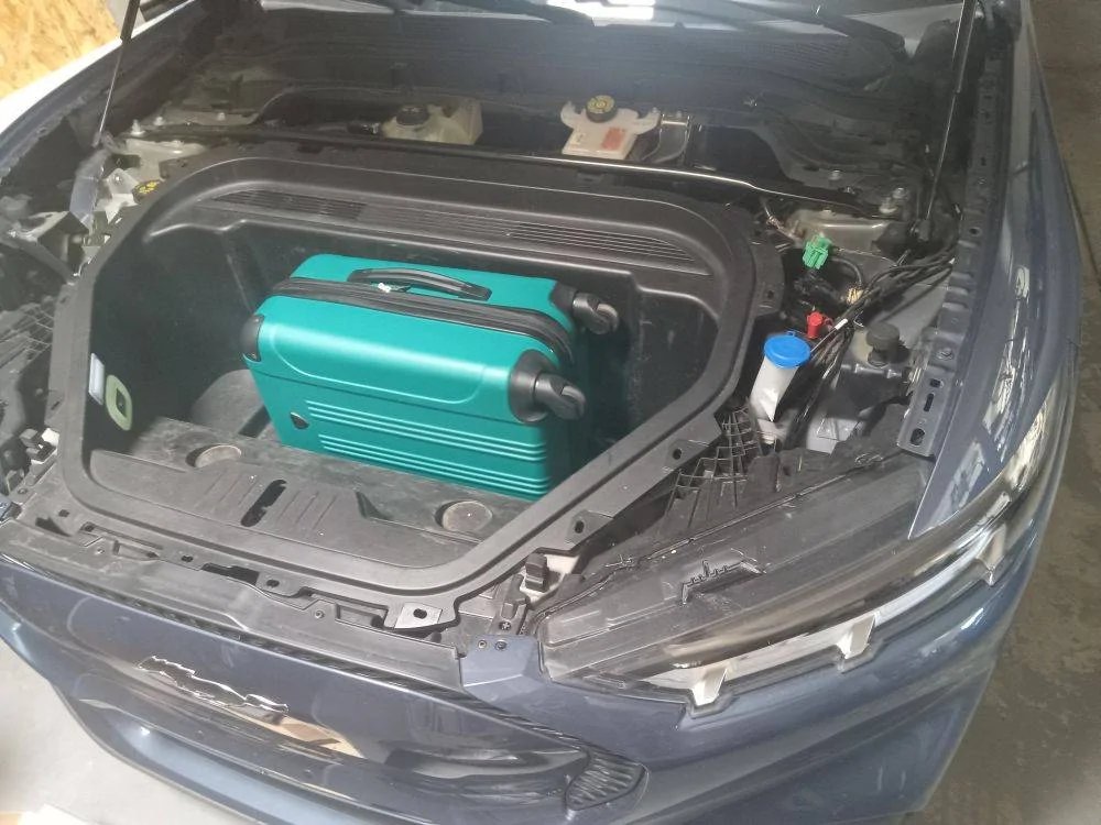

I used to have a '66 Sunbeam Tiger.... headers, big cam, dual point ignition, etc.... damn thing ran HOT, but in the old days the top of the motor was uncluttered, and you could fit a good sized baking dish right on top between the carburator the radiator expansion tank such that it wouldn't slide around even while driving 'hard' thru the mountains. The club had a great recipe book and timed tours to cook various dishes; and we'd all meet and potluck wonderful hot meals from under the hood... without a Frunk.
This of course is leading up to what we can cook (or refrigerate) with our Mach-e with the lovely big batteries on board.....

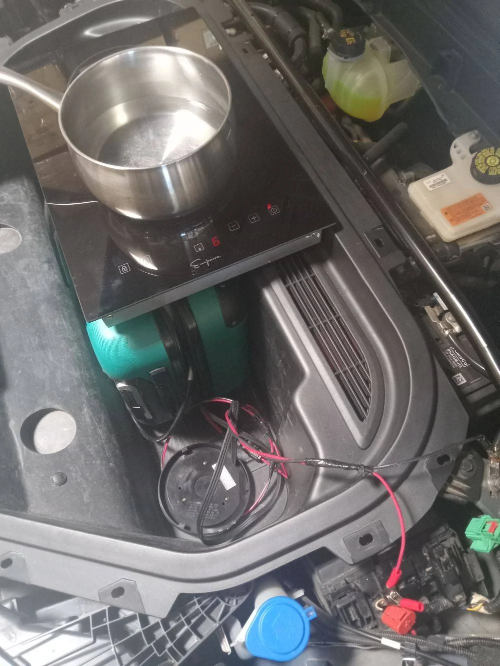

Turns out that if you disable your 'auto-off' setting, and leave the MME 'on', you can extract about 1500 watts of power from the LV (12v) connection points which is backed up by your large main (HV) battery. Plenty to run a little refrigerator, teapot, or even an inductive cook-top. Perfect for 'flameless' camp cooking as well as running lights, CPAP machines, recharging cordless tools at job sites, etc.

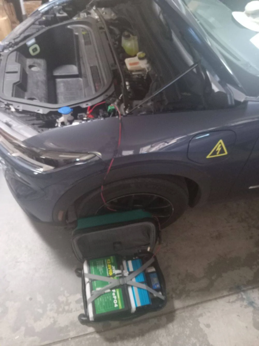

- gain access to your LV connection points... easy with a 1-7/8" hole saw, or removing the 'beauty covers'.

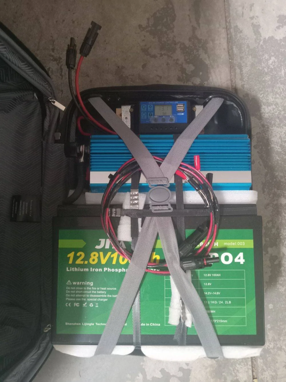

- 1500 watt pure sine inverter, buffer battery, charge controller, cables.... and it's possible to package everything into a carry-on bag for truly portable power! Cost less than $200
There are commercial power packs available, but they cost significantly more for less battery capacity and probably less power. If you shop for portable power packs, make sure the inverter is 'pure sine', and 1500watts. I have found that there are several brands of Lithium battery you can get for under $400 for a full 100ah capacity yeilding about 1 kWhr of useful energy. The battery can be charged with an inexpensive charge controller via a little solar panel, or direct from a running vehicle.
You can hook up with jumper cables for quickest/cheapest solution, or package a few more bits into a 'portable power pack' that you can charge with your MME.
