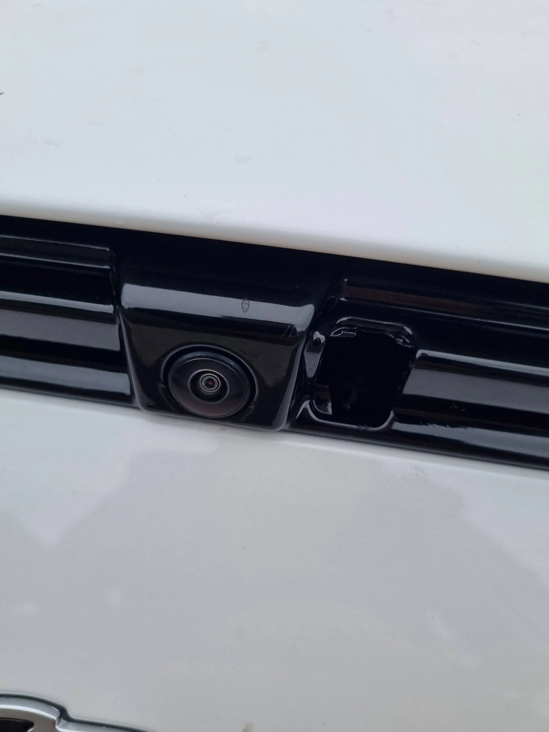

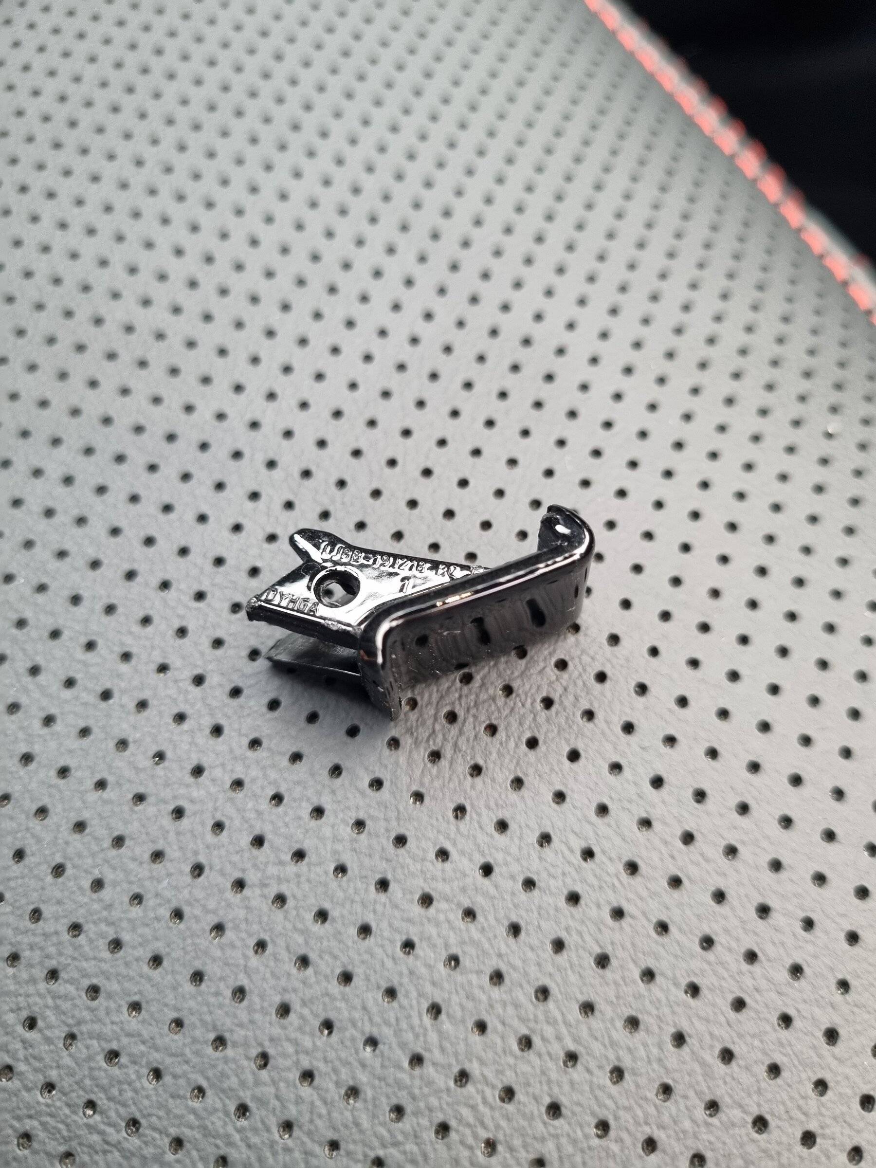

Washed the car and noticed it just hanging there, snapped off completely.
xingusx Well-Known Member First Name Ingus Joined Jan 8, 2022 Threads 9 Messages 45 Reaction score 73 Location Uk Vehicles Mach e AWD Extended Range Occupation Ops Director May 12, 2022 Thread starter #1 Washed the car and noticed it just hanging there, snapped off completely.
Murse-In-Airy Well-Known Member First Name Rod Joined Mar 5, 2021 Threads 74 Messages 3,403 Reaction score 7,646 Location Chaumont, NY Vehicles Mach-E ER AWD Occupation Nurse May 12, 2022 #2 It’s the cover for the camera washer nozzle. If you have someone run the windshield washer, the camera washer nozzle will poke its head out like a turtle. You can then grab the nozzle and put the little cover back on.
mylittlepony Well-Known Member First Name Dominick Joined Jun 27, 2020 Threads 6 Messages 125 Reaction score 69 Location Fallbrook Vehicles MachE Nov 15, 2022 #3 Did you put that cover back on? Mine fell off as well and it was broken so I could not replace it. Sponsored
